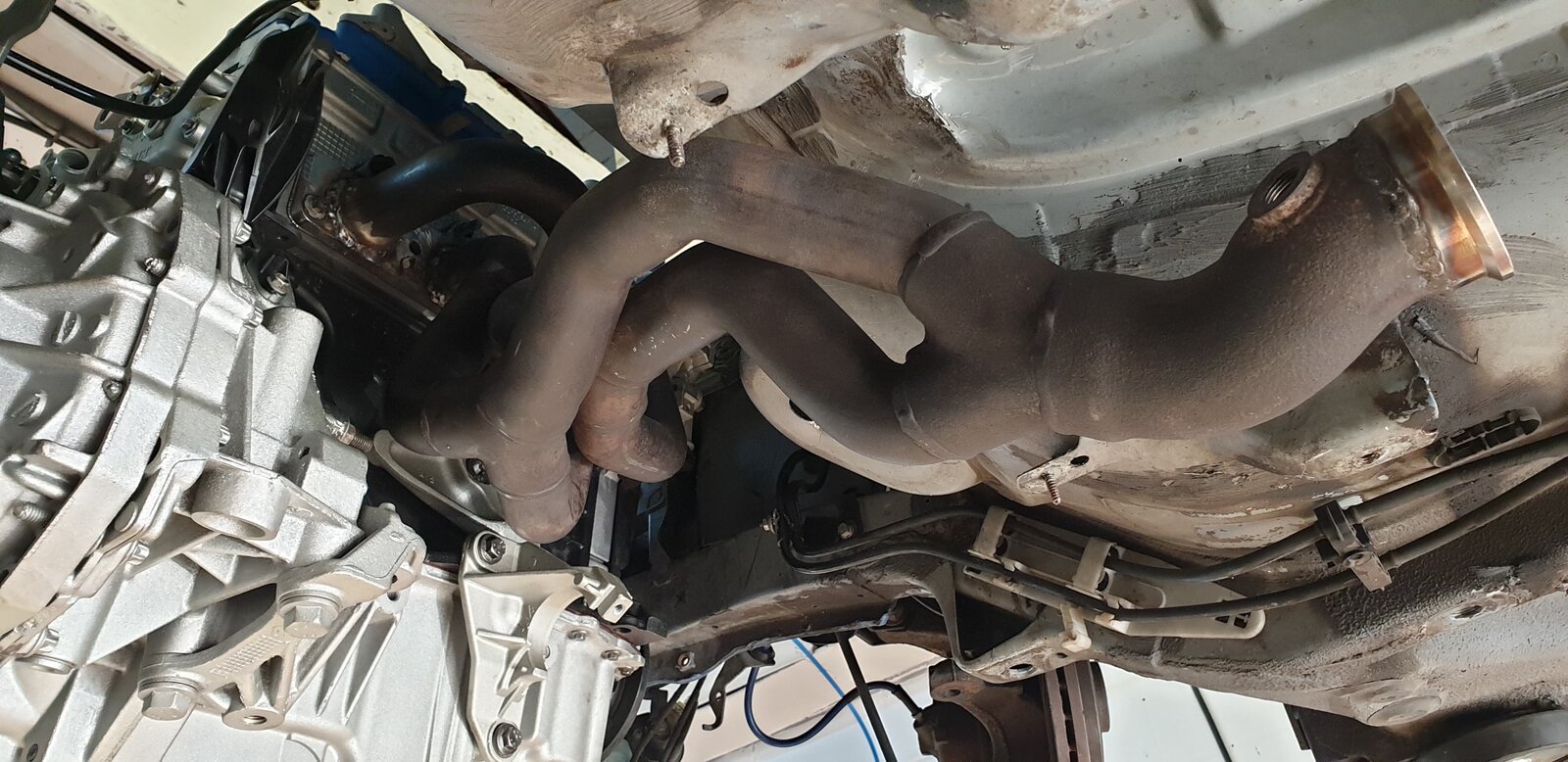

B bloke Car dan's cast offs. Oct 29, 2019 #1 bit of a botch but it fits... (excuse the welding, wasn't me)
Martin_172 ClioSport Club Member Car 182 RaceVan / 197 Nov 5, 2019 #4 just cut and weld on the k4m flange?
B bloke Car dan's cast offs. Nov 5, 2019 #5 ish, need to bend the headers a bit and also cut them back as well. my lad only did it on the end of a build he was doing as a bit of a favour and to see if it could be done easily/practically or not.

Martin_172 ClioSport Club Member Car 182 RaceVan / 197 Nov 5, 2019 #6 brilliant, be interesting to see if it gains much midrange.
Darren61 ClioSport Club Member Car 182 Cup Nov 5, 2019 #7 I thought one of the things that Renault shouted about at the launch of the RS Twingo was the bespoke manifold? As above, will be interesting to see gains with the 182 one on..

B bloke Car dan's cast offs. Nov 5, 2019 #8 won't be able to show any gains from the manifold as it's on a fresh build, forged, high comp, over sized valves,headwork etc.
