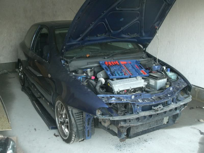

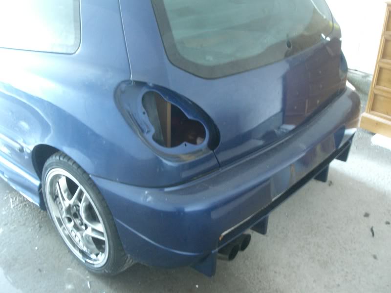

when i got the car:

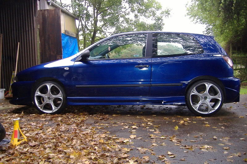

looks ok from a distance.

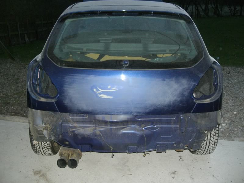

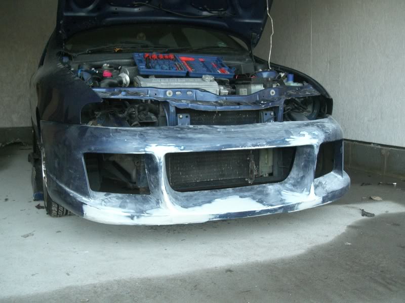

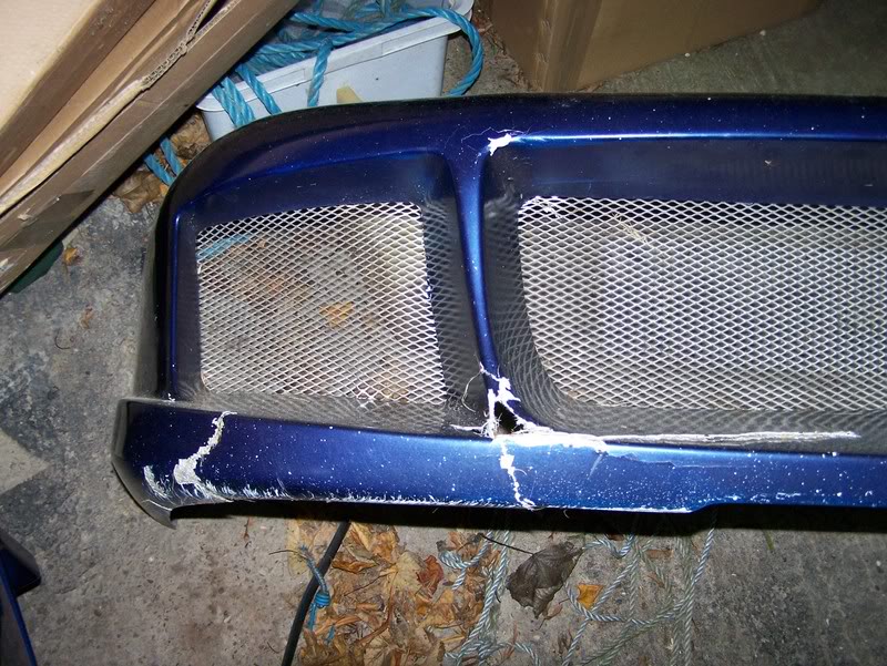

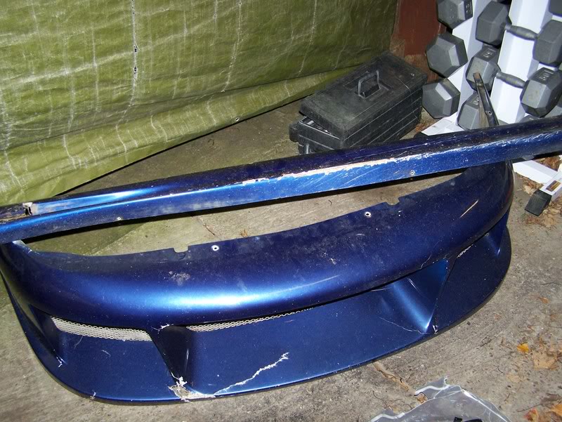

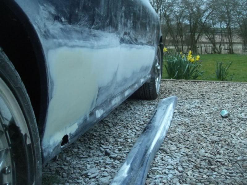

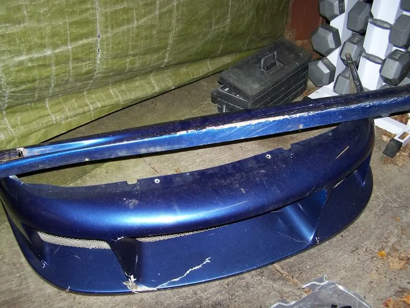

front bumper was mullered, and drivers sideskirt had been twisted and ripped off, a big dent in the drivers rear quarter pannel, rear bumper had a crack in it, big scratches down the passanger rear quarter and sideskirt, millions of stone chips and boot had a wierd line in it.
The Repairs

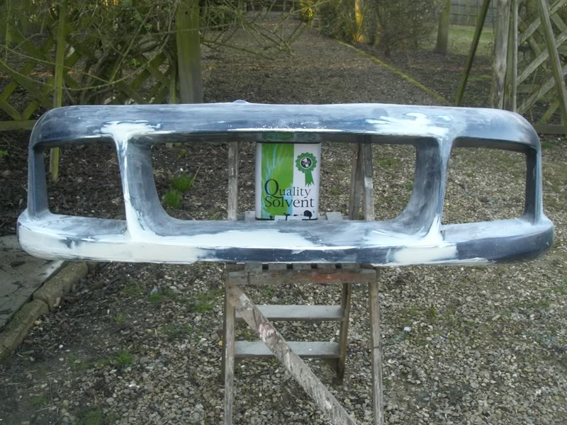

yup, that is Quality Solvent ;)

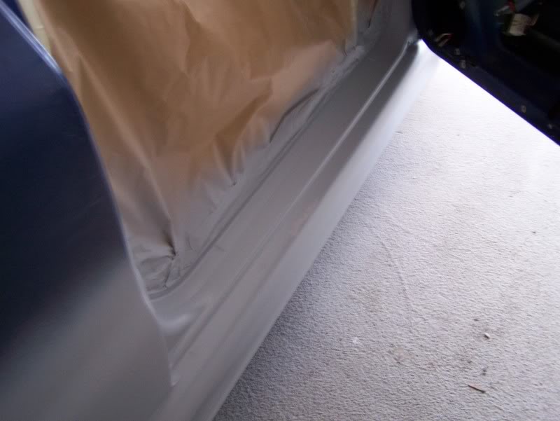

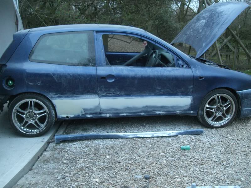

I then smoothed out the rub strips and pulled out the dent. Sideskirts were then reinforced and repaired.

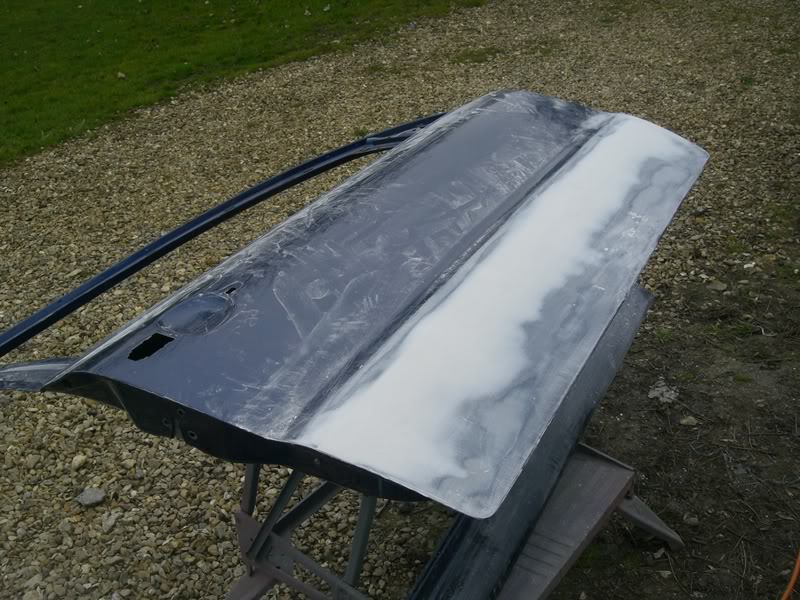

the boot had already been smoothed.... but not very well as there was some weired raised area in the filler. so i resmoothed that.
No pics of me welding the plates in but the handles were smoothed over, solenoids were already fitted. doors primed

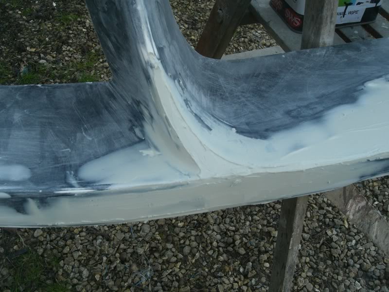

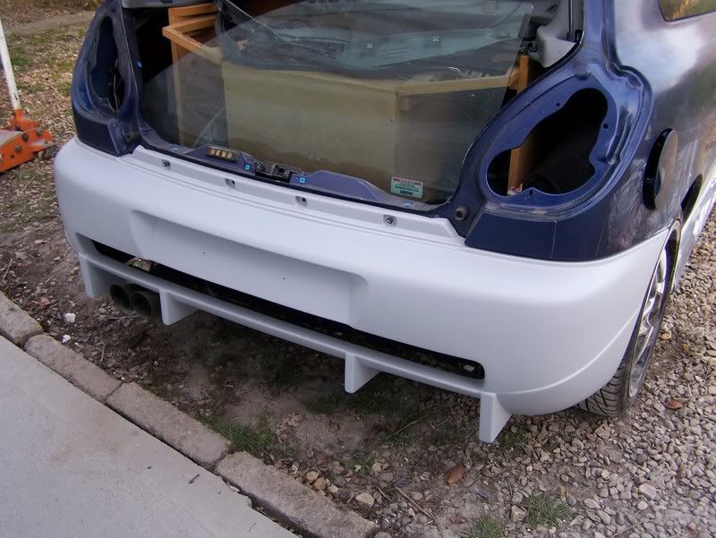

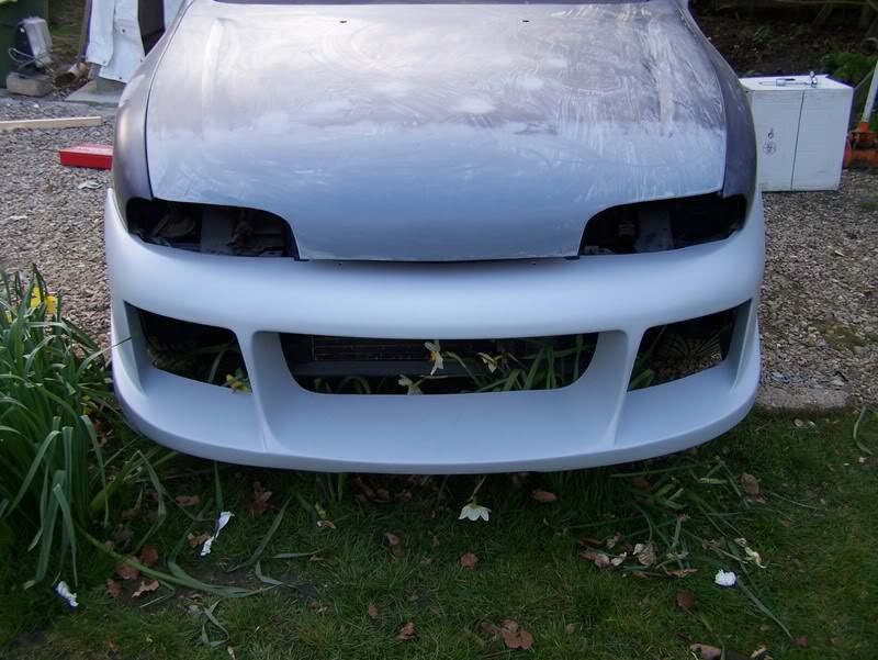

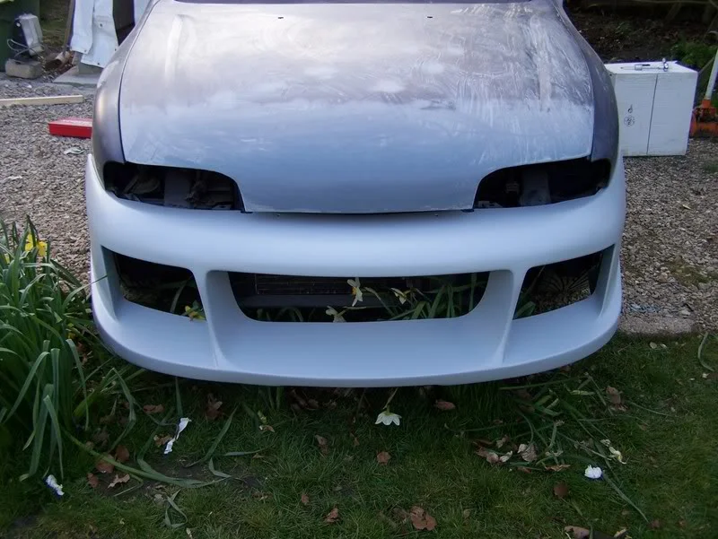

Bumpers Primed and foam filled for extra rigidity and to reduce flex and stress marks showing through. looking like new

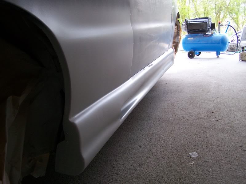

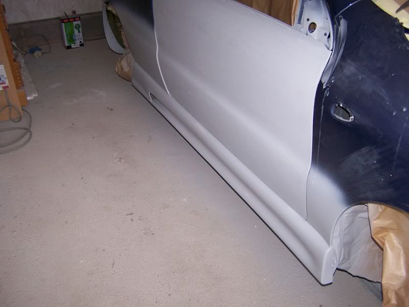

A late decision to smooth the sideskirts in, Im particulay proud of these as they are so solid, bonded and screwed to the sill along the length... and 5 brackets on either side for good measure, smoothed in and looking fly.
Bonnet and wings were riddled with stone chips so they were all filled or flatted out, alot of time has been spent on the small details, the parts that i believe make a car and paint job. loads of little details ive forgoten to mention like new mounting brackets for the front bumper and every scratch and dint removed etc

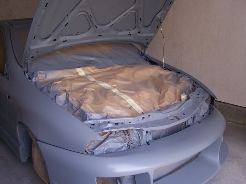

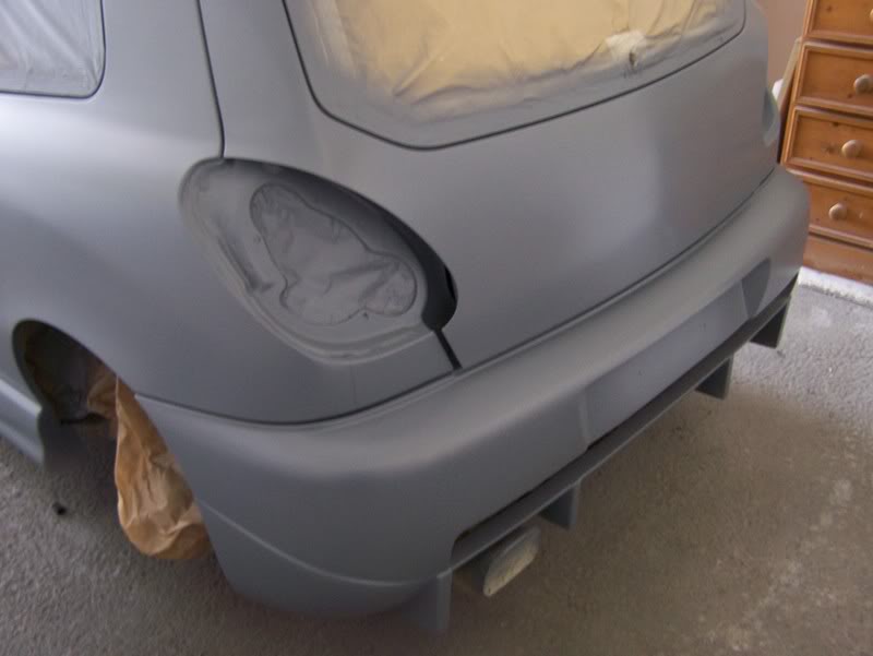

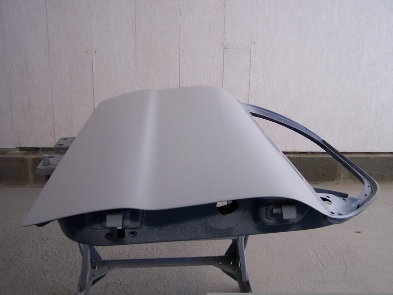

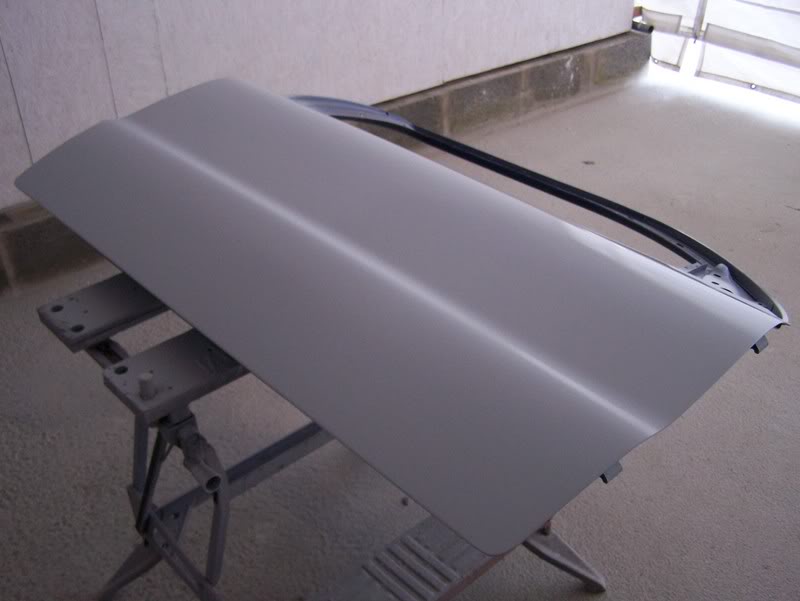

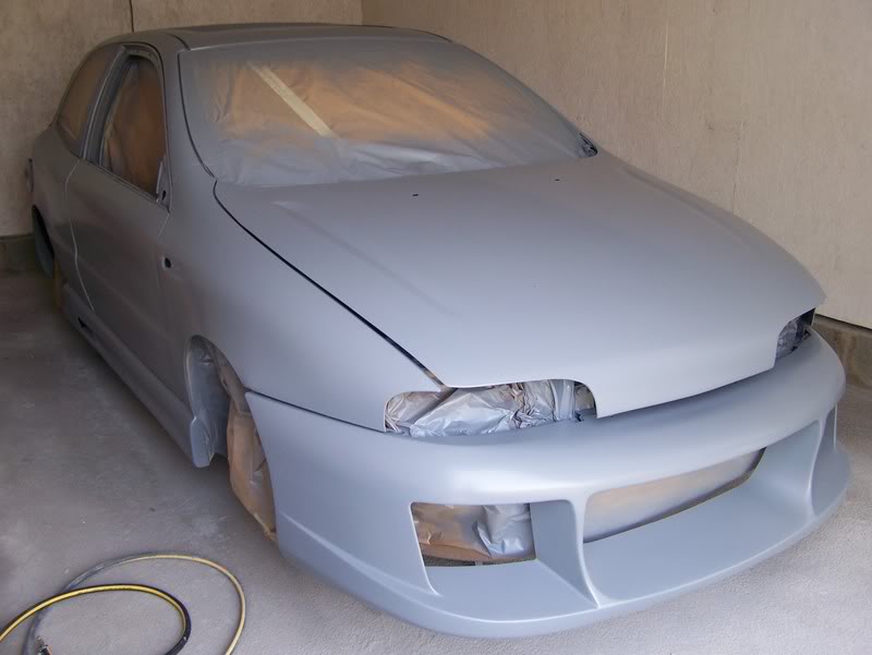

well here it is, Battle ship grey....
doubt it, no this is the base coat for the colour(s) that will be applyed over the top. Boot doors and bonnet were removed and inside the door jams and inside the boot and bonnet were done first, then parts went back on the car, doors boot and bonnet closed, i then went over the whole car with 3 coats of grey base coat ( i know ut looks like primer but its not) just shy of 3 litres to be exact. top coat and laquer will be applyed tomorrow after a clean and wipe down. it got a bit late in the day to start spraying again.
bumpers arnt fastened on properly btw

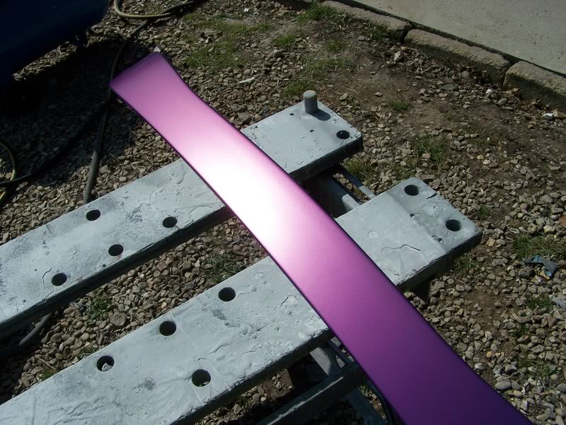

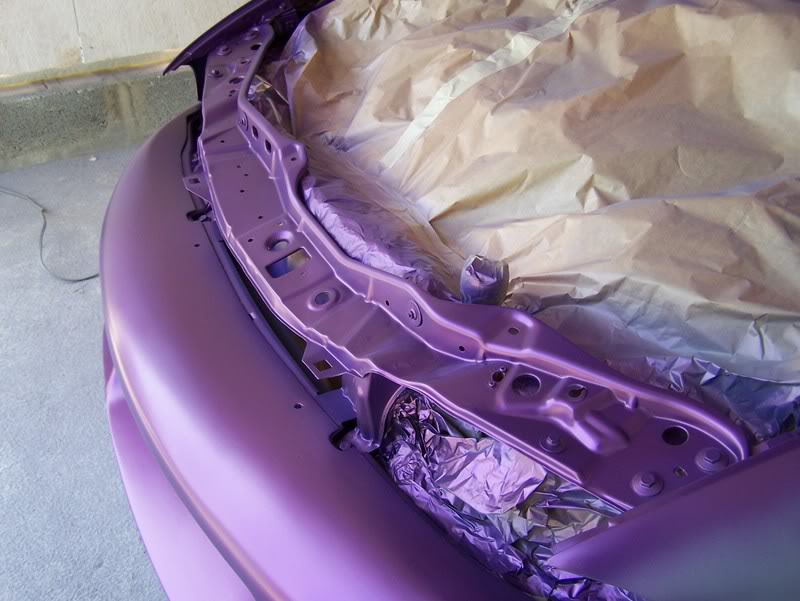

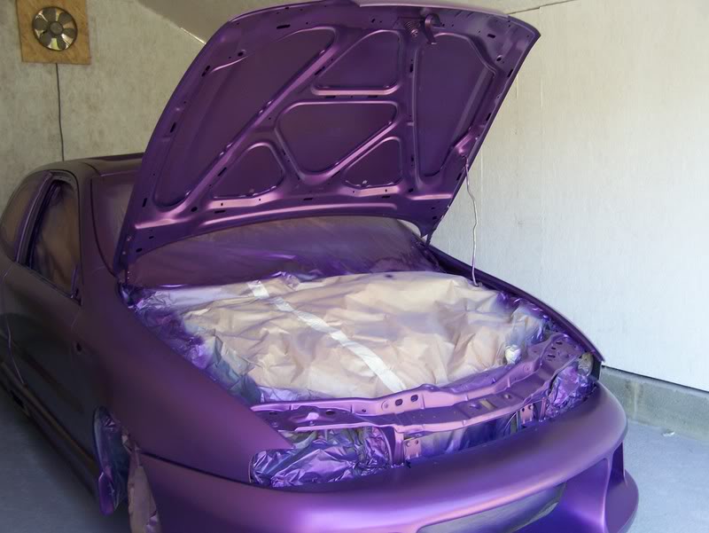

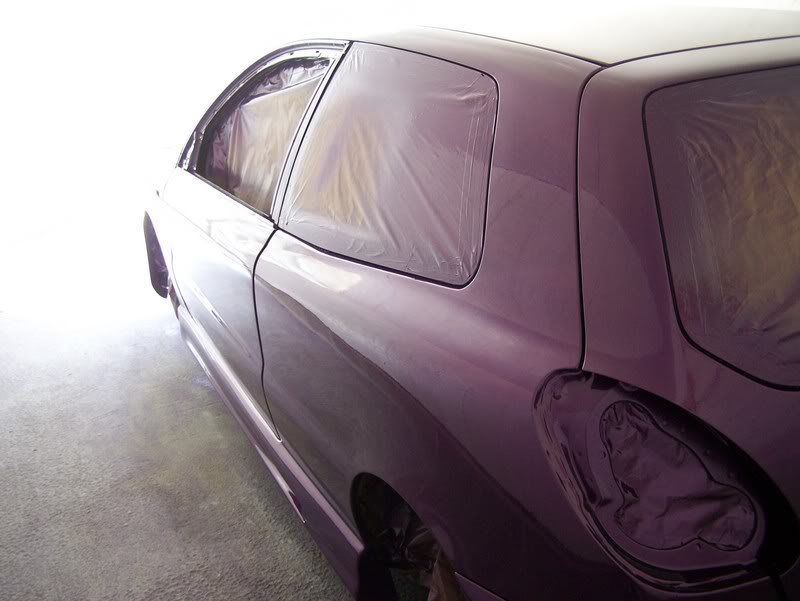

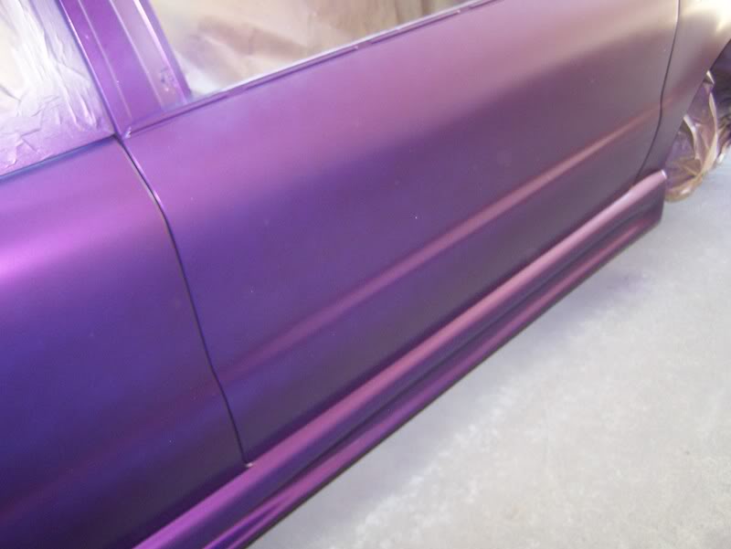

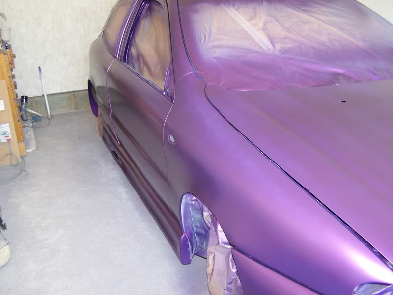

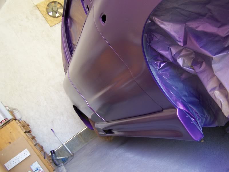

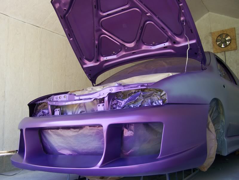

heres the colour, its not laqured yet. I also ran out of paint, no a massive problem but mean i wont finish it till tomorrow. still got to spray the passanger side, boot and rear bumper, and go over the drivers side once more as its a little patchy same with the bonnet. anyway. the colour is called Twilight Royal (3Y), its a pearlesent purple, its alot deeper than in the pics.
blobs on the pics are from the lense btw.

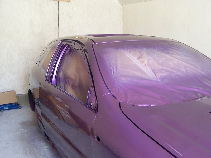

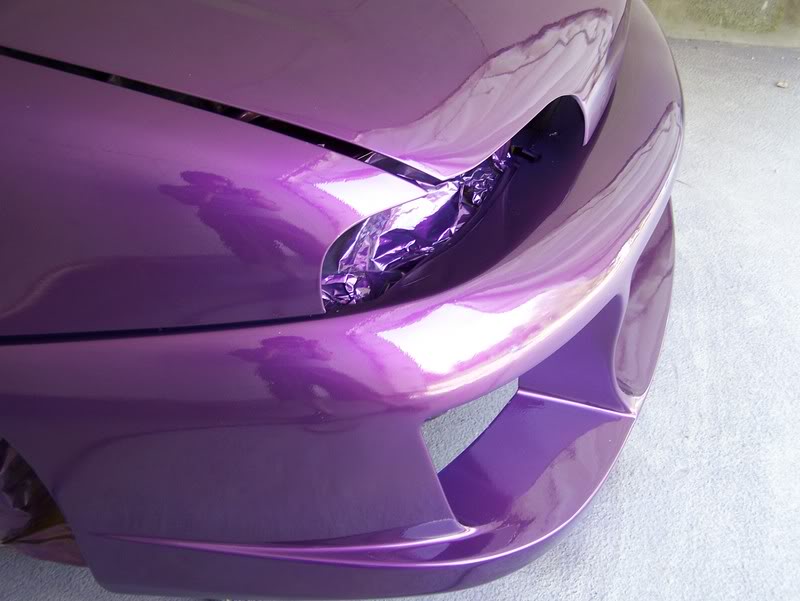

laquer on. got quite a few bits of s**t in the paint which pissed me off, and one run, which is pretty good considering i thinned the laquer down a bit. most of the dust will flat out but some of it is under a few coats of laquer, went round the whole car about 5 times, used 8 litres, so got enough thickness to play with after :)
im not that happy with the finish tbh, alot more crap in it than antisipated, i can get rid of most but i could have done better. but, not bad considering.

I was wondering what kind of finish you would get painting in that garage.
With all that clear on there you should plenty to play with for a flat and polish though.
