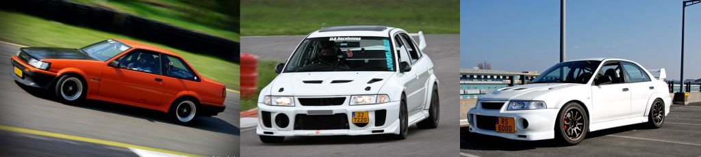

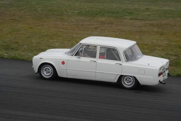

so I'm really having a hard time decidining what car to get as next trackday car. A bit of history on myself. I tracked quite some different cars for the last 10 years or so. 1st Track car, a Toyota AE86, than switched to an Evo 5, then an Evo 6 RS. After 4 years of Evo ownership I decided they are fcking fast but also boring do drive. So I went and bought a 1970 Alfa Romeo for Trackdays wich I abused the last 2 years on track. But I now feel the urge to change again. Got some different cars in my head, and a Clio (182 or 197) is quite on top of the list.

Most importantly pics are required of the Toyota, Alfa and 240Z. 'tis the law.
And how do you know about my 240Z? Where did I mention that?
they are on my "say hello thread" but here you go:
Oh, yeah. That's where I saw it.

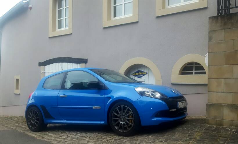

Just wanted to share the outcome of this story. I ended up buying neither of both. I ended up buying a 200 (lol) in racing blue with rebuilt gearbox and some other minor things from germany.
Next step, getting it registered in my country.
