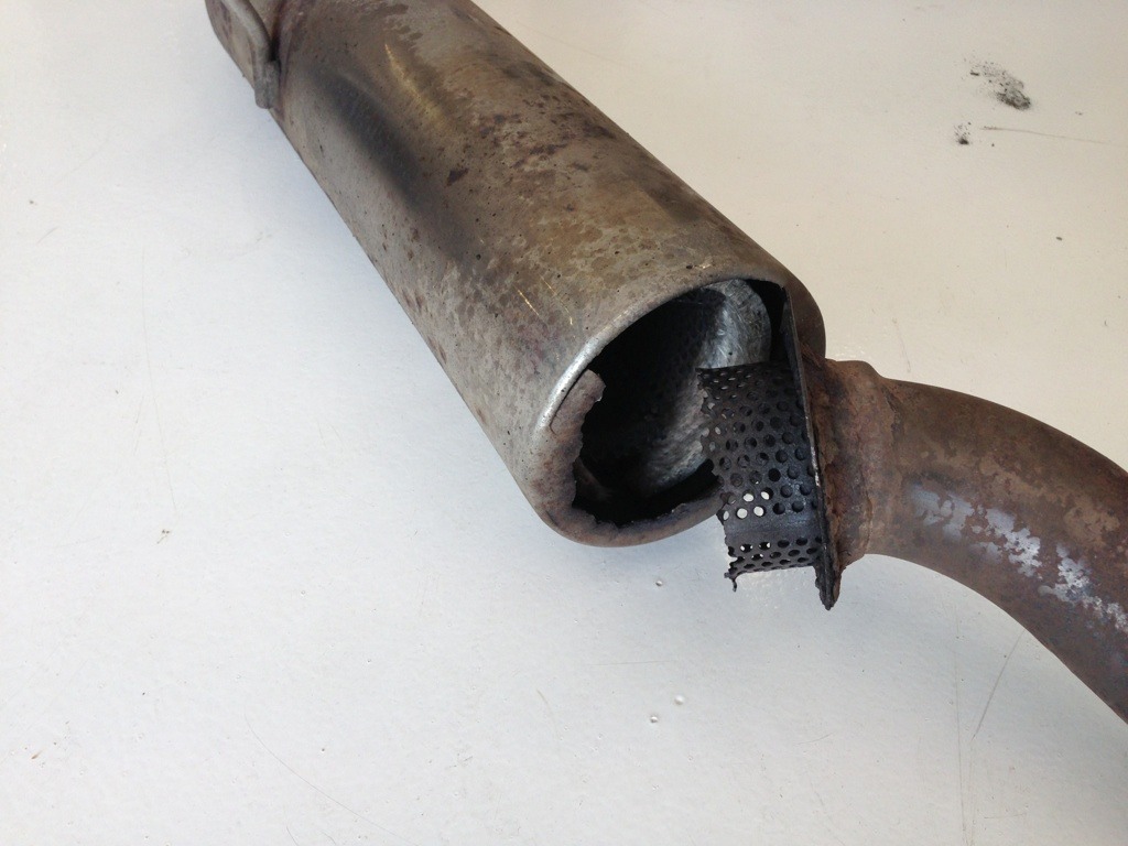

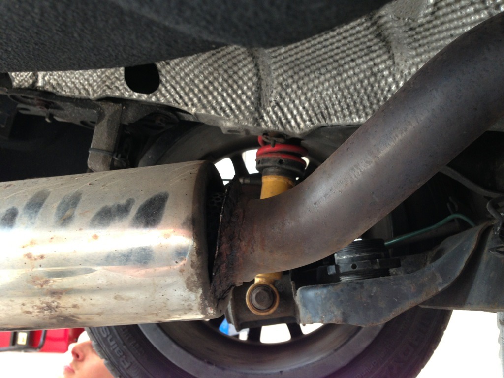

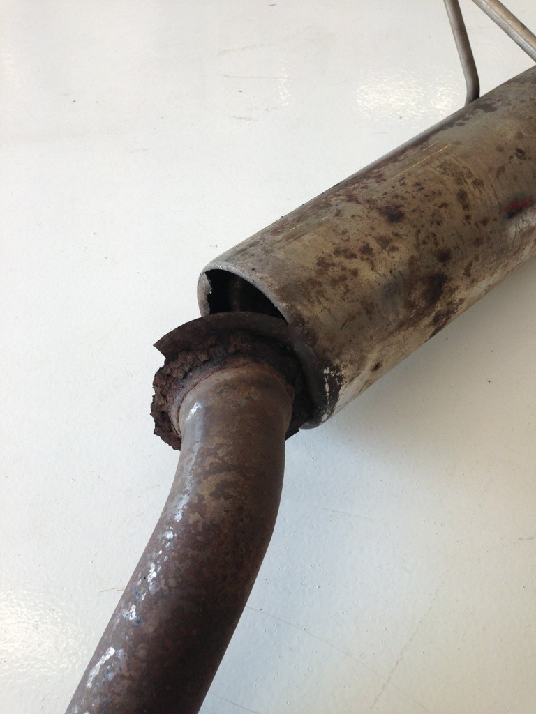

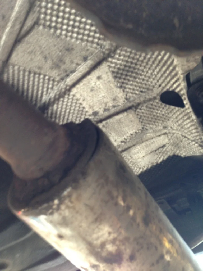

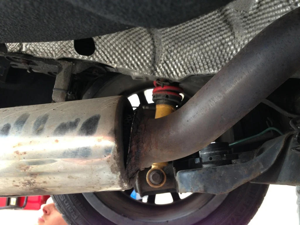

My advice? Don't buy one. No warranty on it because the tailpipe had two inches cut off the end, which has obviously caused this to just fall to pieces.

Also it looks like a stress crack where it has failed rather than the obvious surface rust on the welds which IMO has been caused by running no centre exhaust hanger (I know I don't due to the way they sit)

Was it mounted funny causing it to be under stress? had you removed the flexi or done the cat flange up solid without the springs? ... solid engine mounts?
Naturally sat, the exhaust shouldnt be under enough stress to pull itself apart.

Looks like its been scraped on the ground?
Also did it have the centre hanger as its got loads of extra stress on the end of the silencer without one.

It's had 2 inches taken off the tip hardly compromised the rest of the exhaust. And it had a centre mount when I sold it.

Either it's dropped and been hit at some point or it's been bouncing around on knackered rubbers - but somethings caused that to split
No offense - I realise chopping the tip off wouldn't cause that - BUT from orecas point of view maybe someone put it in a vice and cut the end off with an air saw - and the vibrations/stress cracked the box... So oreca won't be willing to take it back. K-Tec didn't even sell it to you, it's 2nd hand. etc....

You know seriously I don't want to start calling people liars - but i'll get pics of mine when I get home. There's NO WAY that's 18 months old. The rust on it is insane!
