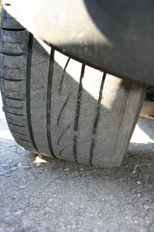

Ouch new tyre time :(
  AMV8, Mk1 Golf
suppose 7k isnt tooooo bad out of a set of rear tyres

If you didn't insist on having your tyres at angles which can't be good for the car either, it'd probably have lasted three times as long. ;)

I wouldn't say they've lasted 7,000 miles.
Look like they lasted 5,000 miles and then spent 2000 miles going through to the canvas!
Can you not get the camber sorted out???

You won't be thinking that when your tyre blows out at 80mph and rips half the rear bumper off with it.
Theres canvas showing ffs!
Don't get me wrong, it looks good lowered and with camber, but I fail to see the logic behind people running cars with completely fcuked tyres. Asking for trouble.
It doesnt seem like its running that much camber anyway.
Id get tracking etc checked, thats not healthy.
And if its cheaper replacing them, replace them before they get that bald FFS!!!

yeah gotta say had no idea it was that bad, pther 3 are fine :S tbh tho i think there is a wheel bearing on its last legs so that probably has something to do with it,
checked them a couple of months ago and they were all fine, new pair on order will be fitted tomorow bit annoying replacing the pair seeing as the other is fine :(

agreed, stupid camber FTL. Mine were wearing like that and I took it to the pros (WheelsInMotion) and paid 1k for full geometry, 2 camber bolts and a full set of Conti Sport 3s.
I'm keeping an close eye on mine now and they are wearing really evenly now. Spot on in fact.

Id definitly get that amber sorted, the outside of the tyre looks new.

well just been n checked n the bearing is fine,
oh well on the rams it goes, in for a service anyway this month so will get a few bits sorted at the same time :D

That's not good, my 182 shredded a set of Yokohama S306's in 3k because the tracking was that far out when I bought it! Put some PE2's on it with and got the tracking done, 7k later they're not even that worn!

Strange you didn't notice that. I can tell when my tyres start to get low with the way it drives and grips. Bizzare.

i bet your toe is out on the rear... looking at the rubber that wouldnt just be down to camber, i have ran 10-15k on 18's 9.5" wide on nearly 2 degrees neg camber on the front (thats alot lol) however running with toe out it will chew rubber easy!
