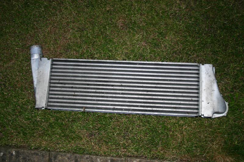

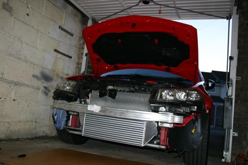

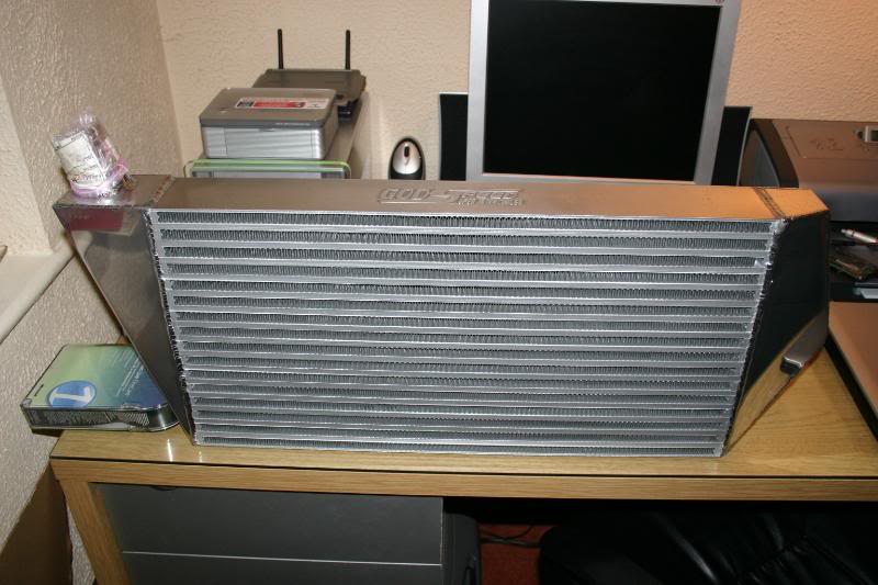

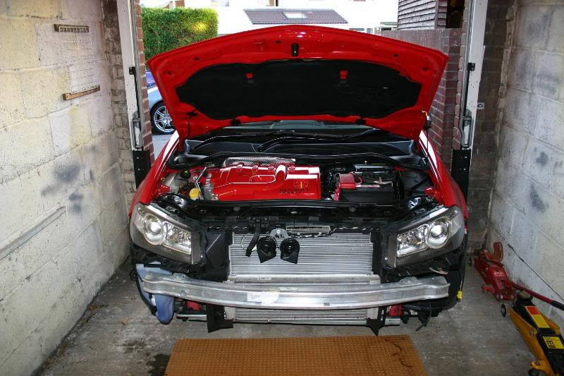

and in with the new Intercooler, Came yesterday couldnt wait to fit it, Its been hand made for me the core is from God Speed any comments welcome!

From Christos mate?
Looks Tidy! You noticed and diffrence?
Yea from Christos his Dad has done a mint job looks amazing! Well havent noticed anything yet as in better performance as I never got it all back together until 10pm and the outside temp is only 15oC but if its hot tomorrow I can give it a real test!:D I have noticed alot more induction noise and the DV is louder!

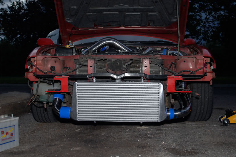

intercooler does look very nice though :D tbh the first pic i thought it was an evo lol!!! yeh gimme a shout :)
