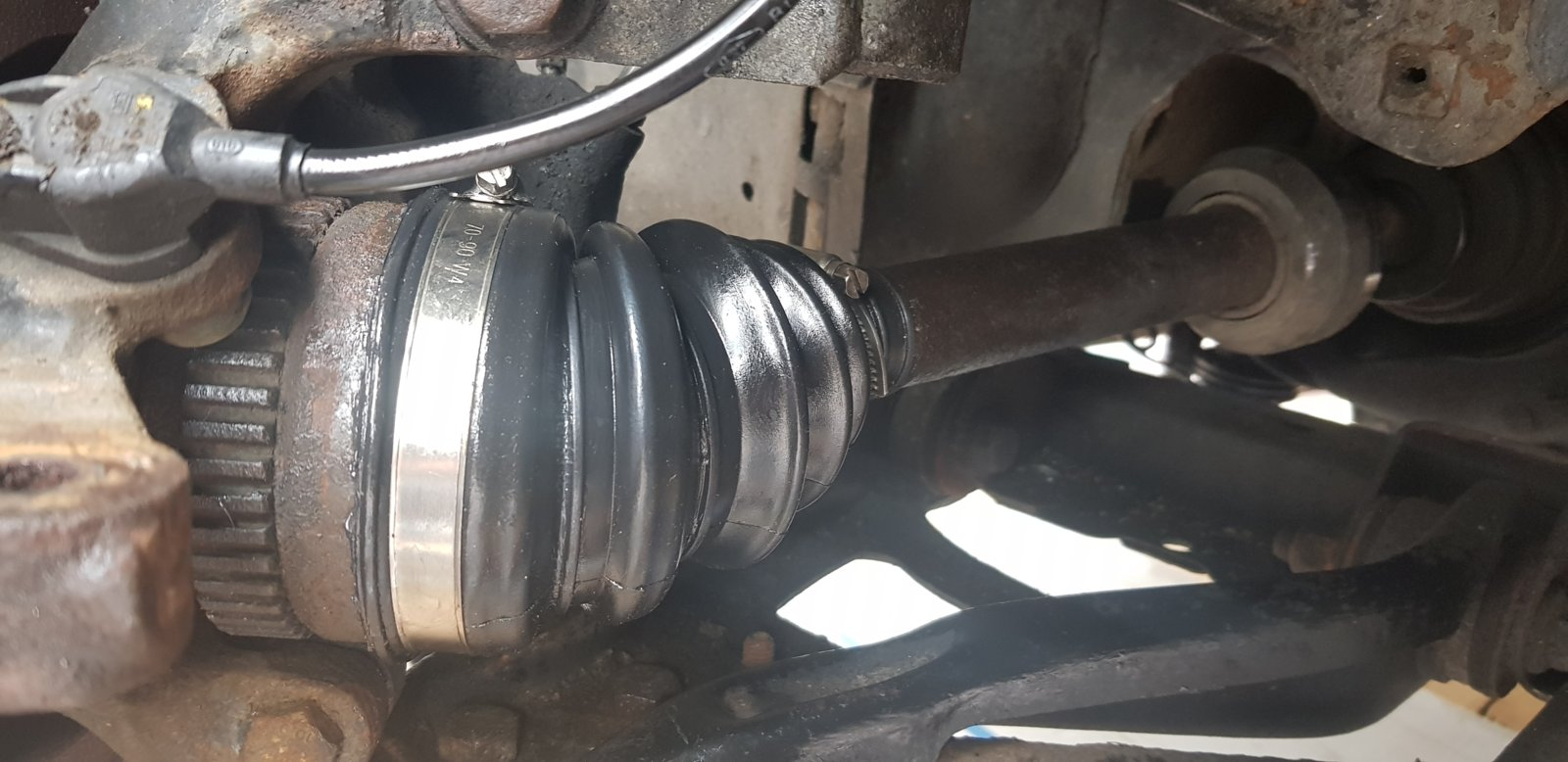

One of these bad boys? https://www.jandrcvjoints.co.uk/ren...003/product/bootkits-511/cv-boot-kit/JRBKUV03JR flexi boot. Cut off one of the ribs so it doesn't rub on itself and they're grand.
That's the one, you'll want to get a cone too for fitting. You cut off a rib on the large side, maybe even take 2 off? I can't remember.One of these bad boys? https://www.jandrcvjoints.co.uk/ren...003/product/bootkits-511/cv-boot-kit/JRBKUV03
Cut the rib off the smaller side? Apologies for stupid questions, never had to fit a boot before![]()
One rib, i used jubilee clips to replace the cv clips too. Never had an issue.That's the one, you'll want to get a cone too for fitting. You cut off a rib on the large side, maybe even take 2 off? I can't remember.
Obviously wouldn’t make it so it fits from factory, typical. Thanks for your help mate, much appreciated!One rib, i used jubilee clips to replace the cv clips too. Never had an issue.
They do fit, they just rub on themselves and fail prematurely.Obviously wouldn’t make it so it fits from factory, typical. Thanks for your help mate, much appreciated!
