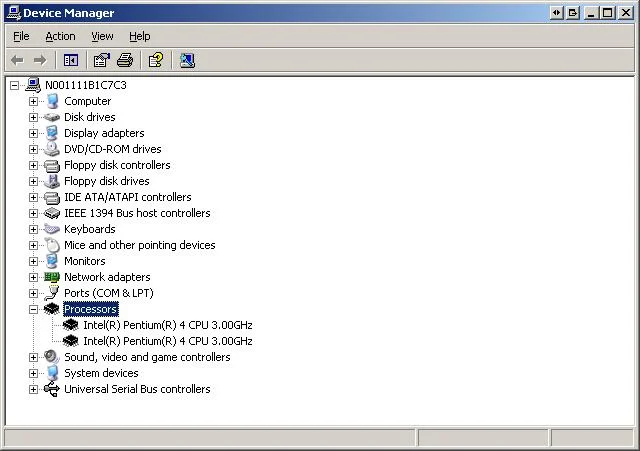

On intel CPU's when hyper threading is enabled in device manager multiple processors show up. e.g if you have 1 hyper threaded processor there will be 2 cpus in device manager. Is this what you mean by HT?
Nah, that only means your running a dual core CPU (pentium D possibly), if your looking to overclock you will be looking to change you clock multiplier, FSB and voltage to the CPU amongst other things.

Definatly not running a dual core pentium. It is a 3.0ghz P4 HT. Used to get the same with my old work machine 2*3.2Ghz HT Xeon showed up as 4 processors switch off HT and it showed up as 2.

HT will show 2 CPU's in device manager / task manager. There logical CPU's not physical ones so there not as quick as a real dual core system but do have some benefits in multitasking office apps.
