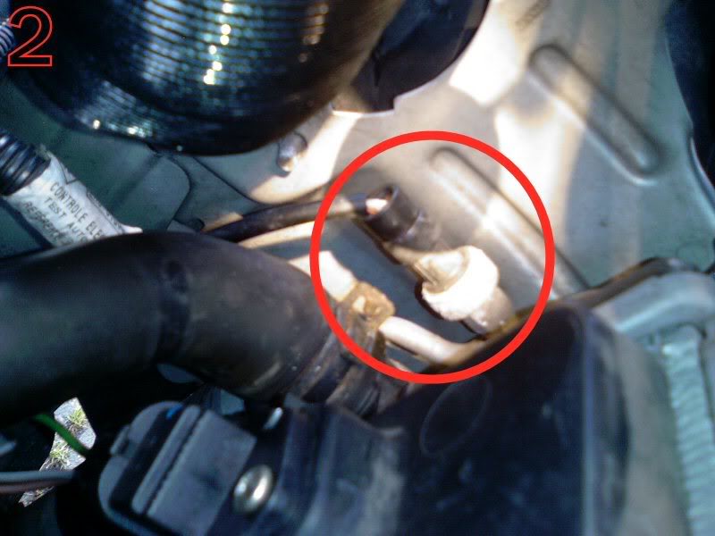

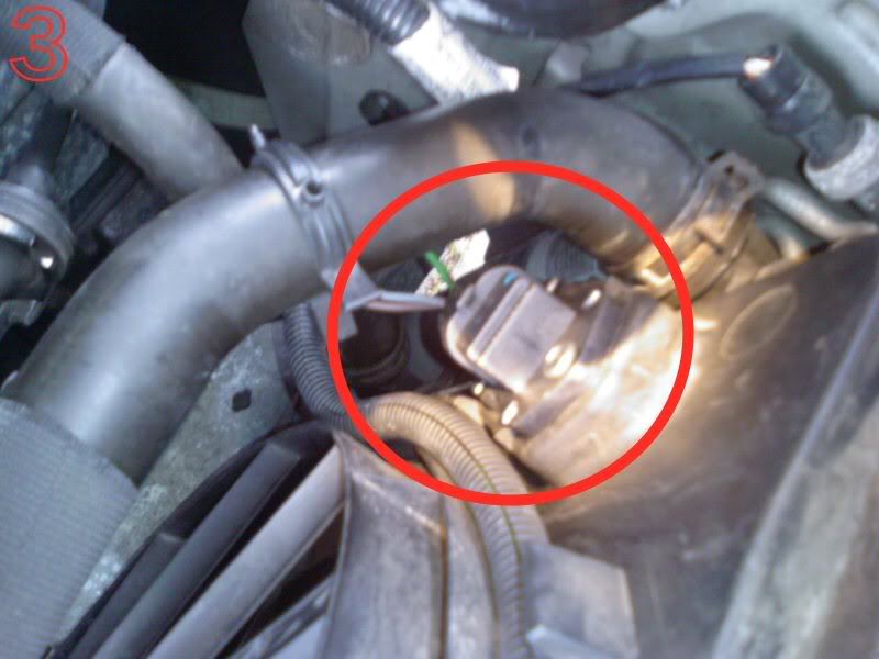

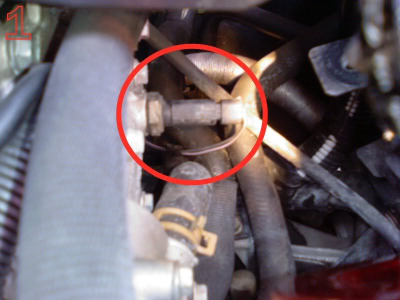

I've taken some pics of the sensors nearest to the rad, maybe someone can tell me what they are, i've just replaced the sensor in pic No.3 last week and it didnt solve my problem.
what are the other two sensors? is No.2 something to do with the air con?

Thats the one, in picture 3 !! Pull it off and short the green wire to the blue wire then the mauve wire. The fan should run (ign on)
If not, as the switch has been changed, you need to look at the resistor.
  Dci 100
just tried that, i could only get it to come on by running a wire from the positive terminal on the battery to the second connector, it wouldnt come on when touching the 1st connector on the socket.
  Carrera 4S. Clio 172. M5
Then your looking at a supply problem if there is no power in the plug.

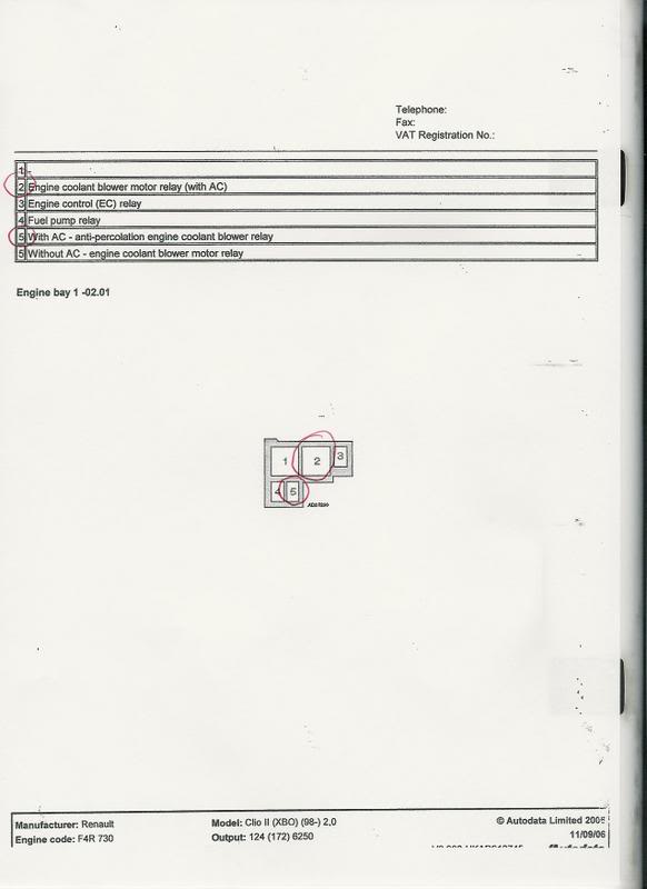

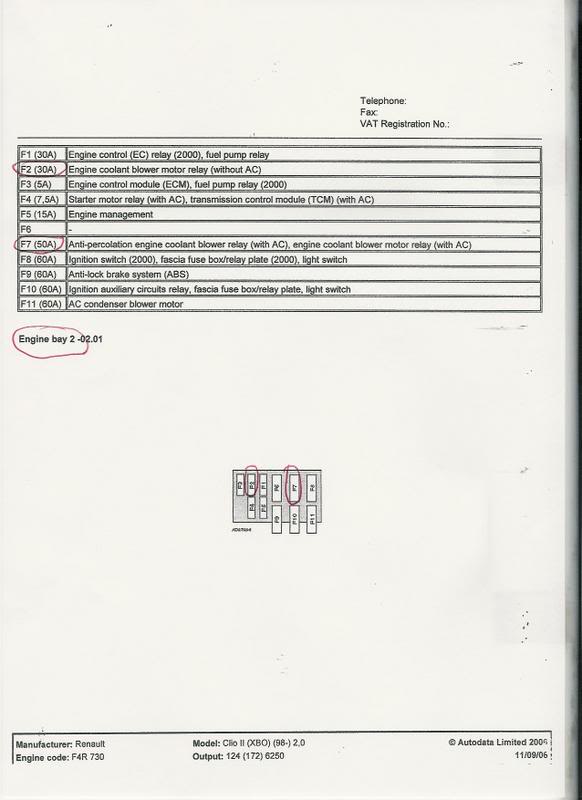

FUSE is my first reaction. I have attached the circuit diagram for you, as you can see the fuses are in the engine compartment E box.
