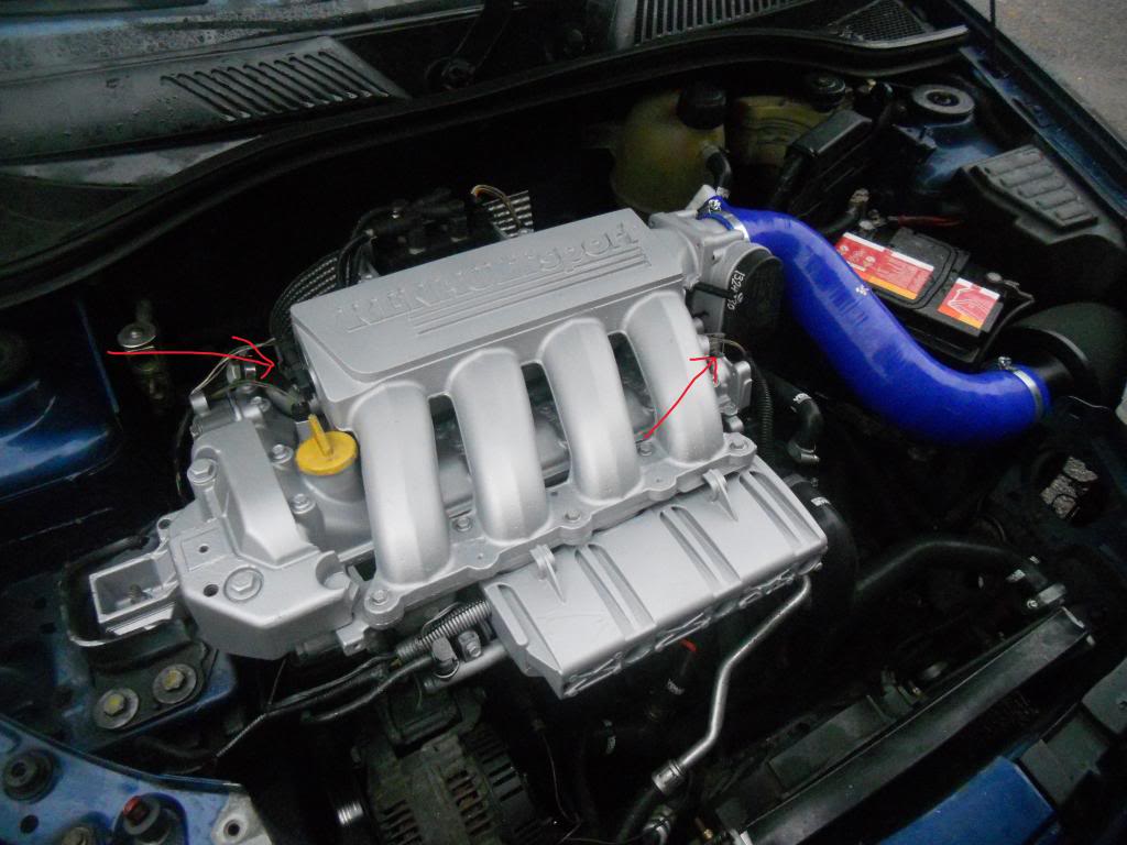

There is an air temp sensor as well as a map sensor. The air temp sensor is to the right hand side of the inlet plenum and is grey in colour. I do have a spare MAP sensor if you want to try it, but if the code is air temp sensor that's what i'd be replacing, isn't MAP sensor for air pressure? Not having one would cause iratic idling i think from when mine failed.
Those two i think.
