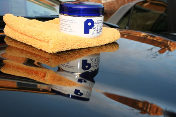

P21 is this the stuff....

We finished mine off with P21. Seems really good. Mine was covered in flies from my three drives to Silverstone at the weekend, then today it chucked it down and they just came straight off.
  Focus ST
Yeah, this is stuff.
I use it on mine, and brings the car up a treat.
Rich on here uses it (or its equivalent), I believe he uses this at the end after using a polish.

P21s will be a good choice on Black Gold, but as Lee said, the main shine is in the prep. Wash, clay, polish etc.
The most important part of the process is the polish to get the paint clean and swirl free, think of the wax as the icing on the cake. The wax alone will not do anything over unpolished paint, infact will show up defects more.
Fred if you are pushed for time at least use a polish like Autoglym Super Resin before the wax.
