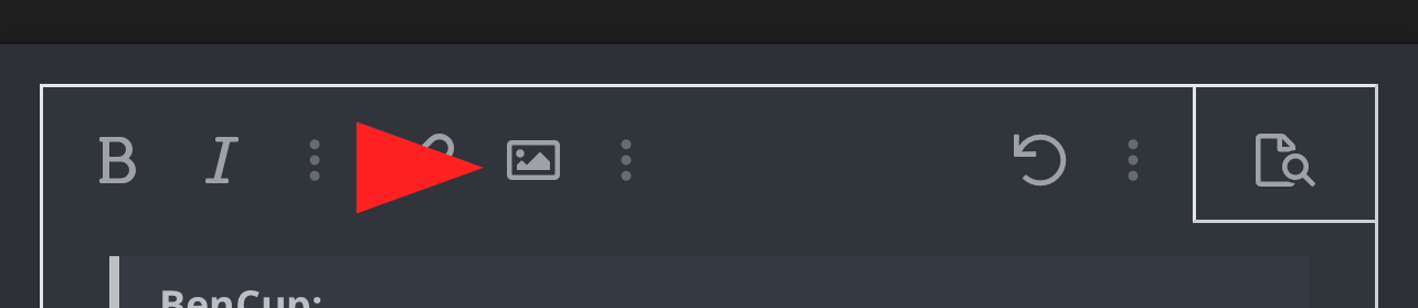

Can you put a shirt clip on here?
Yes, click this button
