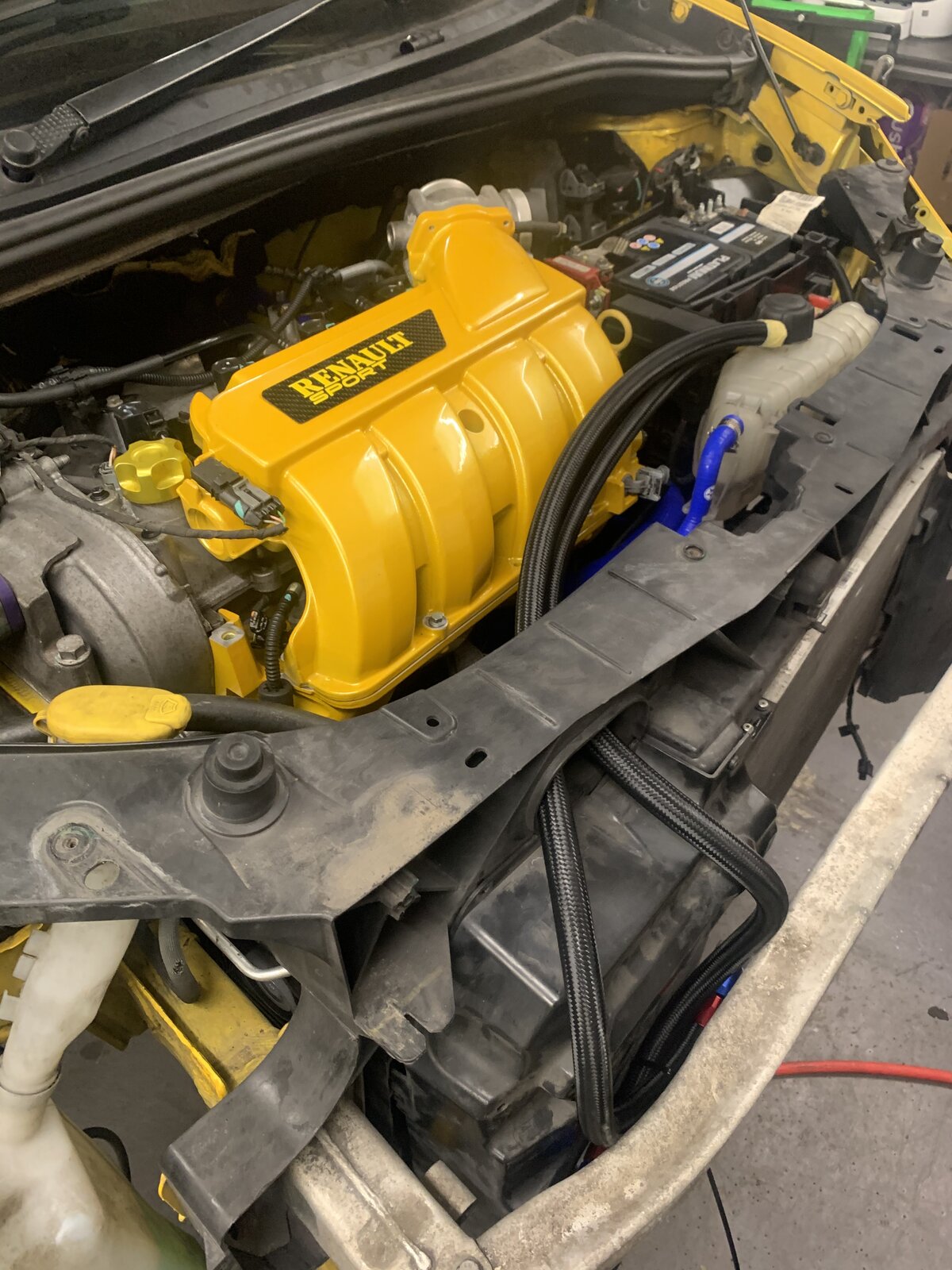

However shortly before I left to come Poland. I finally drove my Clio after 7 long months of waiting. After being mucked around royally by Renparts ( and I am not alone ) I managed to source a replacement engine from a Clio 200 which had only done 50,000 miles.
There was a few other issues and upgrades I wanted to fix and install so we decided to do them at the same time.
The car is now running with the Clio 200 engine, polished inlet manifold, pure motorsport race exhaust and HEL oil cooler mounted in the front bumper, I’ve also replaced the rotors on my 2 piece brakes and put in Ferodo DS.1.11 pads changed some bushes and lower mounts as well as changing the top mounts.
We also had a nightmare towards the end. The car was being test driven it snapped the other coilover spring from my KW V3 set up. So straight onto the phone to KW UK and I got a replacement sent in a couple of days
The car is now running better than ever with the much better Clio engine and that is even before it’s mapped. So I’m looking forward to see what it will run post mapping.
The car now drives and feels like a totally different car with a fresh gearbox also on the car. I’ve spent a small fortune sorting this car out however hopefully this will last another 90,000 miles of fun.
