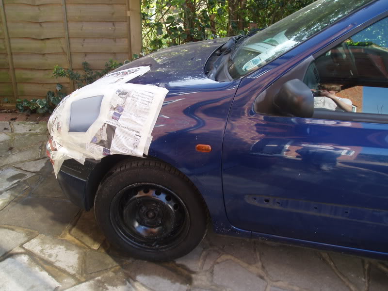

Easiest way to describe it would be just overspray by a little each time, allowing some of the new paint to go onto the old body work, and thinning it out slowly as it get further away from the area you have painted/touched up, creating a soft edge, and making a subtle transition from old to new.

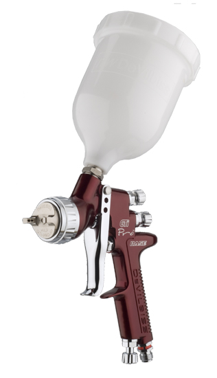

I know gally has suggested a spray gun which is all good but if i got one wouldnt i need a compressor too? How much would this all set me back??

to fix the wing id say unless your a competant painted just to flatten the whole panel down, spray up with colout and laquer up and buff it afterwards....thats if ive gotten the jist of what your trying to do
Rob
The wing was just an example picture of someone elses car i got off here, i was working on a friend fiesta, lots more to do, but the bumper was finished last night and went really well, given me a lot of confidence to carry on perfecting my technique, soon i'll have a go on my car!!!

you will perfect it with rattle cans, and then when you go for a gun it will be starting allll over again lol. At least you will have more of an idea mind :D
