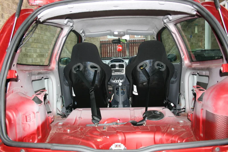

My car currently looks this,
I want to paint/get painted from behind the front doors through to the boot (still have roof liner)

I was thinking about doing it like this (Pinched from Bomber) And getting some black carpet from another clio to go in.
Also planned on blocking off from behind the bucket seats with a big sheet lol.
  MK3 GTI golf 16v
thats looks pretty good tbh, id go for that. if you have time to spare then do it yourself to save some $$
Im going to try paint it myself, if it turns out bad ill get it done professionally.
For the record to get what bomber did to the silver clio above costs roughly £300 in a body shop!
