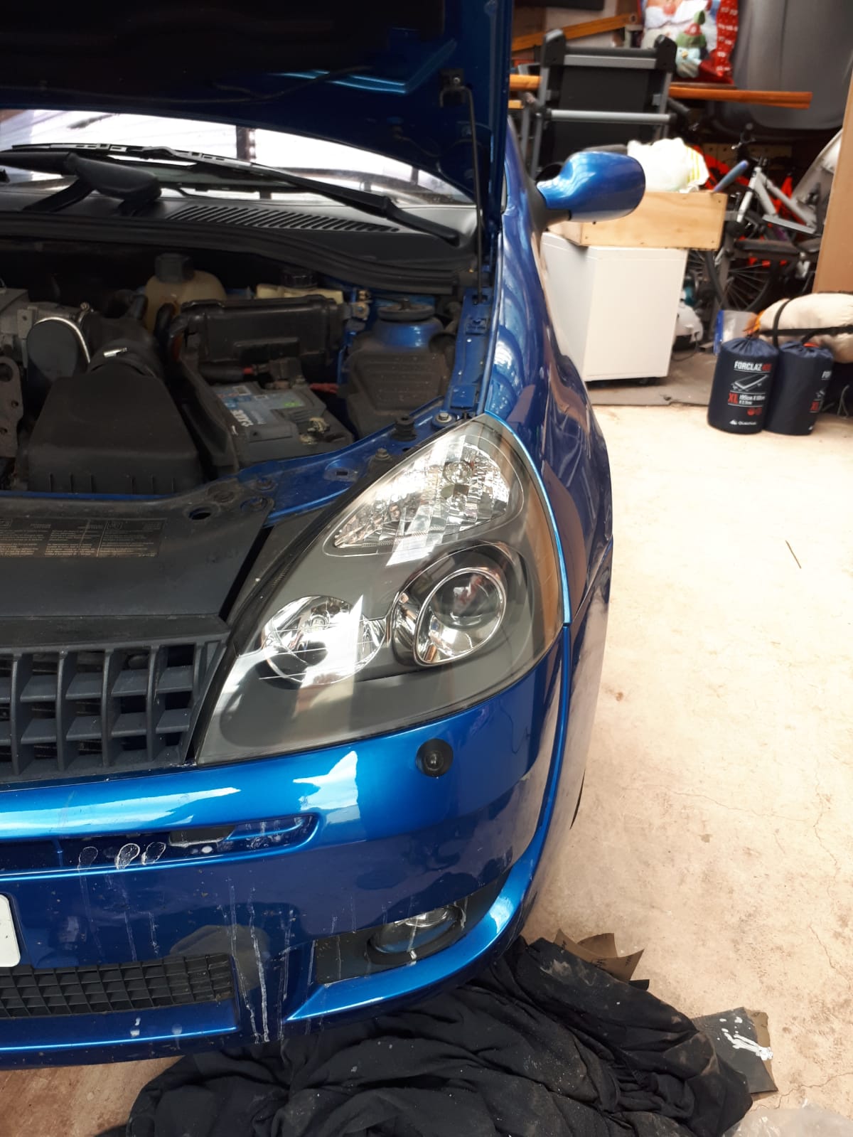

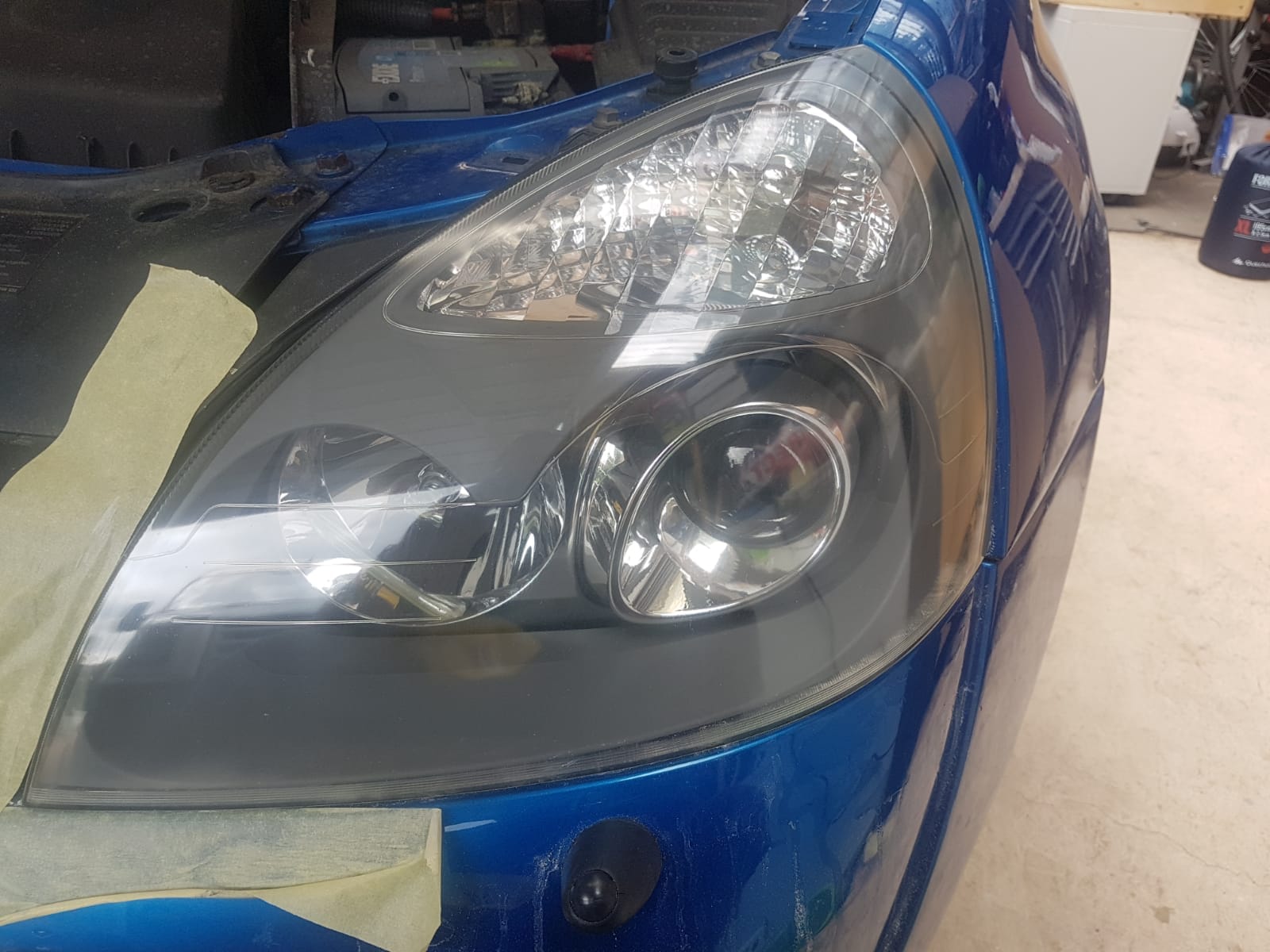

Well time for an update. Car is currently at the body shop to have a new bonnet and bumper fitted and painted. Whilst it's there I thought I'd take the opportunity to order some new number plates a 3/4 front as well as a new splitter.
It also clocked over to a 100 000 miles so will be ordering a full service kit as well as timing kit so will have that to keep me busy.
Photos once it's back and pretty

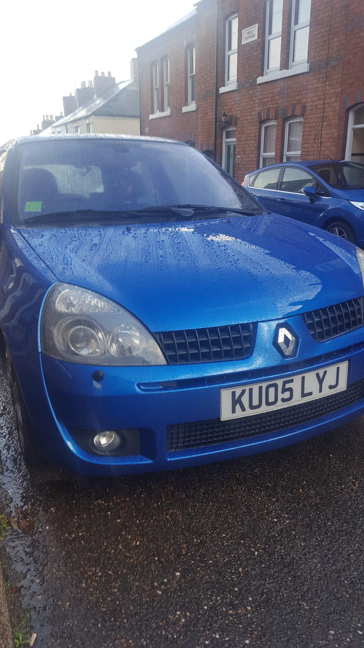

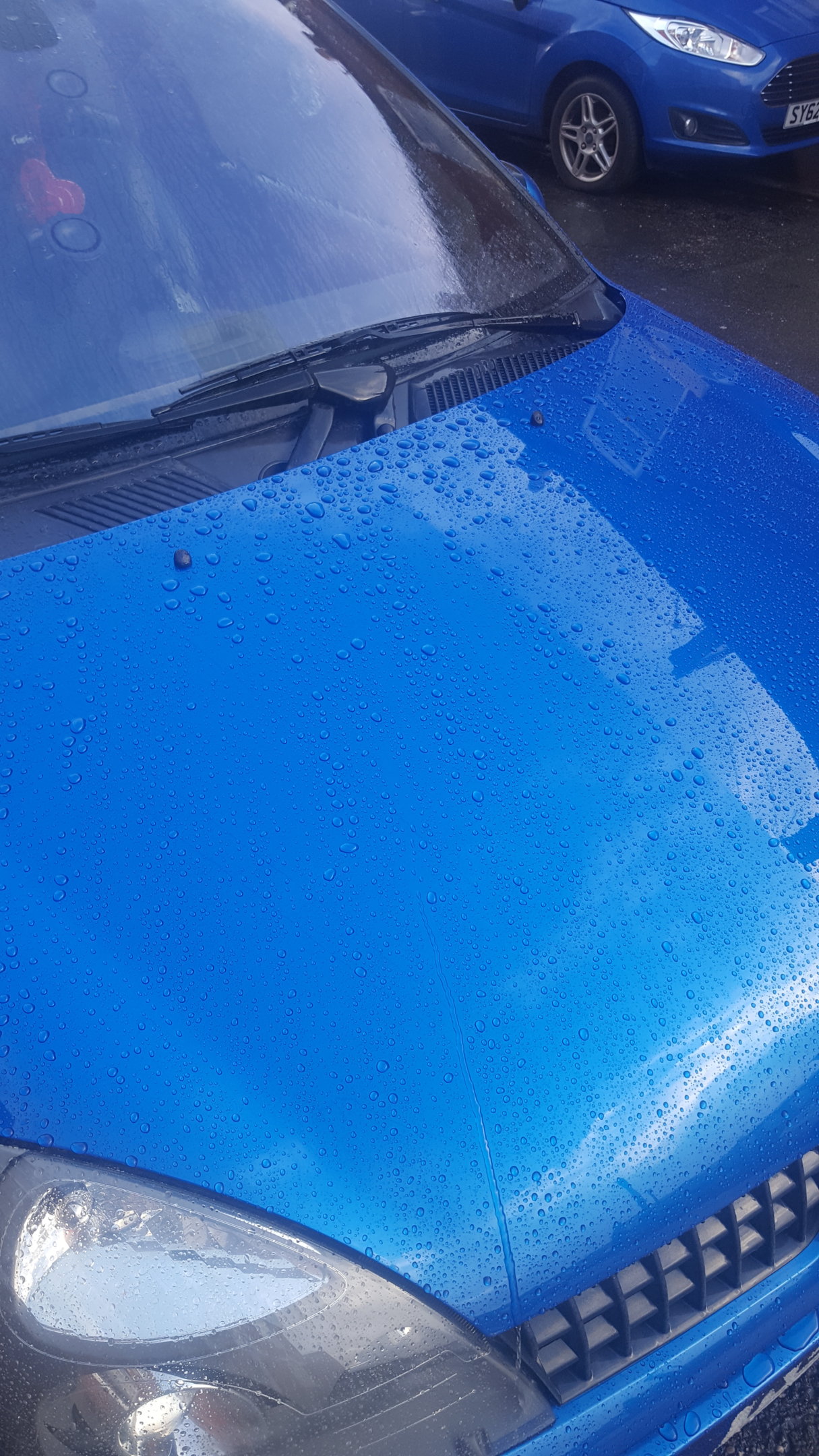

Shame about the weather as it's means the car is filthy and I can't wash it for a few days yet but........
Gonna leave it for a few days then swap the plates over/fit the splitter then give it a proper detail. Really happy with the work carried out.

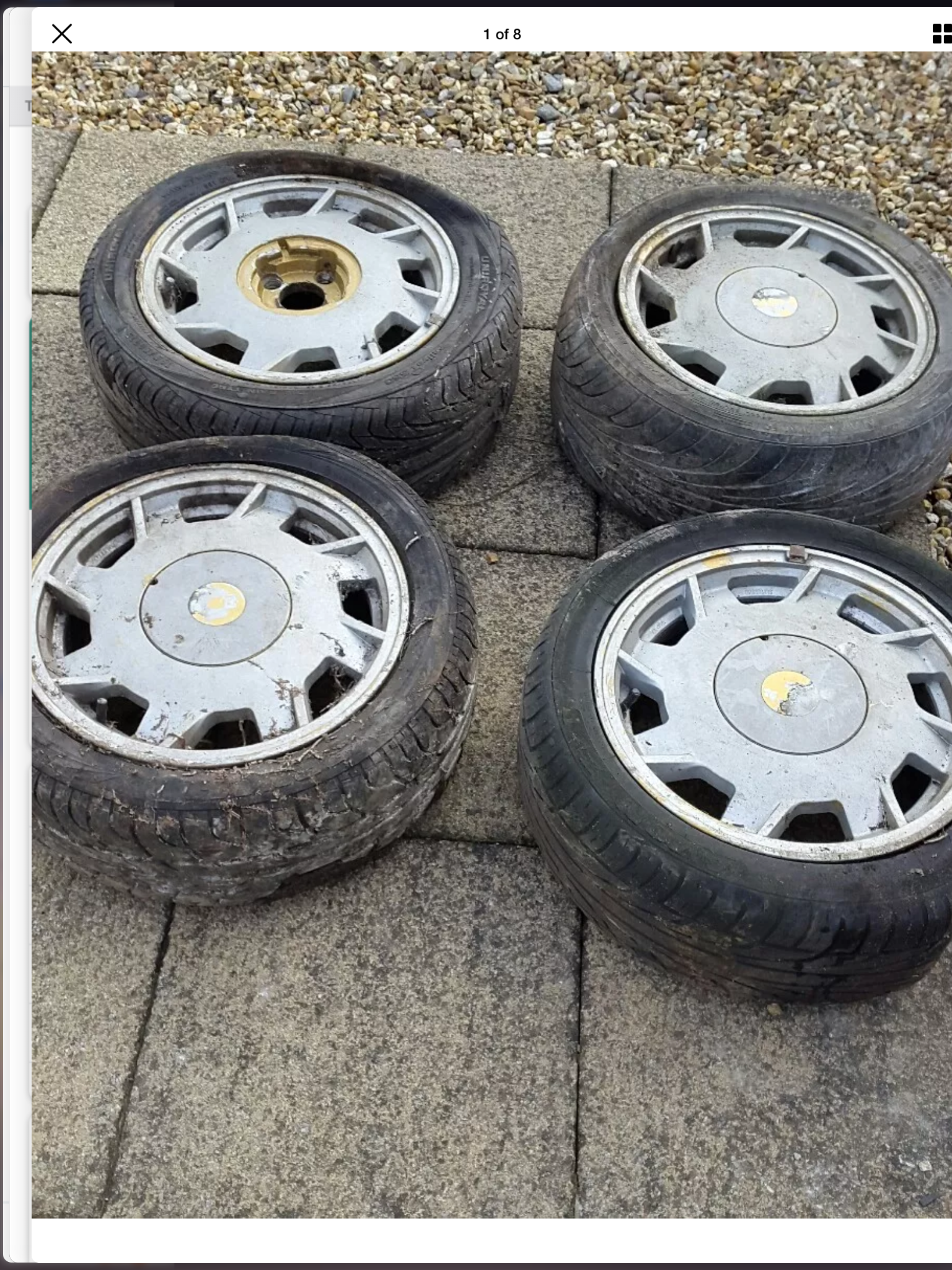

As I've been given some vouchers towards a track day, and Donnington is only round the corner, thought I'd buy some cheap wheels to put on as track wheels. Gonna referb the above and then fit with some r888 when funds allow.

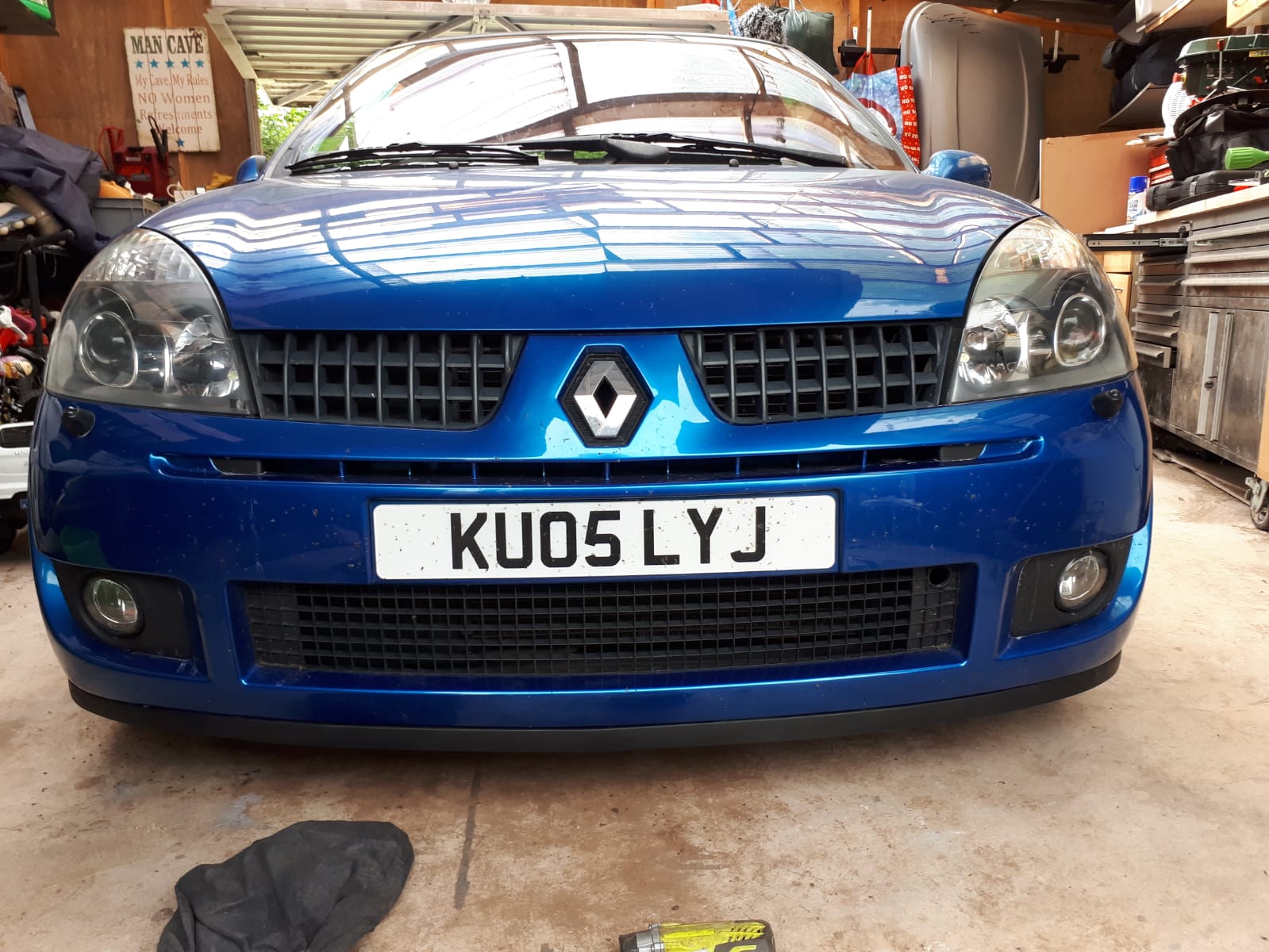

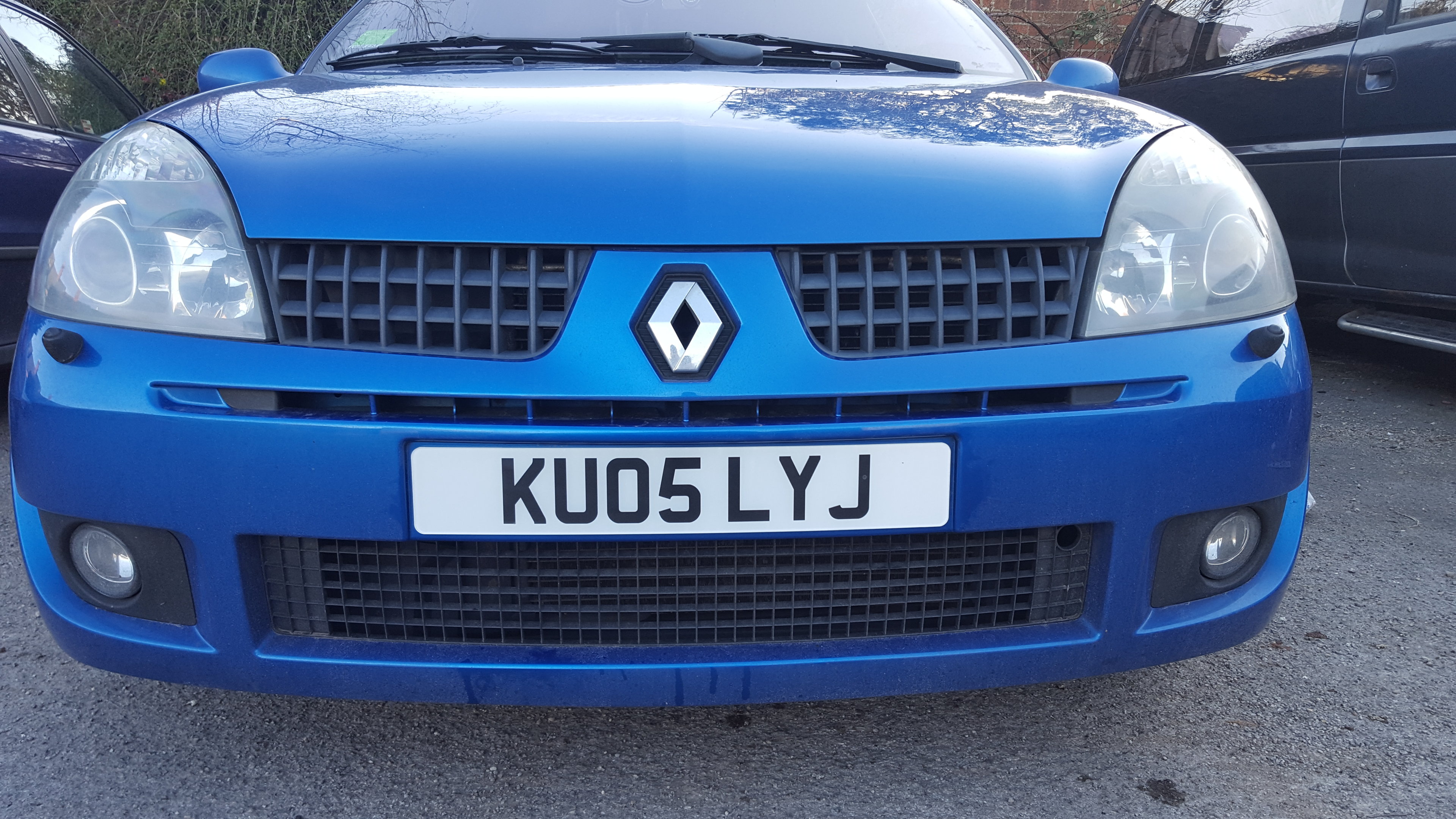

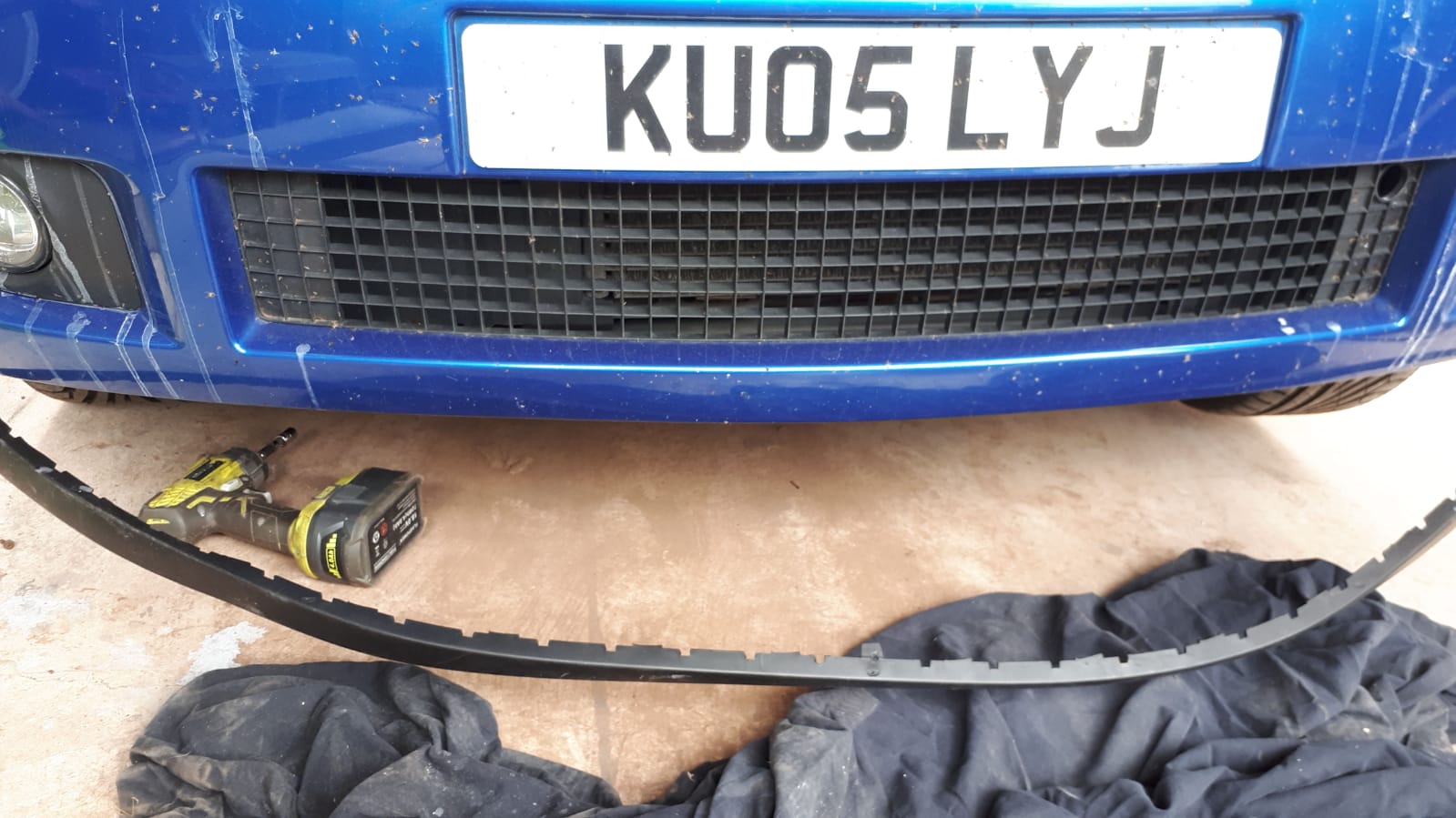

Whilst I'm deciding what I'm gonna do about the belt situation, today I've finally got round to fitting my 3/4 plate and new rear plate which looks loads better. I've also had the usual front headlight washer issue where they leak over night. So I've added two one way valves (one in each line) to hopefully sort the issue. Then filled it up with Halfords berry screenwash as it smells awesome.
Hopefully going to get the Fabia splitter fitted tomorrow so I can at least finish the front end. Will update with pics tomorrow.

It won't be to everyone's taste but I got them for 80 quid and I thought "they'd do the job for my first track day". My brother owns a wheel refurb company so will get him to sort them out. Was thinking white or pink.

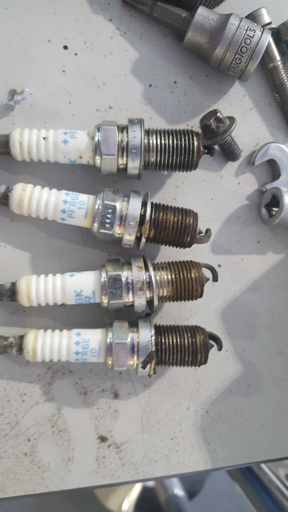

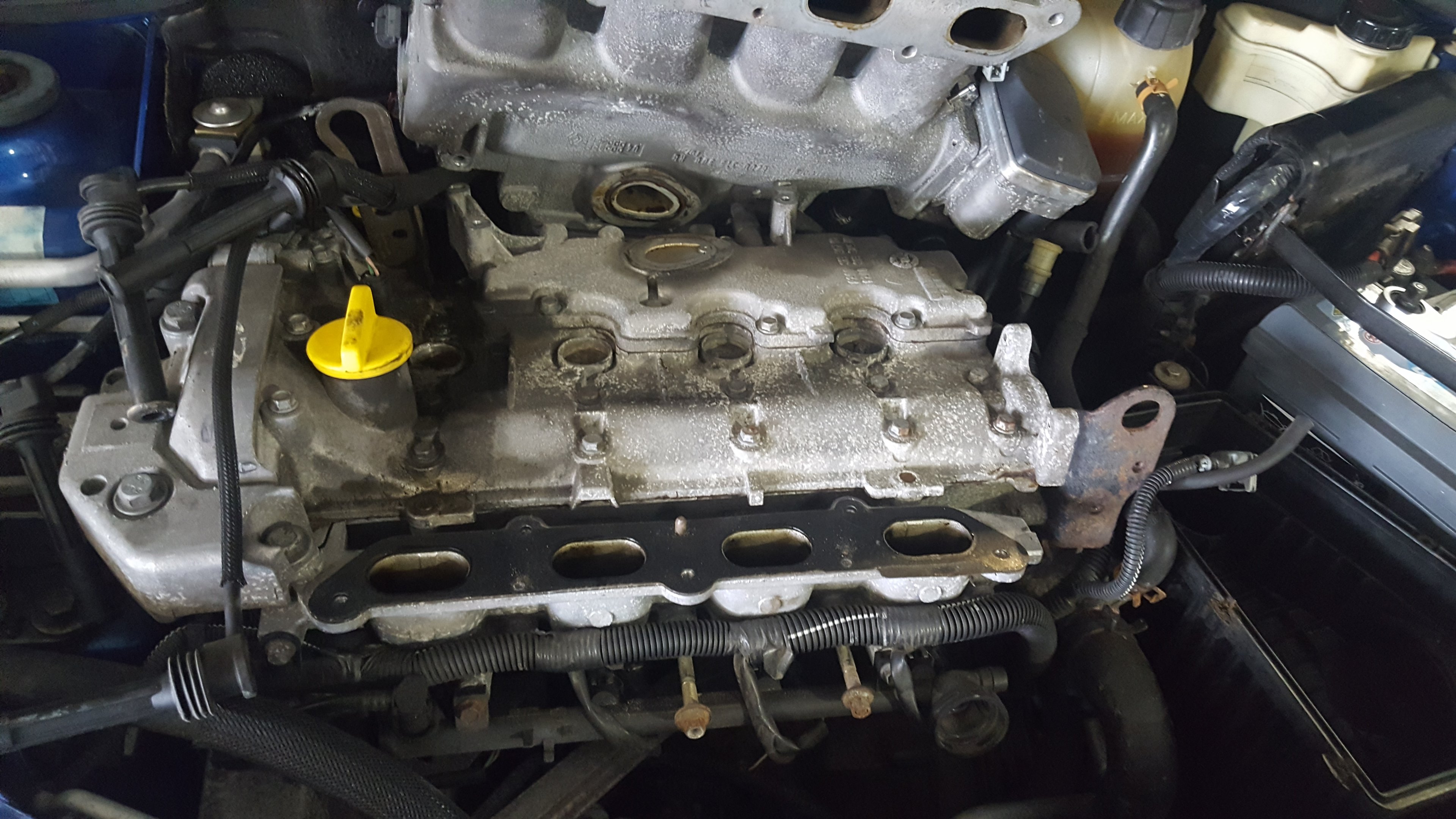

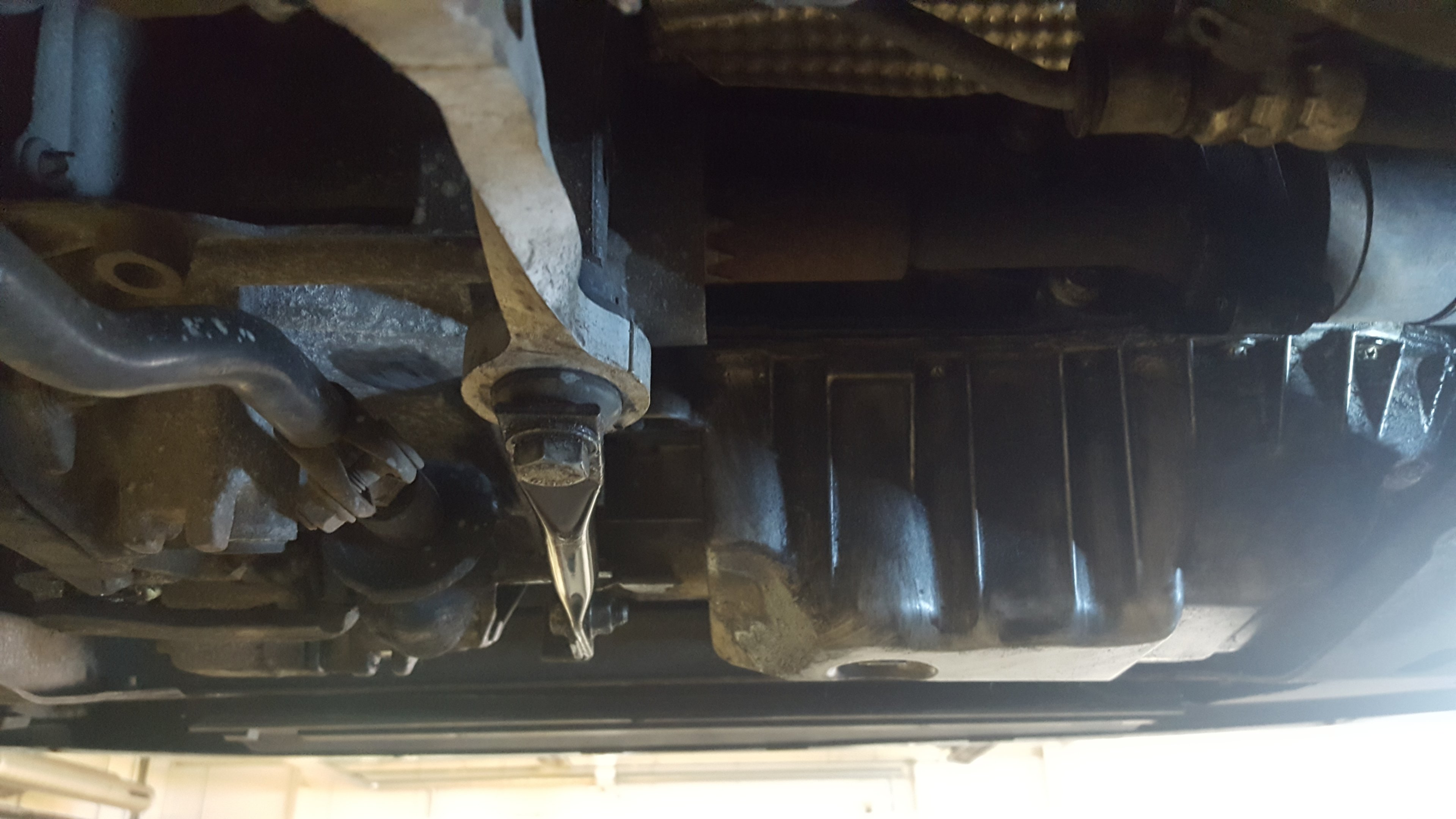

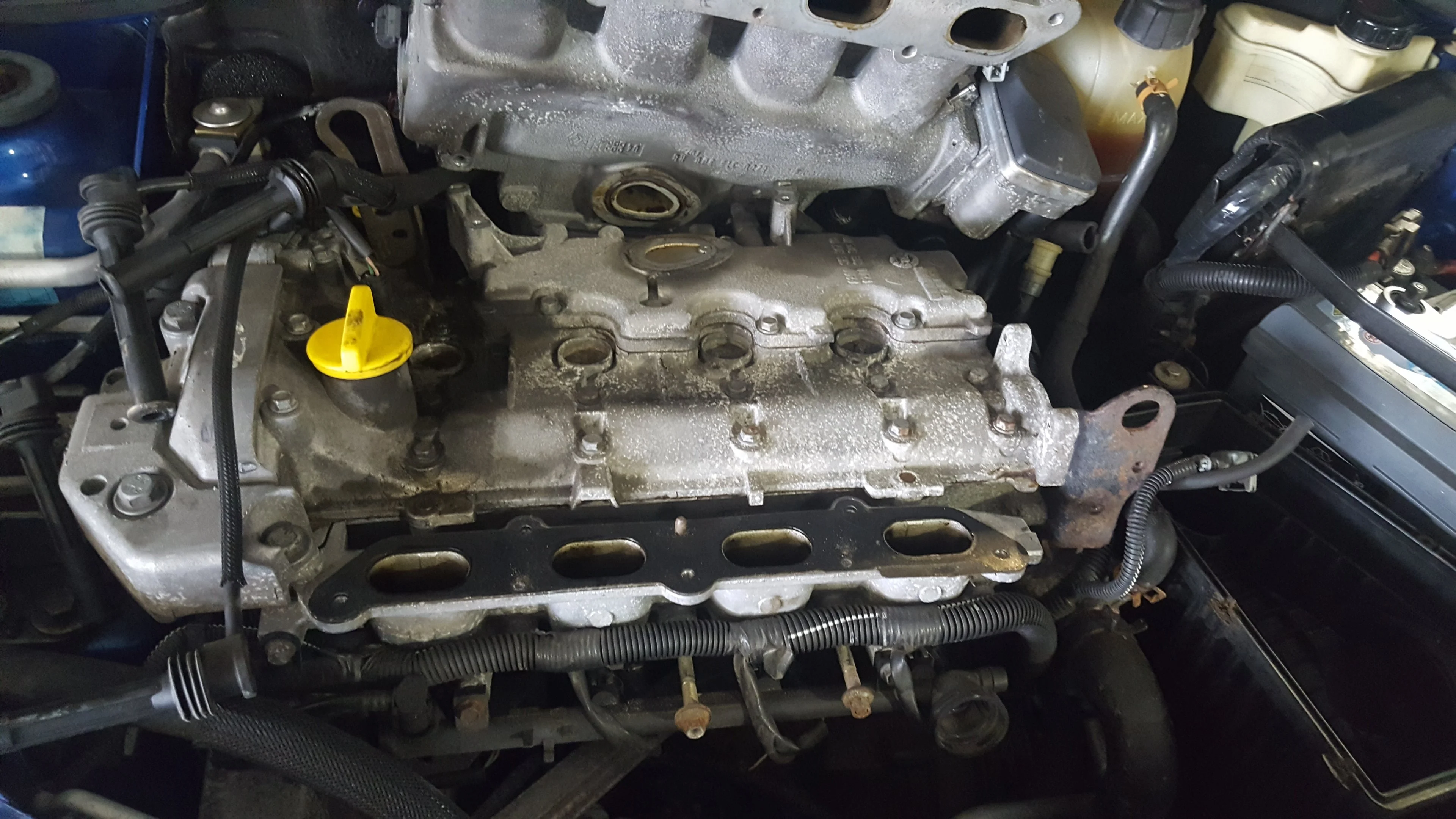

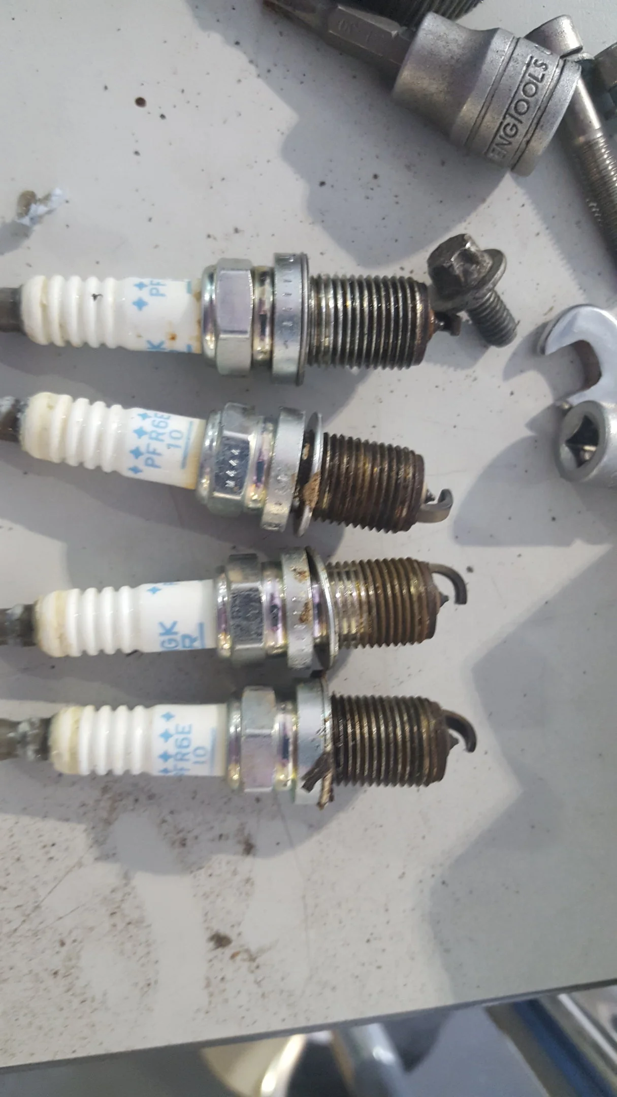

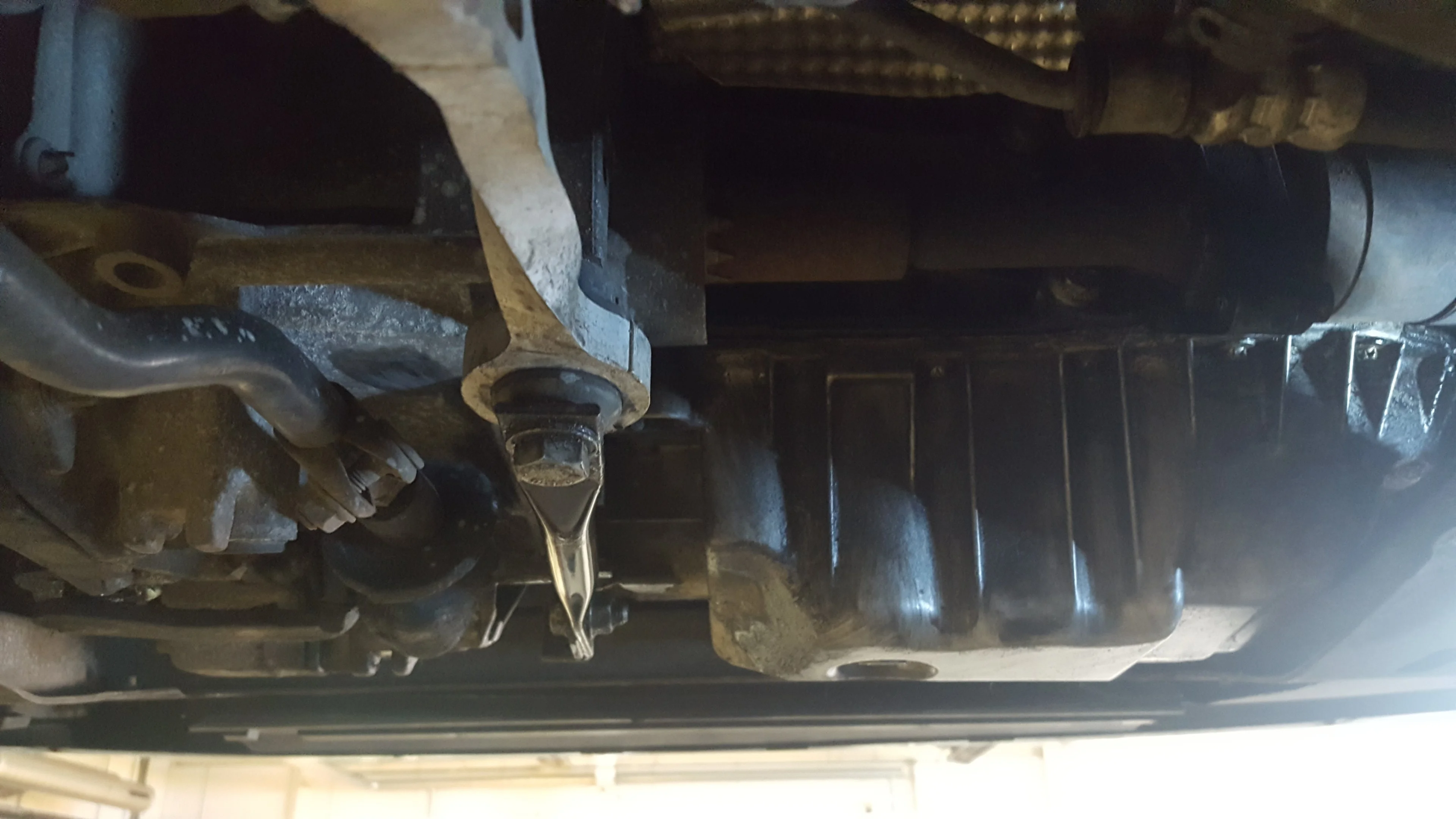

So I finally managed to get the car serviced today, and I remembered to take some photos. Most of the stuff removed wasn't too bad, though definitely will be improved by new items.

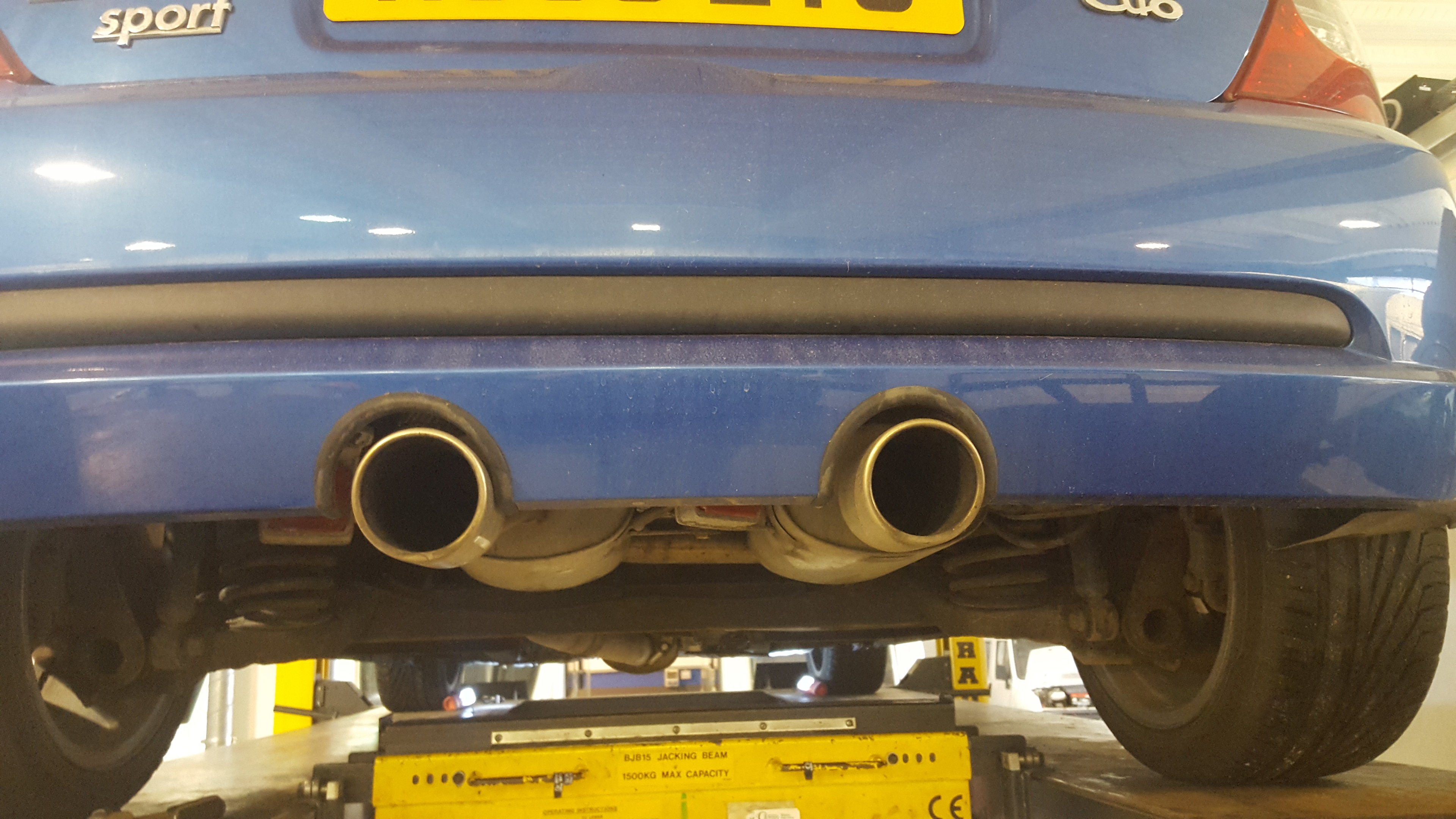

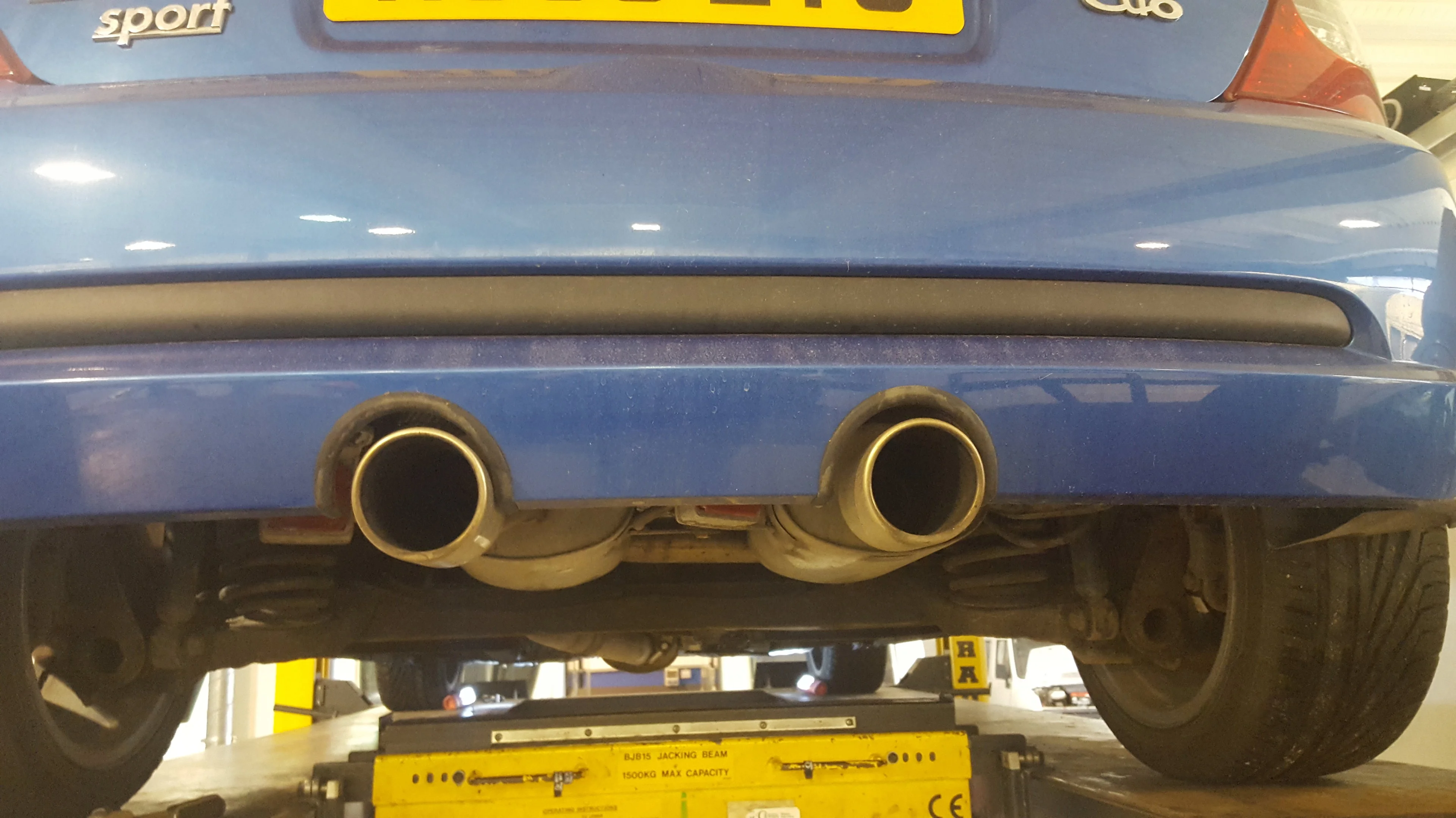

Managed to 're align the rear exhausts too, though forgot to take an after photo apparently.

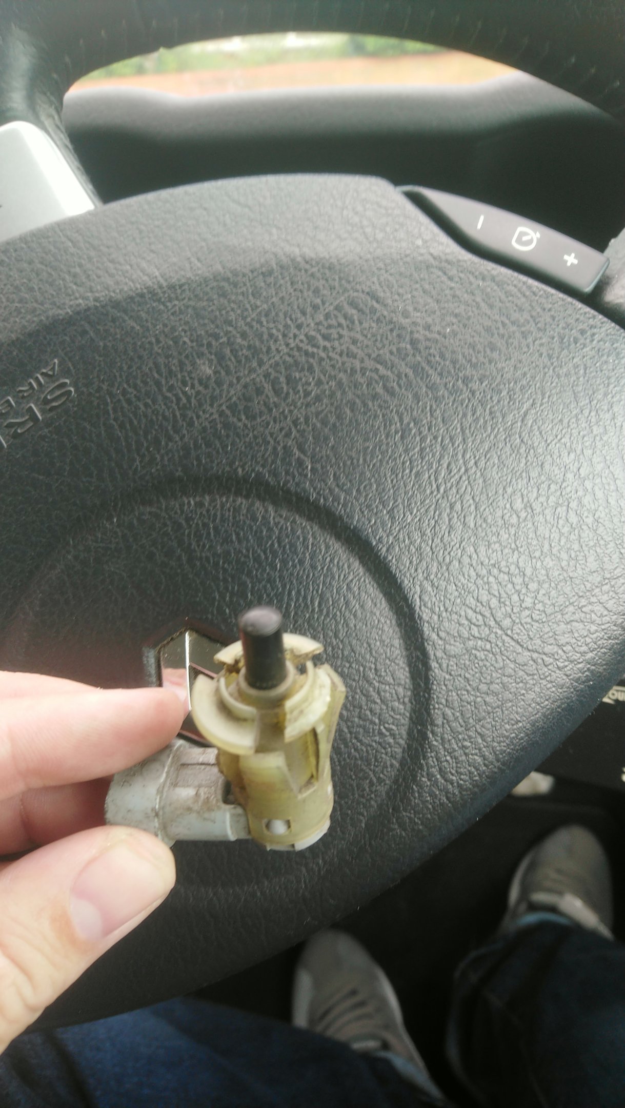

Check the flashing codes on the alarm and it indicated an external sensor fault.
So now I'm thinking great, I'm gonna have to work my through switches to see which one is faulty. However, checked the bonnet pin and.......
Found it sitting half way down its normal position and with broken tabs. Quick search on RPD and there's a new one omits way. I've disconnected it in the mean time and hope that it doesn't go off.
