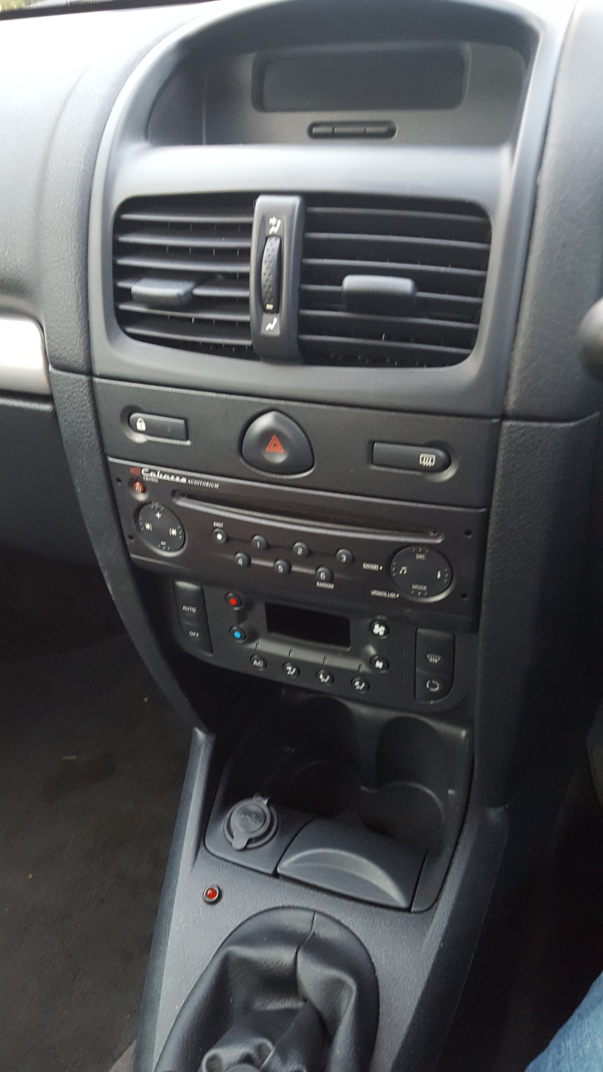

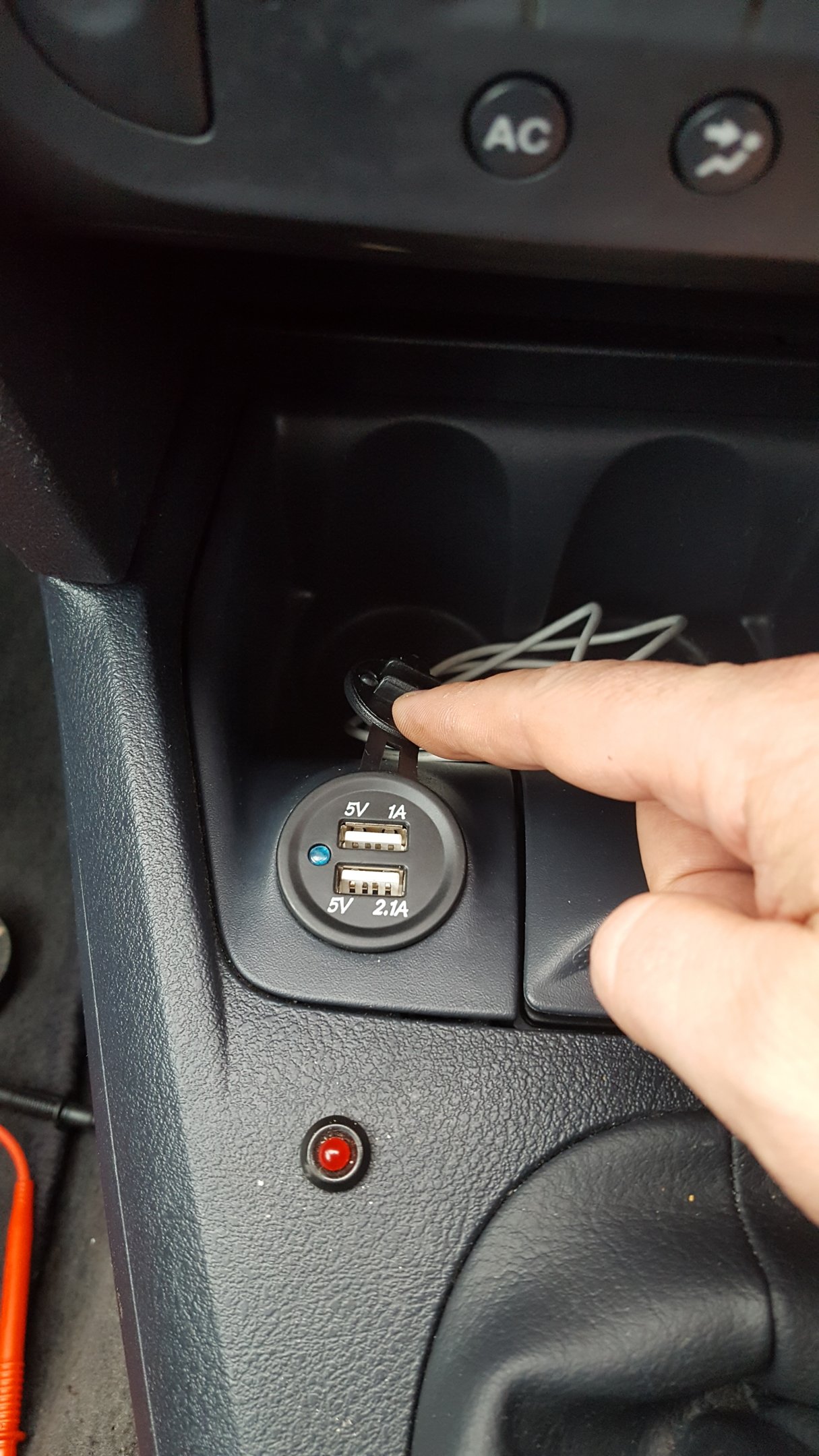

Well knocked off the first thing off my list, fitted a usb charge port as the cigar lighter was dead.

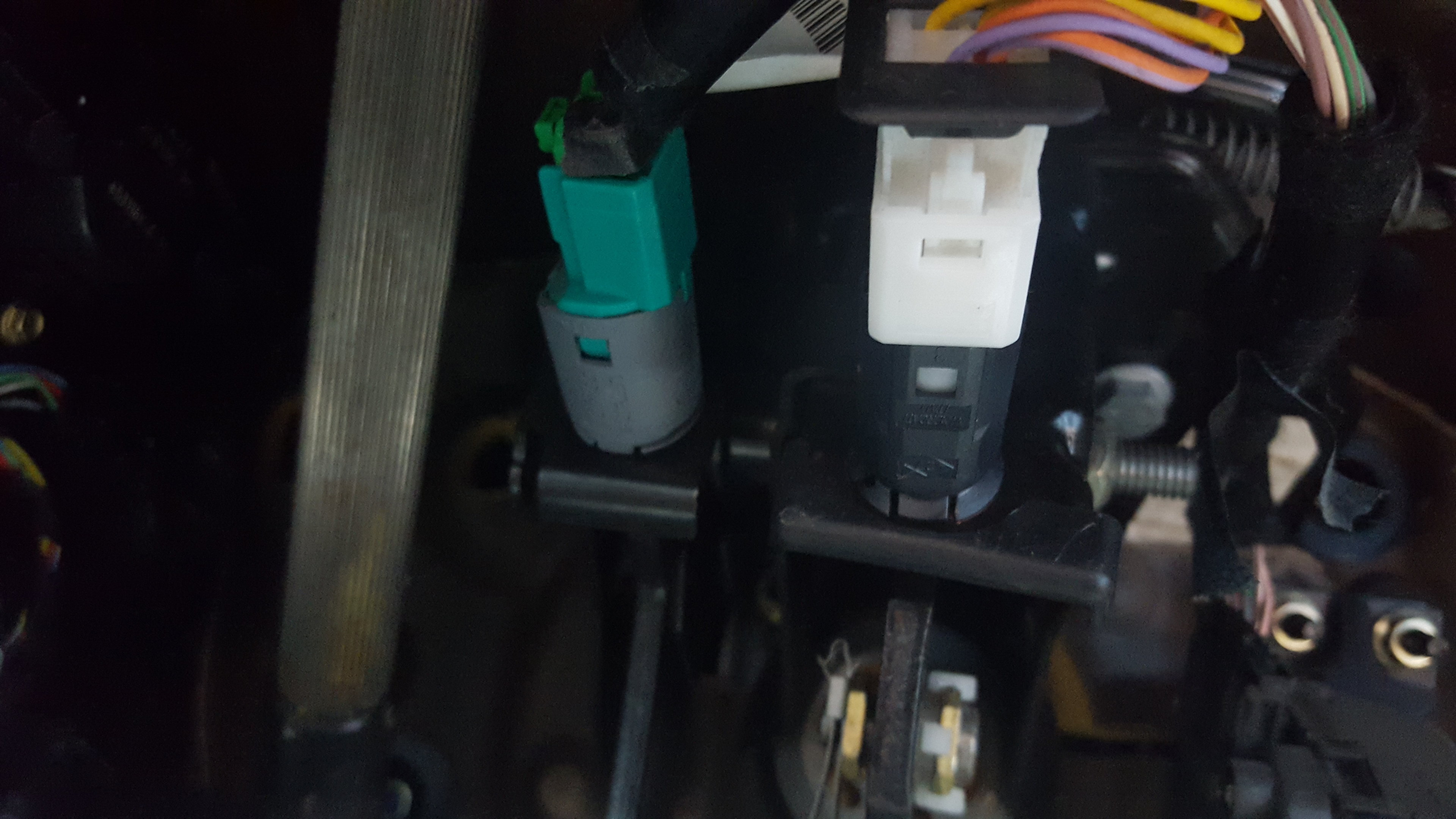

So I managed to fit my my brake light switch and the osf wheel speed sensor.
Didn't get a pick of the speed sensor as was bust grafting lol. Here's the brake switch.

Hmmmmmm. Replaced the brake light switch, off whent lights.
Lasted all of a day, same lights back on. I've got the abs service and traction light on. Any thoughts?
It needs adjusting so the brake lights come on as soon as the pedal is pressed. It's on a ratchet type thing so you can adjust the length of the switch. It might take a couple of trys to get it set right.
Car Charger / Idealeben Dual USB Adapter 12 V / 24 V Travelocity Motor Vehicle Cigarette Lighter Socket iPhone, iPad, Samsung, Android and Other USB P https://www.amazon.co.uk/dp/B0132MOCI8/?tag=cliospnet01-21
It's almost the exact size, just needed a rat tail file to widen the hole a touch.
Had another look at the brake pedal switch, turns out it doesn't have any adjustment.
I've ordered a genuine one from RPD this morning as the drunk lights are getting on my nerves now.

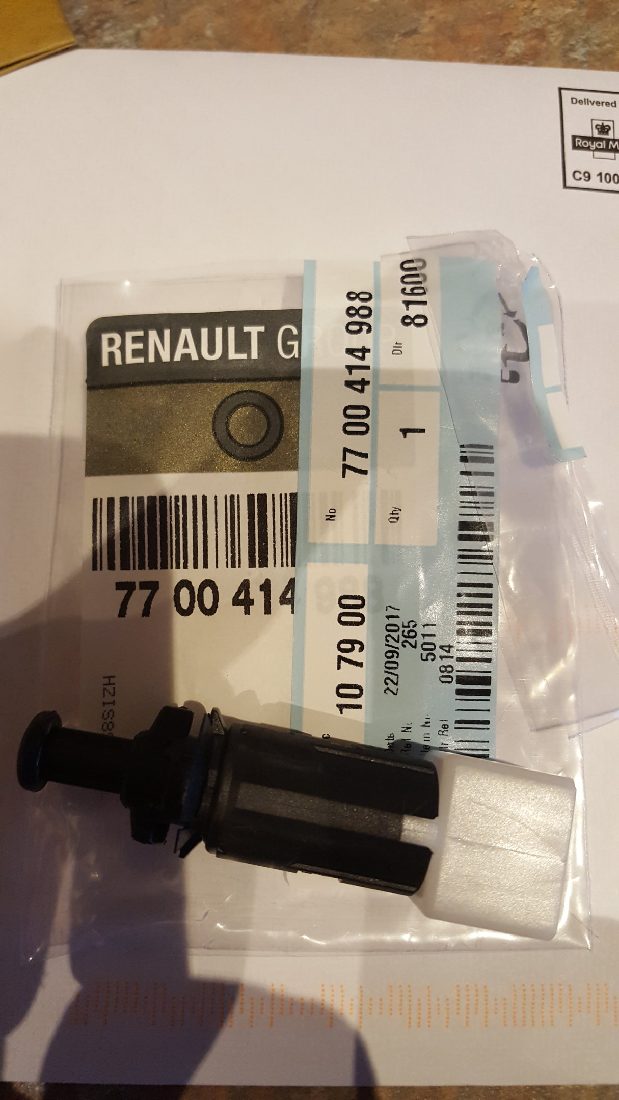

So I've finally got round to sorting some stuff on Mingo. First off, I received a genuine brake switch from RPD (quick turn around so cheers)
Got that fitted up, took a few attempts to get the drunk lights to stop coming on every time a touched the pedal. For reference, mine was at five clicks.

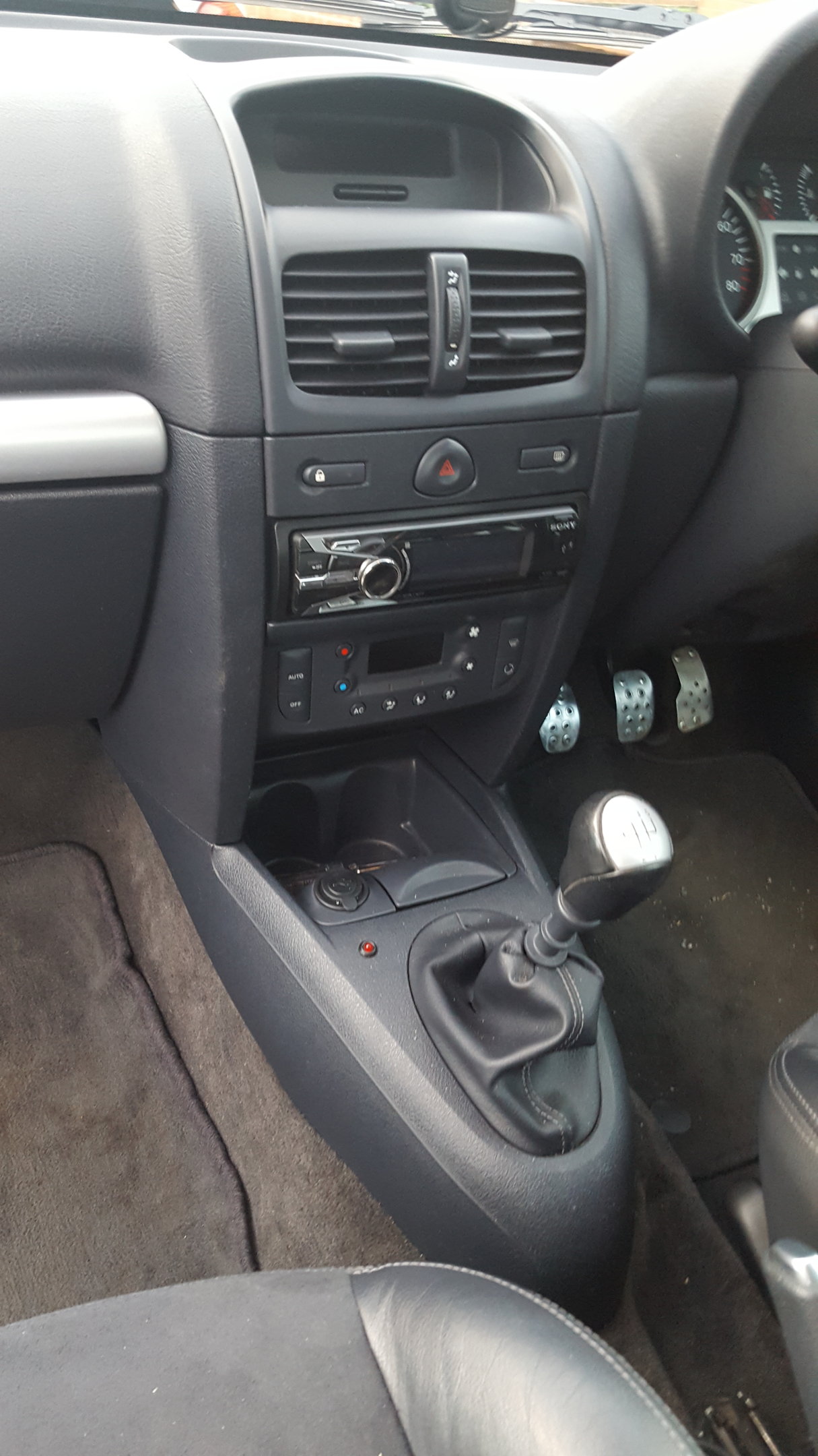

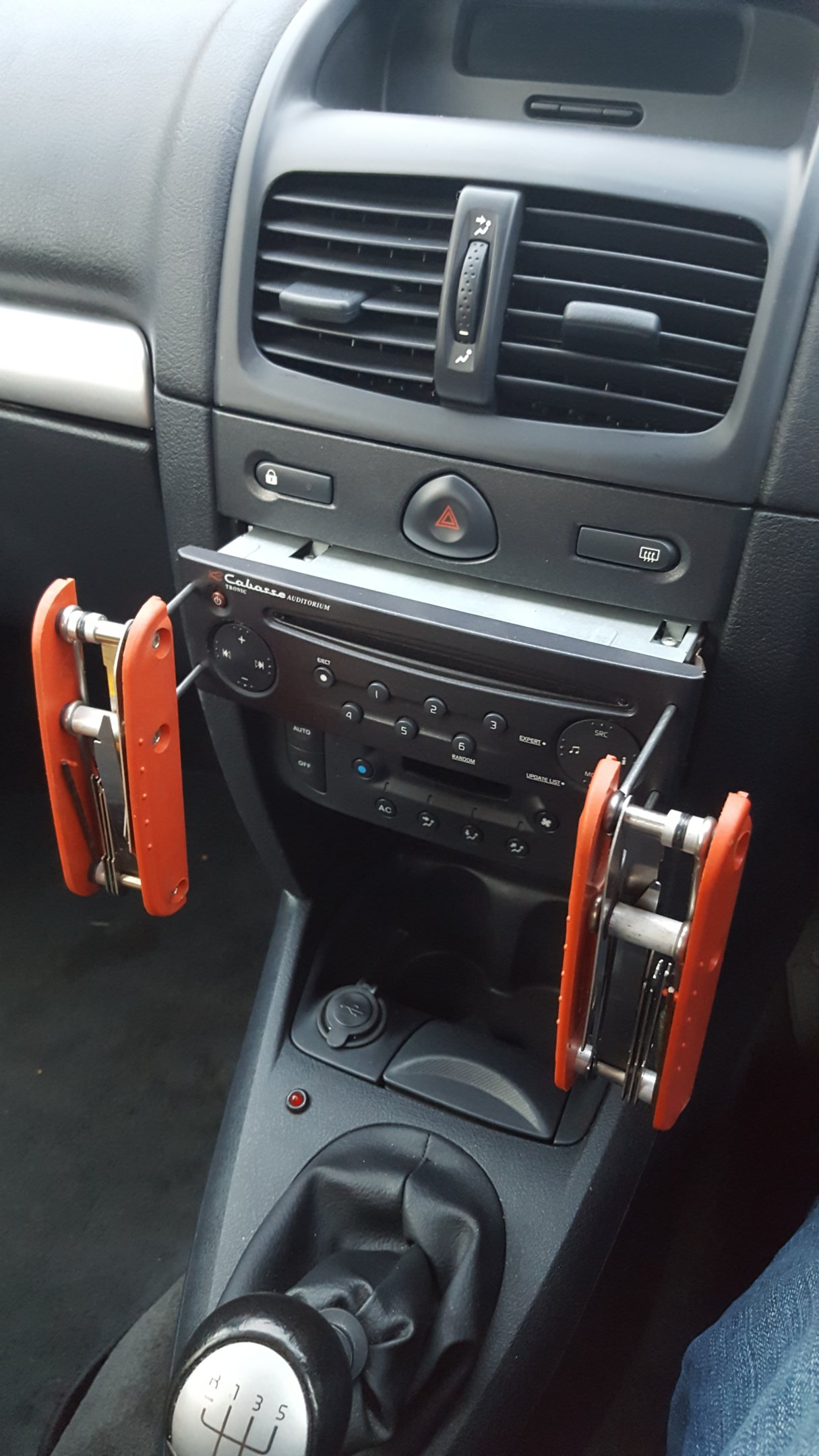

Then was time to fit my stereo, I'd ordered a conversion look to make life easier.
So I started with this
Turns out the lead wasn't correct as my steering wheel controls don't work. Have orders another and will fit that when it turns up.

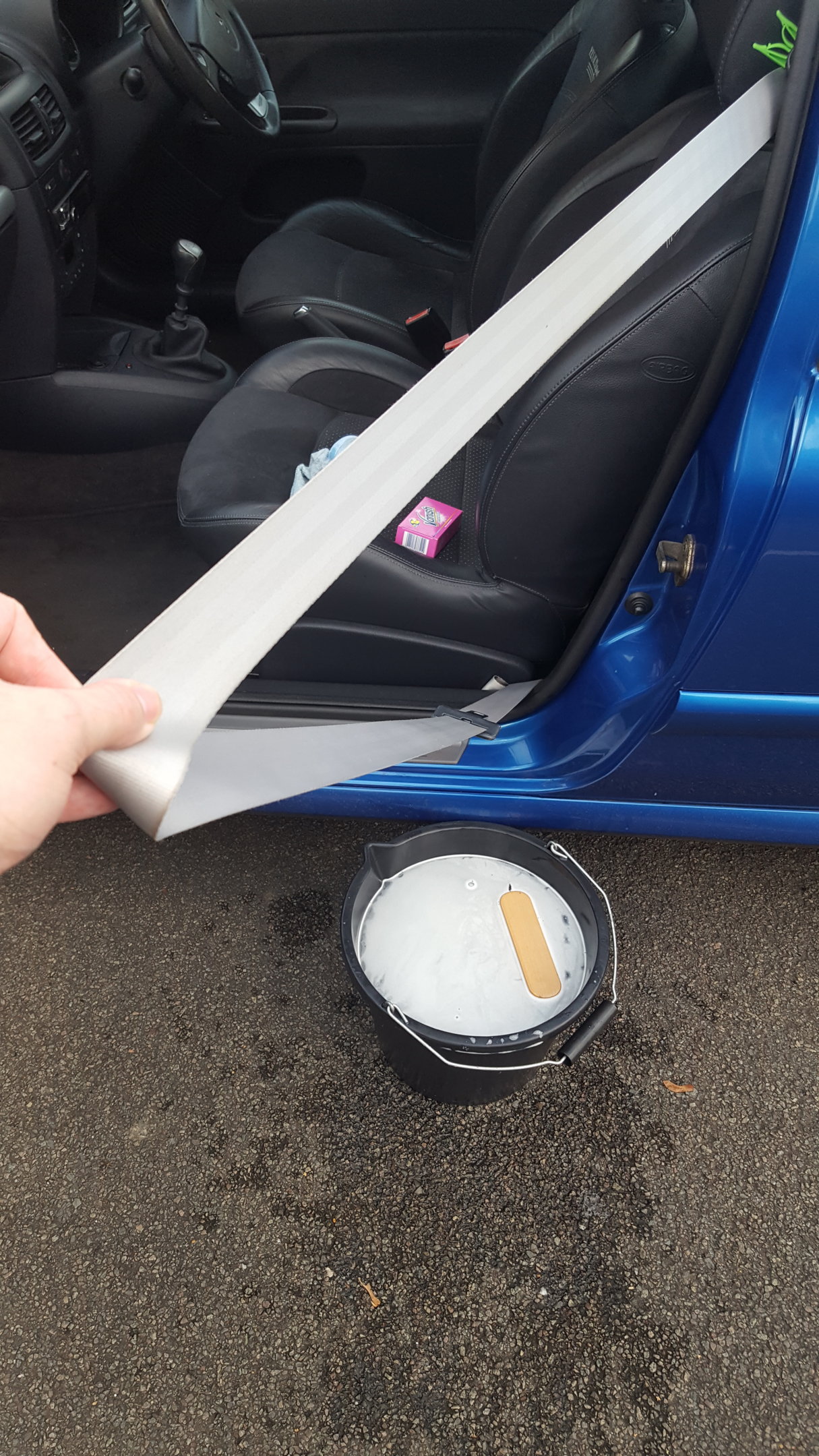

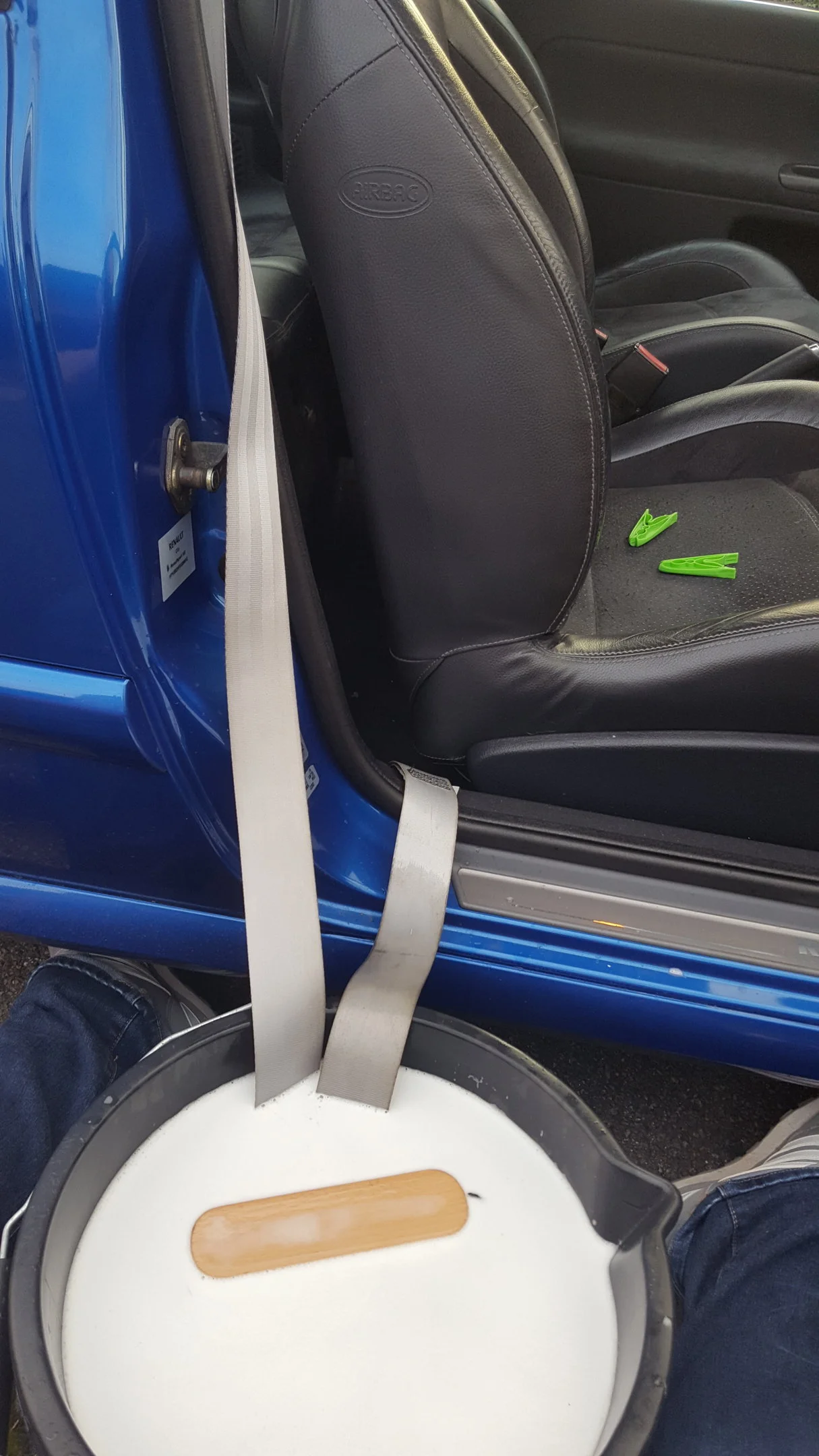

Lastly, everytime I got in the car I was met with the disgusting now brown seat belts.

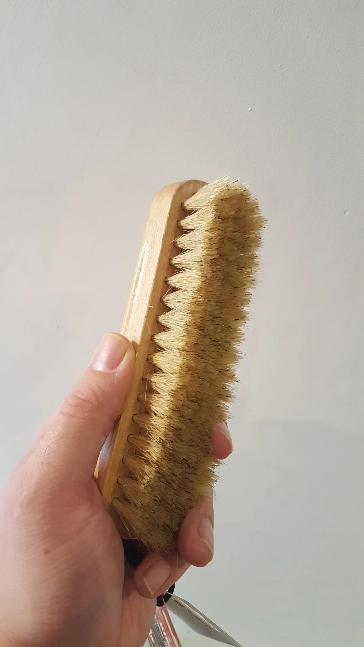

So armed with these
Now their not great yet, but they are massively better. So that's my Saturday messing done. After a two hour kickboxing grading and then that, I'm knackered so it's beer time as far as I'm concerned.

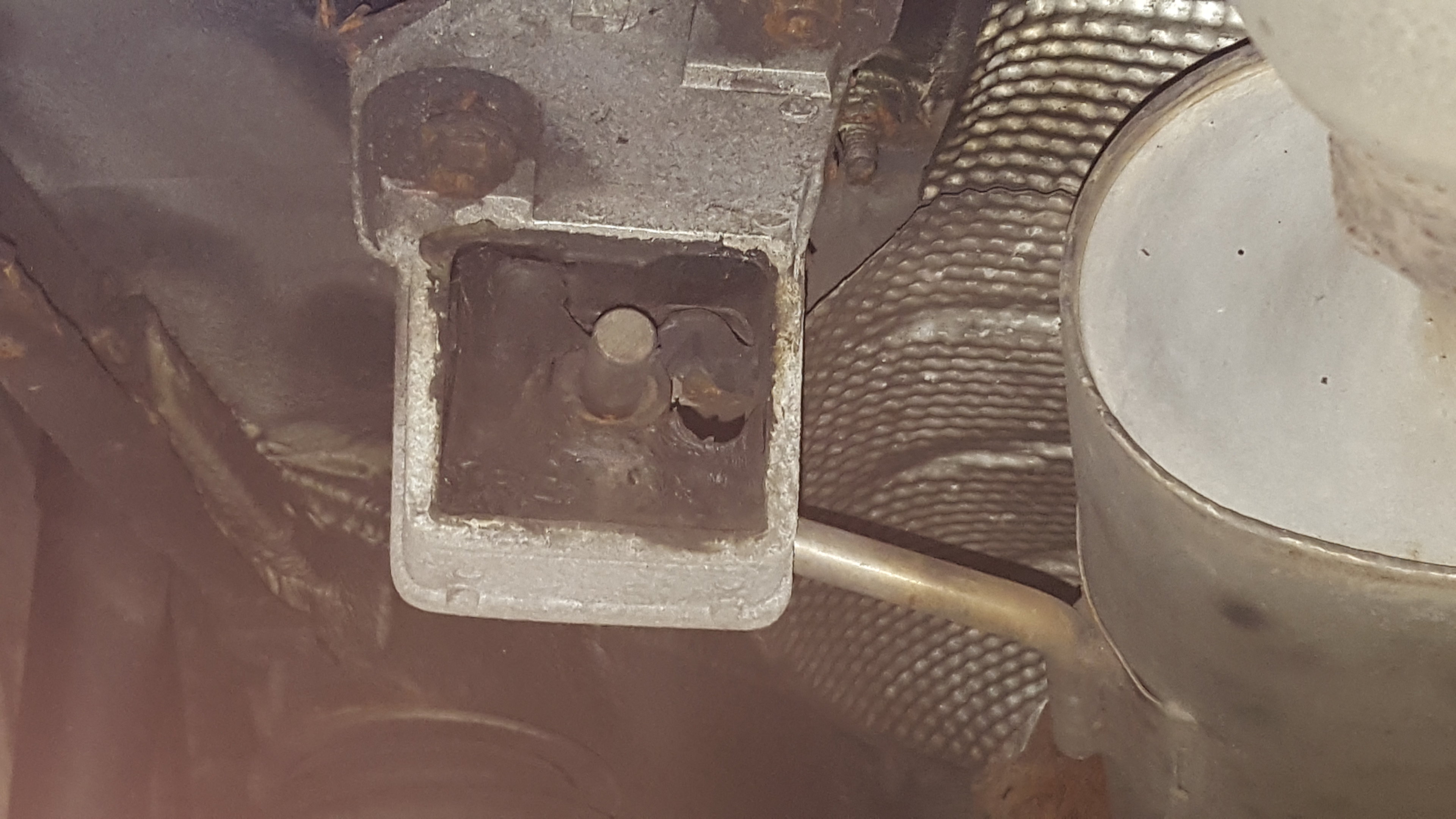

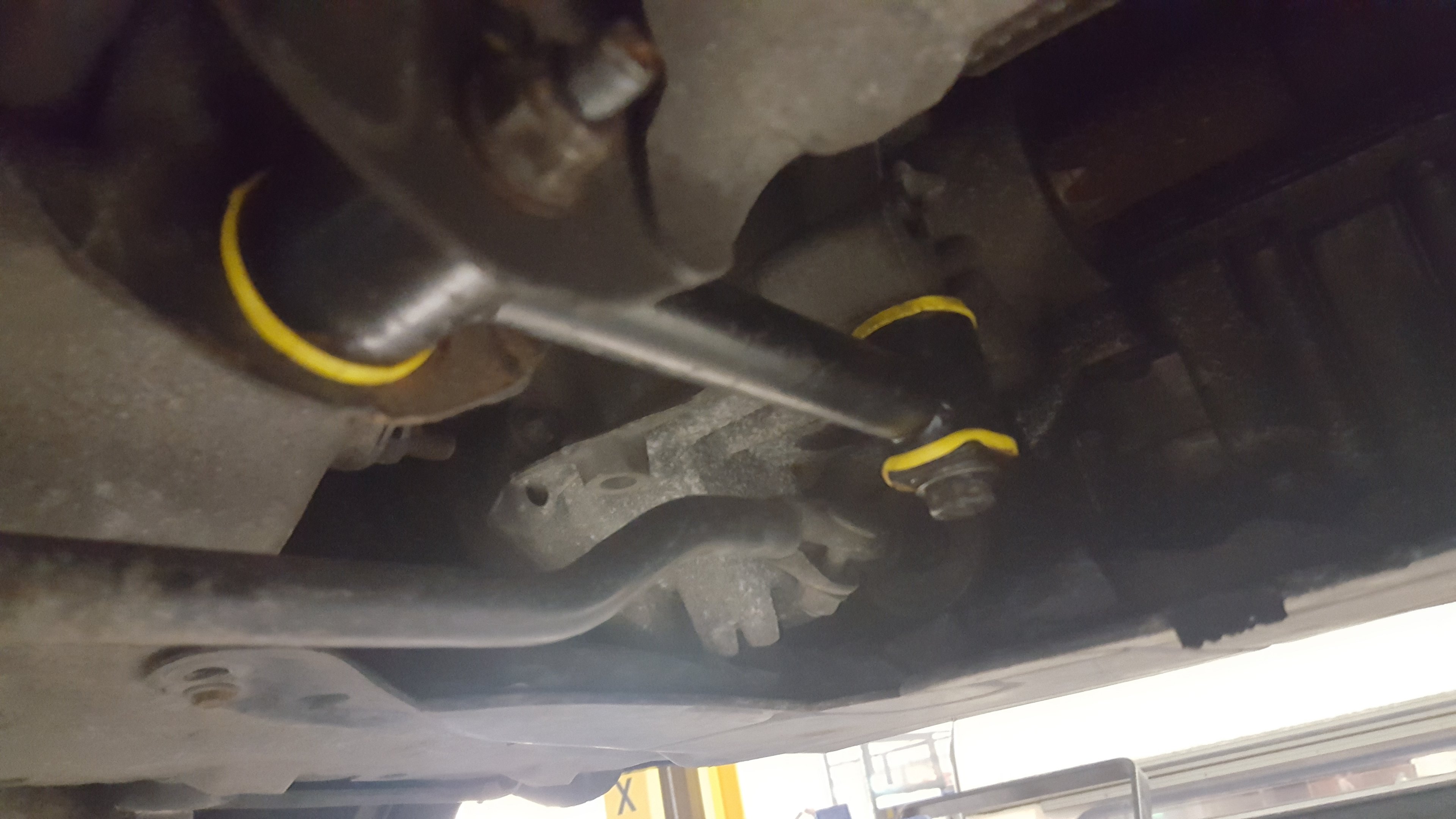

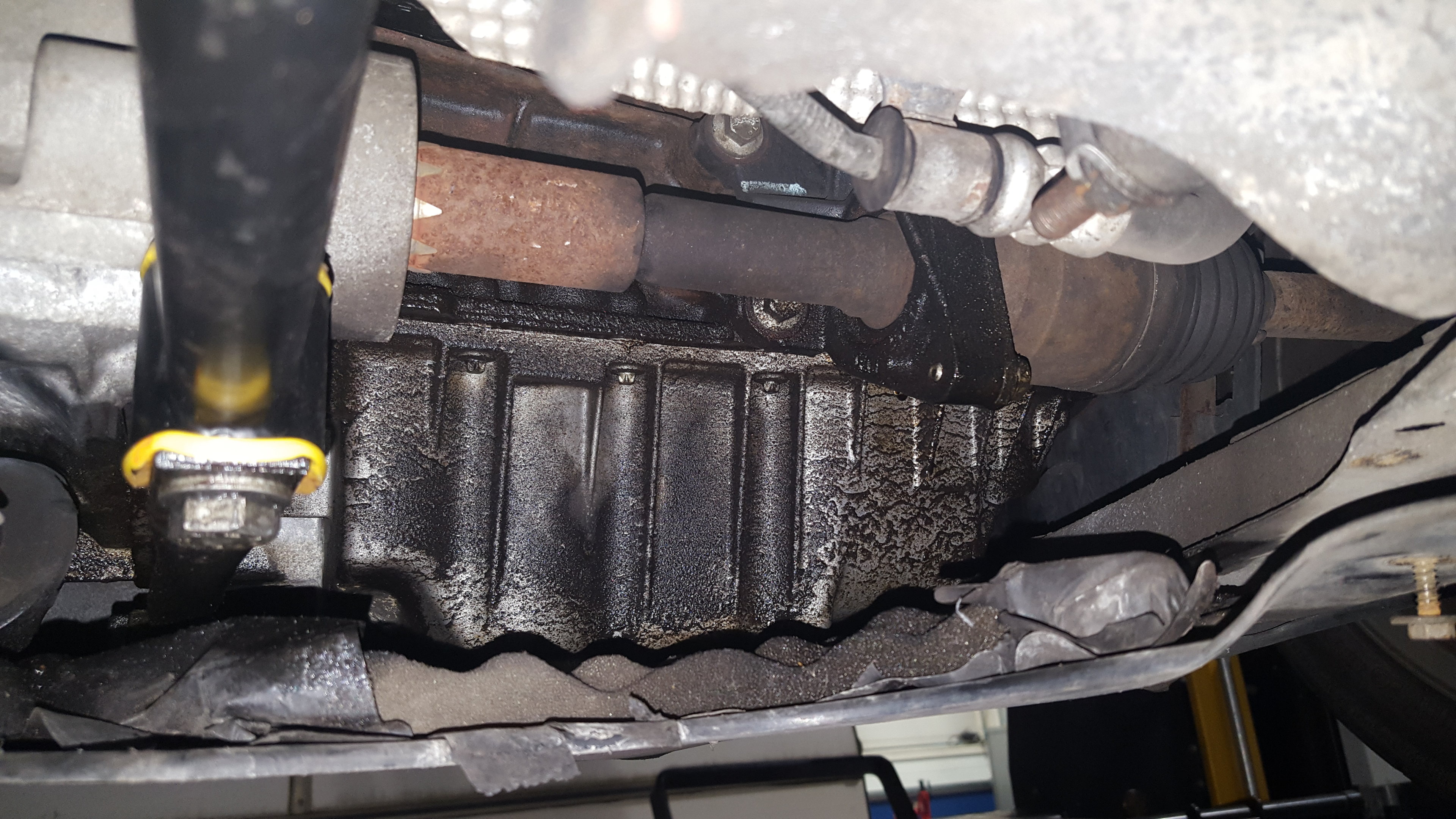

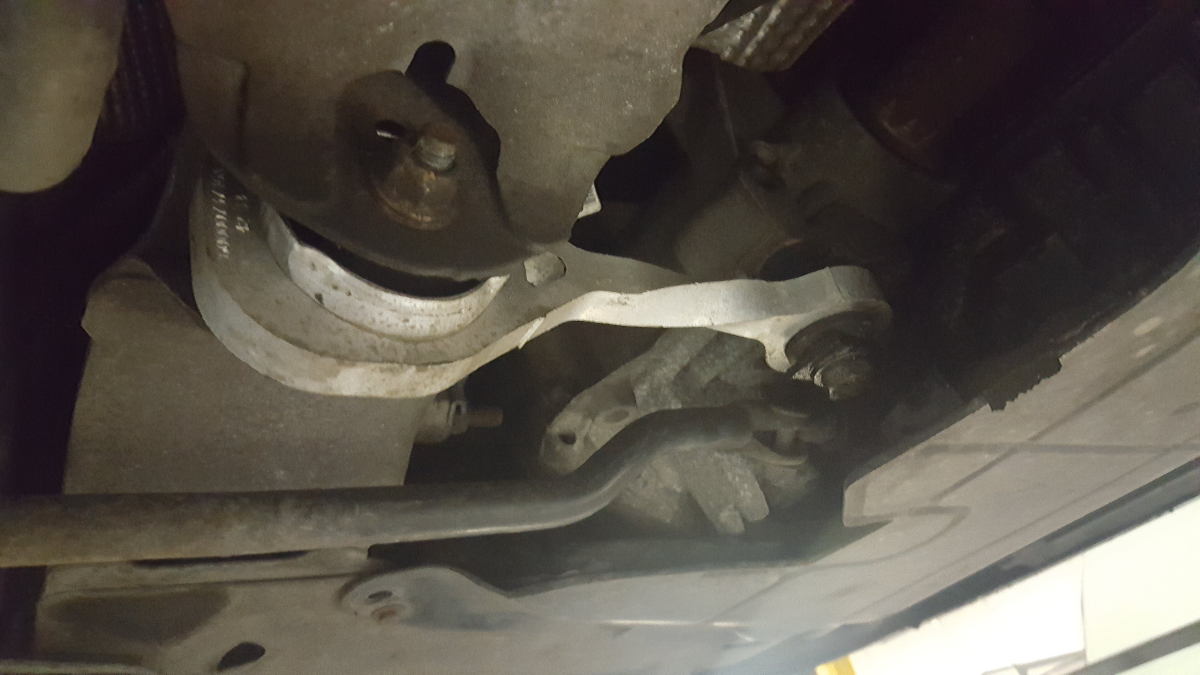

So managed to get a couple of bits done today. First up was to change the rear gearbox mount as I'd got an evol one. So what I started with.
First impressions, the gear change is like night and day. It makes a huge difference for the better with regards to selection.
Downside, the vibration is already doing my head in. Will give it a couple of days to settle and hope that it either improves or I care less lol.
It also looks like I've got an oil leak which I'll need to look at shortly.

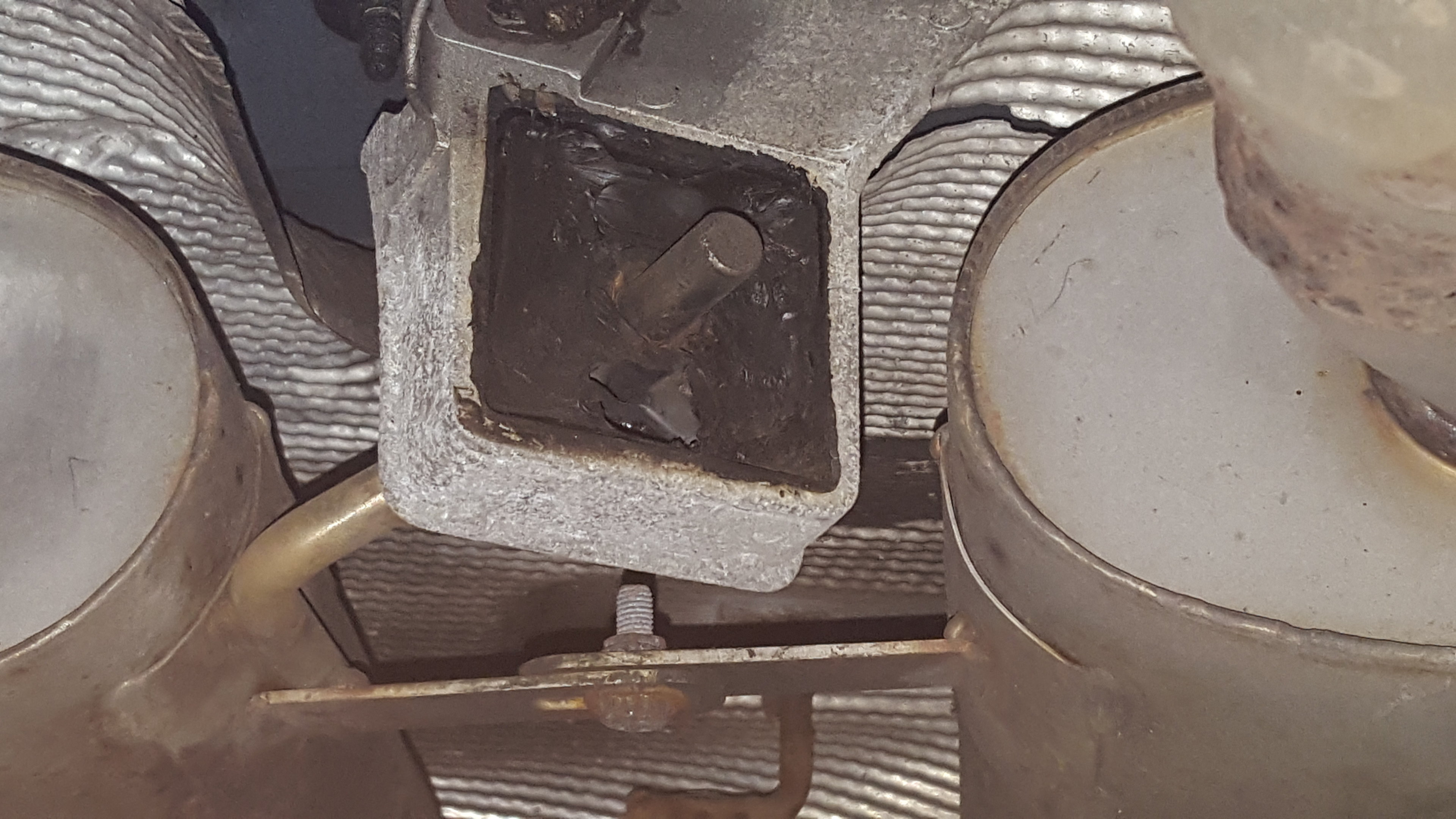

Also managed to change the rear exhaust mounts as they'd seen better days.

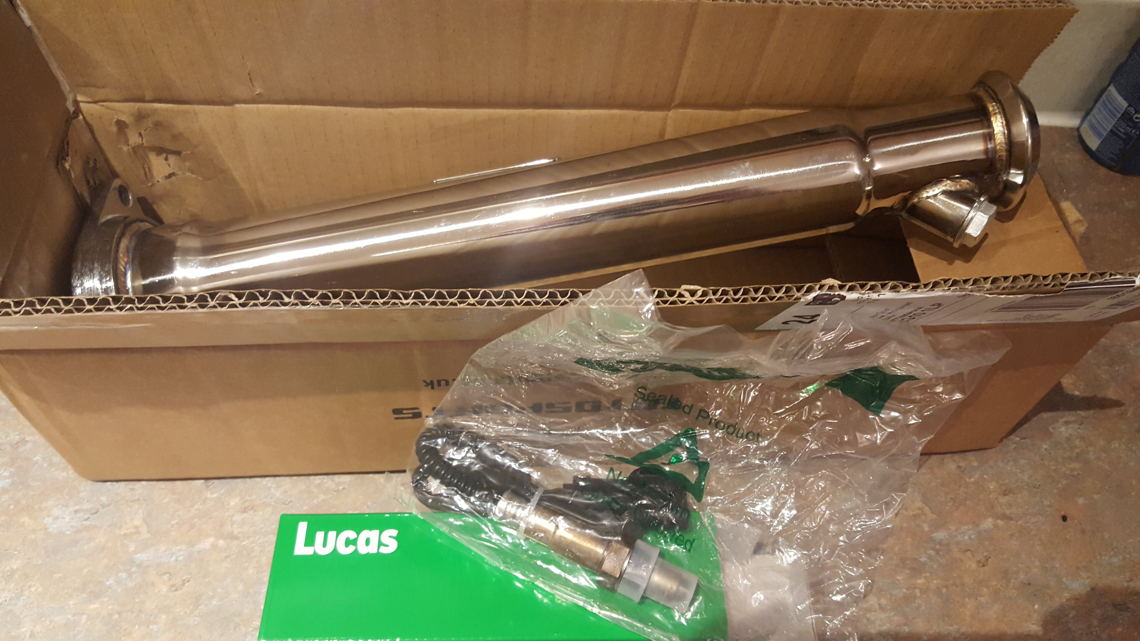

Gonna pull the headlights out this weekend for a clean up and fit the decat I have.

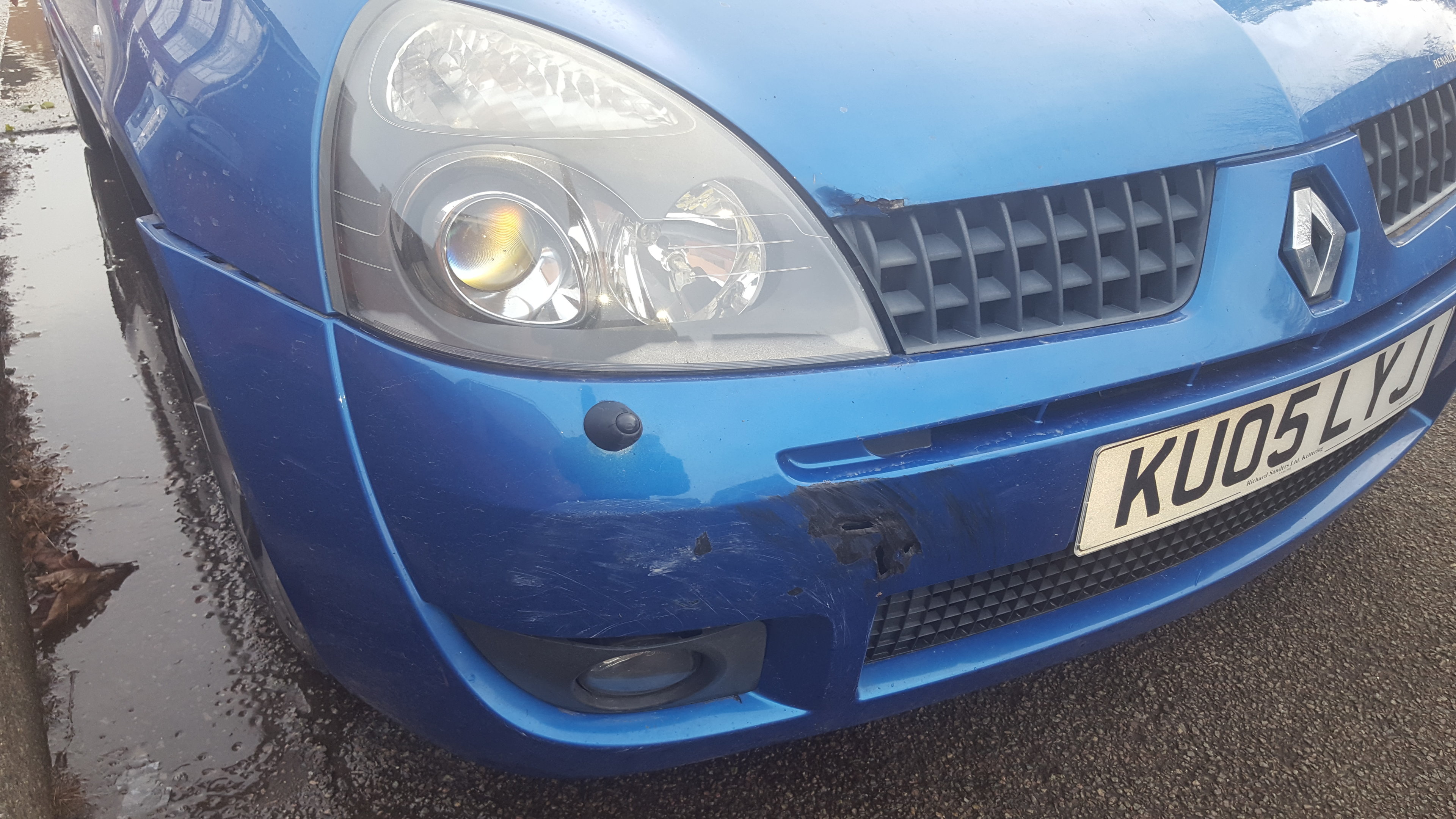

So yesterday was a s**t day. Back end skipped out on the motorway (shitty toyo's) and resulted in this. Gutted. Though very luck it wasn't more.
oh dear, tbh to hit something on a motorway, which usually means some kind of speed is involved, and only come out with that is good going
remove t1r's immediately, burn with fire, replace with rainsports all round. safety first :)
To be fair I'm very very lucky. I was doing 70 in the overtaking lane. Spun twice and clipped another. I've replaced the fronts with uniroyal which are epic, it was the back that stepped out. The rears are going in the bin as soon as.
