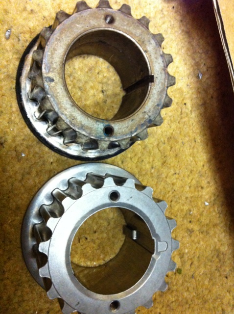

Adey.

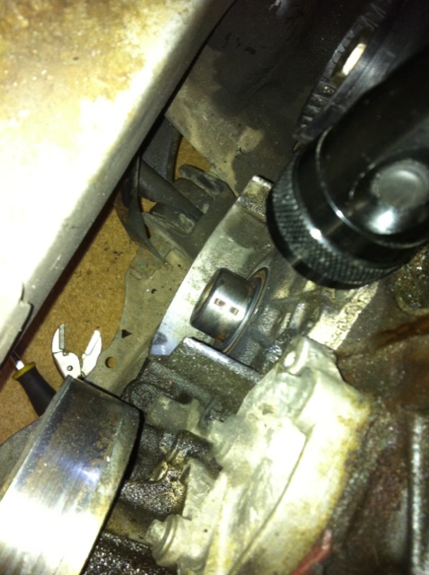

the meggy pully cant pysicaly fit on the clio crank, the meggy pully has a cast in key for a slot on keyway, the clio crank has a drop in keyway cut in it?

neither is the megane crank, the keyway on the crank is at an angle, but the pulley slides straight on

its really not, i can see it clear as day. for a slot on key to work the crank/shaft has to have a slot on keyway cut, it physically wont slide into position otherwise. oddball crank or wrong part?

indeed, i can make a key to fit the crank and the original pully, just odd that everyone goes on how the meggy 225 pully is a direct fitment when it clearly isnt in this case
  Lionel Richie
it is normally? very odd, how far on does it go?
the slot in the clio pulley is a different thinckness to the slot in the crank
