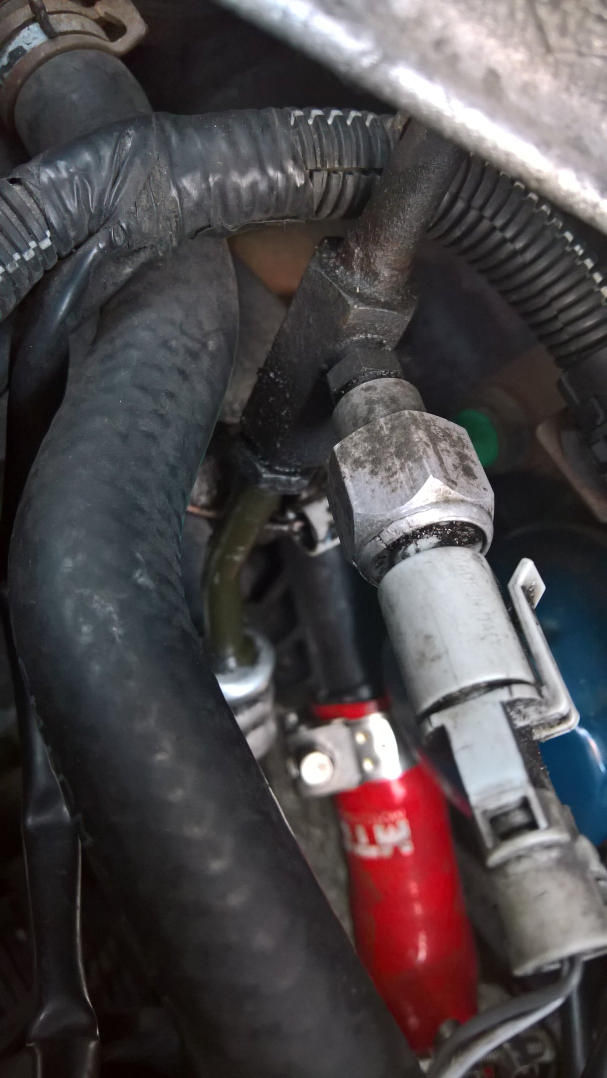

Woken up to a nice pool of pas fluid on my driveway. Only place I can see it would be leaking from is here
is it just a case of disconnecting the lower pipe and replacing an O ring? If so does anyone have a part number for it (pic taken after cleaning the pipe up)
don't seem to have lost any fluid from the reservoir so don't think it's a big leak
thanks in advance

I think its just the lower pipe, I will properly clean it all up and then double check where its leaking
Am I likely to lose much pas fluid when disconnecting it do you know?

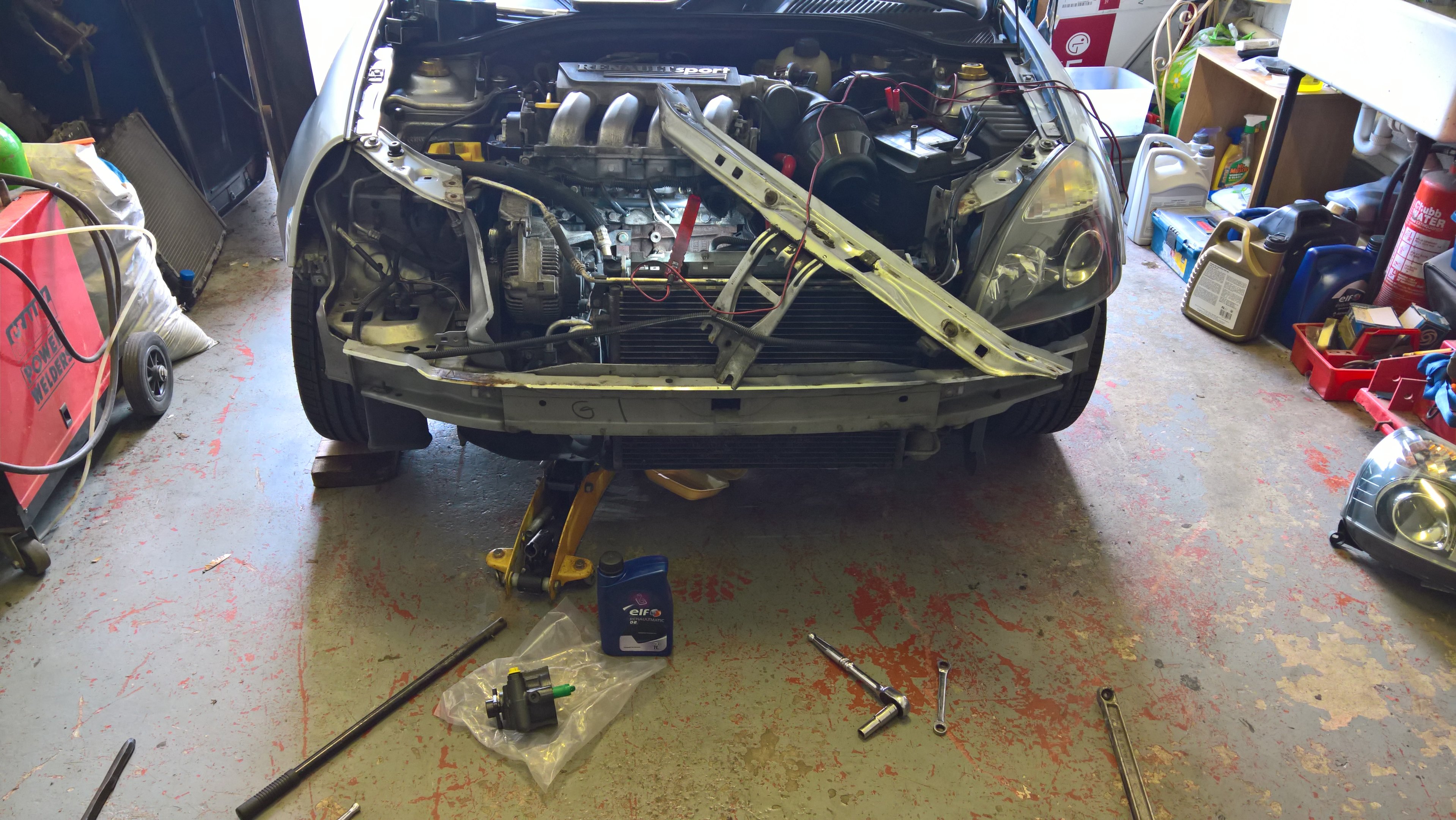

Right, this has turned into a large leak whilst its sat on the drive and theres fluid dripping off the sump. both pressure switch and connection seem dry so have concluded it must be pump related.
Have ordered reconditioned unit for it
Are there any guides on here? I will work it out myself as iv had the engine out before now and have changed the aux belt/tensioner previously but if theres a guide it will make life a little easyer
Also, I replaced my aux belt (just belt) about 2k ago due to deteriation. will I need to replace it again as I'm loosening the tention?
Thanks

IIRC there's a metal PAS pipe that wraps round the front of the engine, which rusts through and fails?
IIRC that's something I had to replace, but it's so long ago now, I really can't remember which part it was.
I think cleaning everything, refilling and then watching where it's pissing out from might be the easiest way of identifying the culprit!

Iknow but that's another tenner for a belt iv just replaced that I don't have. Spent £75 on a pump, £4 on 2 "o" rings, £18 on a pressure switch aswel as top up fluid
I have pictures of mine like that somewhere :D lol
Bit scary for a mechanical noob like me, but a good feeling to actually get things fixed and learn along the way :)
