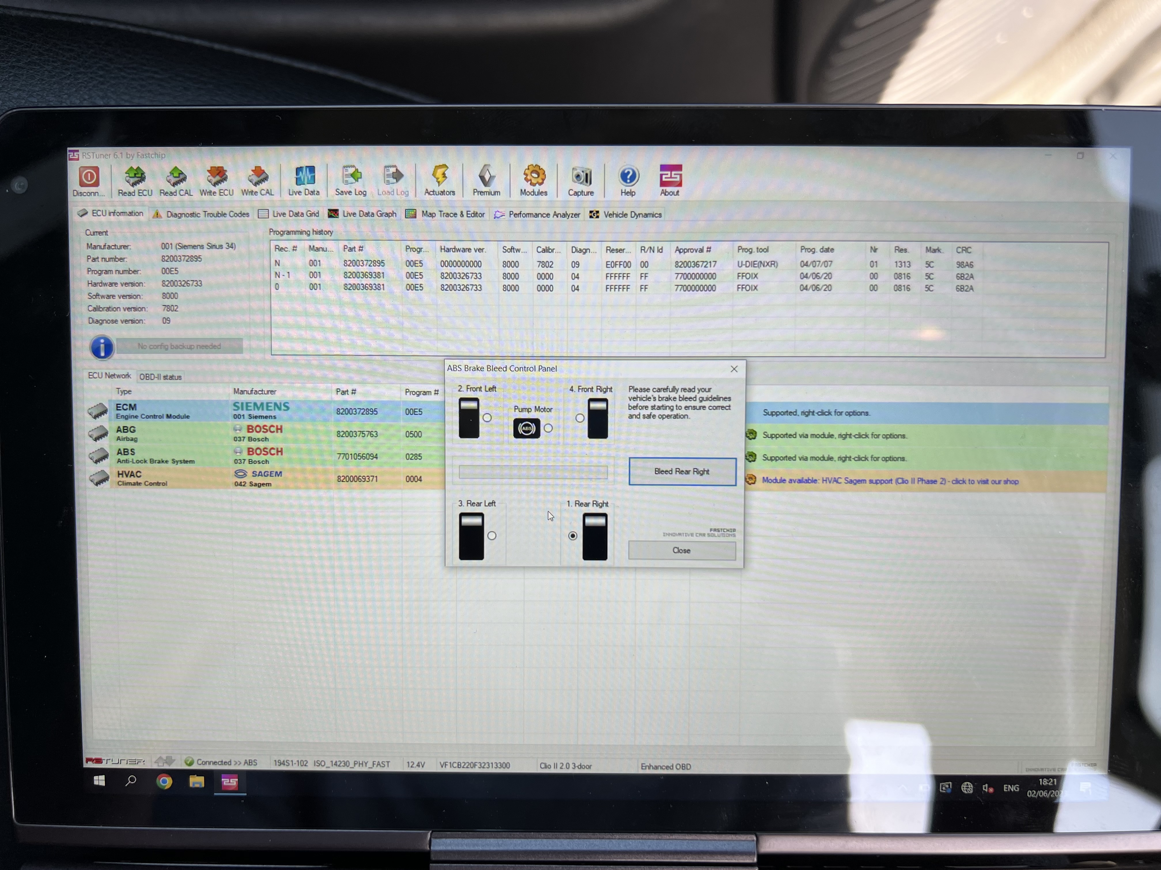

I'll grab a screenshot of the RS Tuner suggested order if you want? It's slightly different to what was in the workshop manual, but either would probably work fine.
I followed the RS Tuner's suggestion when I did it, sorted the ABS issues as it got quite a bit of air out that hadn't come out through normal pressure bleeding.
That would be brilliant... thanks so much :)
Not super obvious, but by default it goes to rear right, which has 1. next to it, then 2. is front left etc. I just followed that order.
Believe we did two goes around.
Ya that is different to the Renault Workshop manual alright... it's RL->RR->FL->FR... Hopefully the Snap On has something similar as I'm guessing RS Tuner is organising the pump configuration as you're doing this.

@hopgop1 So sorry I didn't thank you for posting the photo above... really appreciate it :)

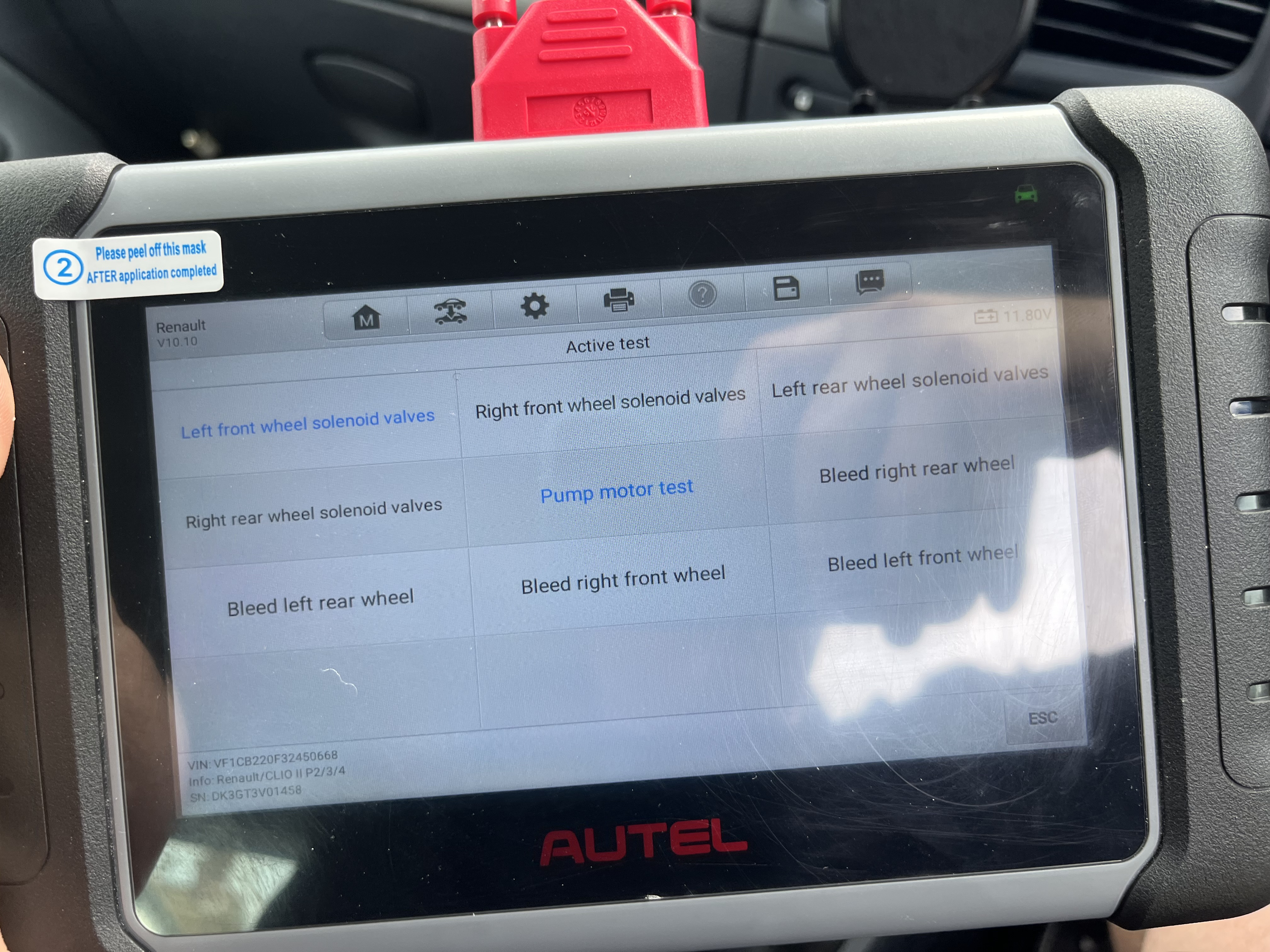

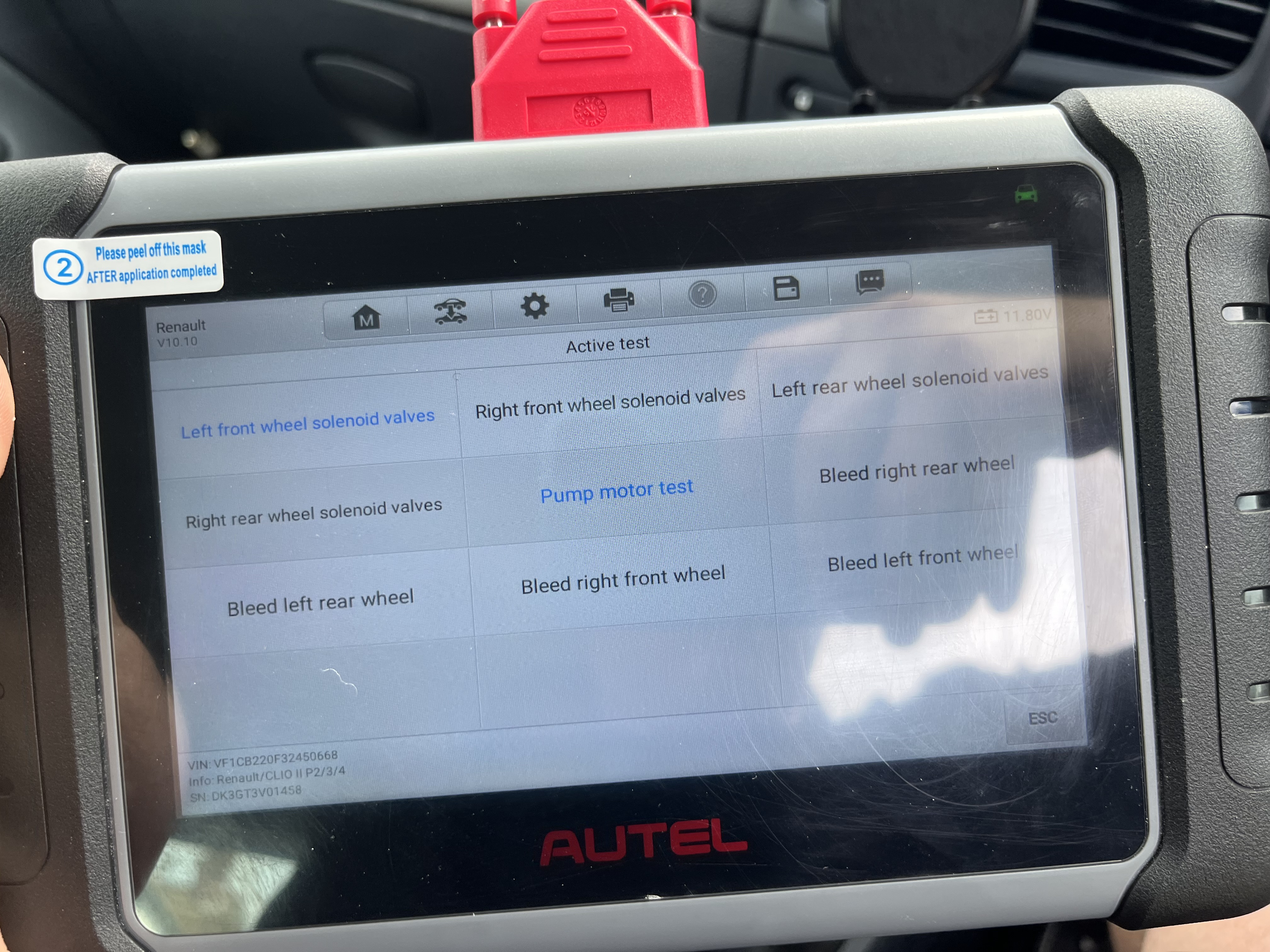

Hi Mate, just seen this and I'm having an issue with my Autel 808s connecting to my Clio 182's! When on the diagnostics page, the only Renault selections are the Trafic and Master vans! It also fails to decode the Vin when searched for automatically.... Did you have nay issues getting Clio mk2's to be available on Diag?
Yes it won't work. The ABS pump bleed function is not available on anything other than the Renault dealer diag system [CLIP] or RS Tuner, the mapping software. I went and bought RS Tuner to do it. It was a complete pain as I wasted so much time to discover that.
Ah okay! Best get this Autel returned then :ROFLMAO: My clios been off the road now for about a month with this and it has a road trip in 4 weeks...... Just bought the RStuner from fastchip now.... Assume its a pretty simple procedure with their software?
I done an abs bleed on my autel a few weeks ago, from memory an mk900?
hmmm strange... It can find Clio 2 when on the diagnostics page fine and decode the VIN but on the service page it refuses to decode VIN and the manual selection only shows vans.... I have checked its fully updated with all Renault updates and it is! So i was at a loss with it tbh
I am running Renault V10.10, what version do you have on yours?
Autel are advising that each wheel needs to be selected in turn and that will perform the ABS bleed.. is this the same for you @Davyboy888? I was expecting it to be a single programme that ran it through in turn
OK... maybe they've updated it since I last checked in 2024 ?
