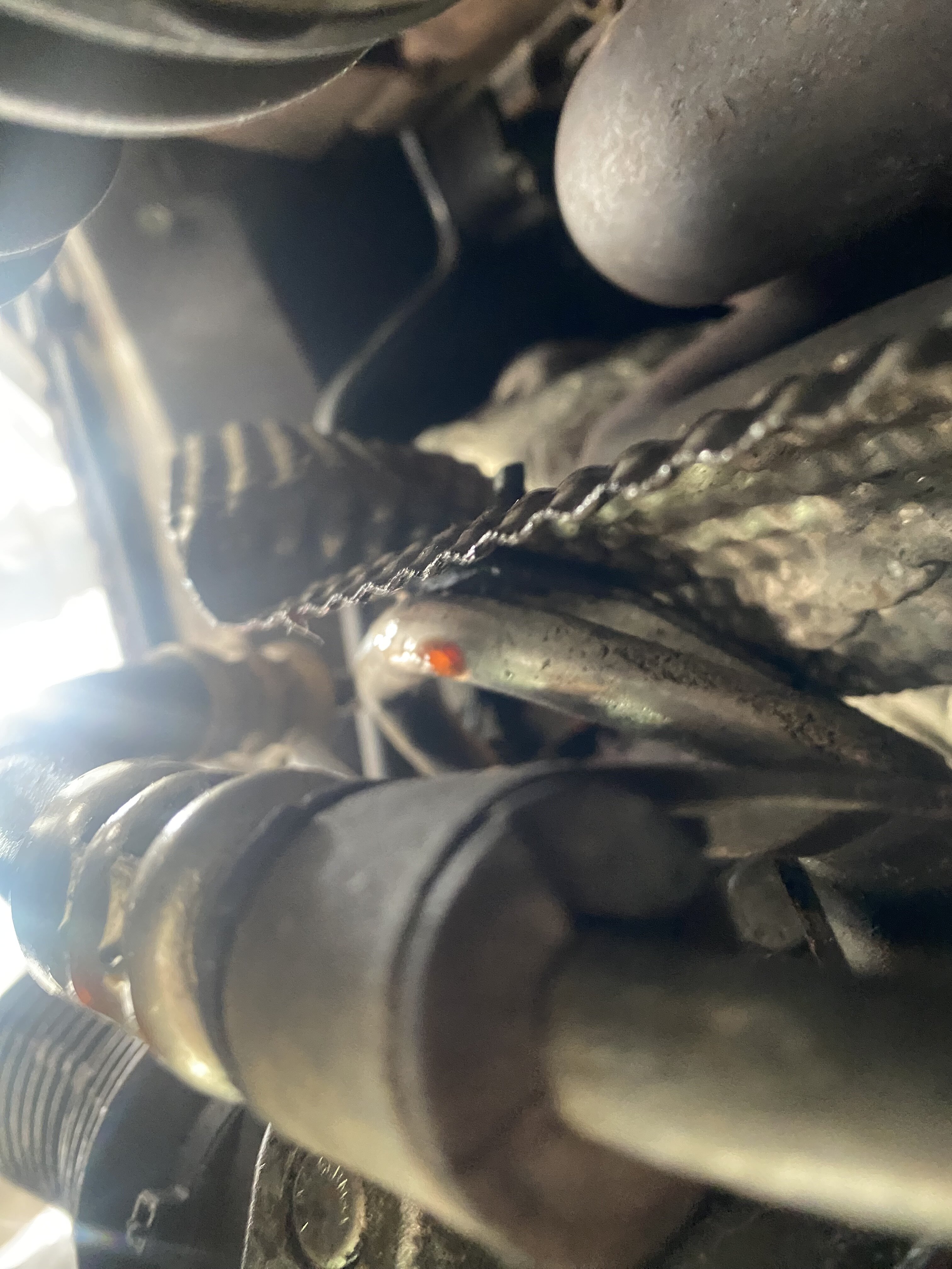

  clio 172
Lost all fluid, where should I look first? What is the most common failure?
Any help will be welcomed

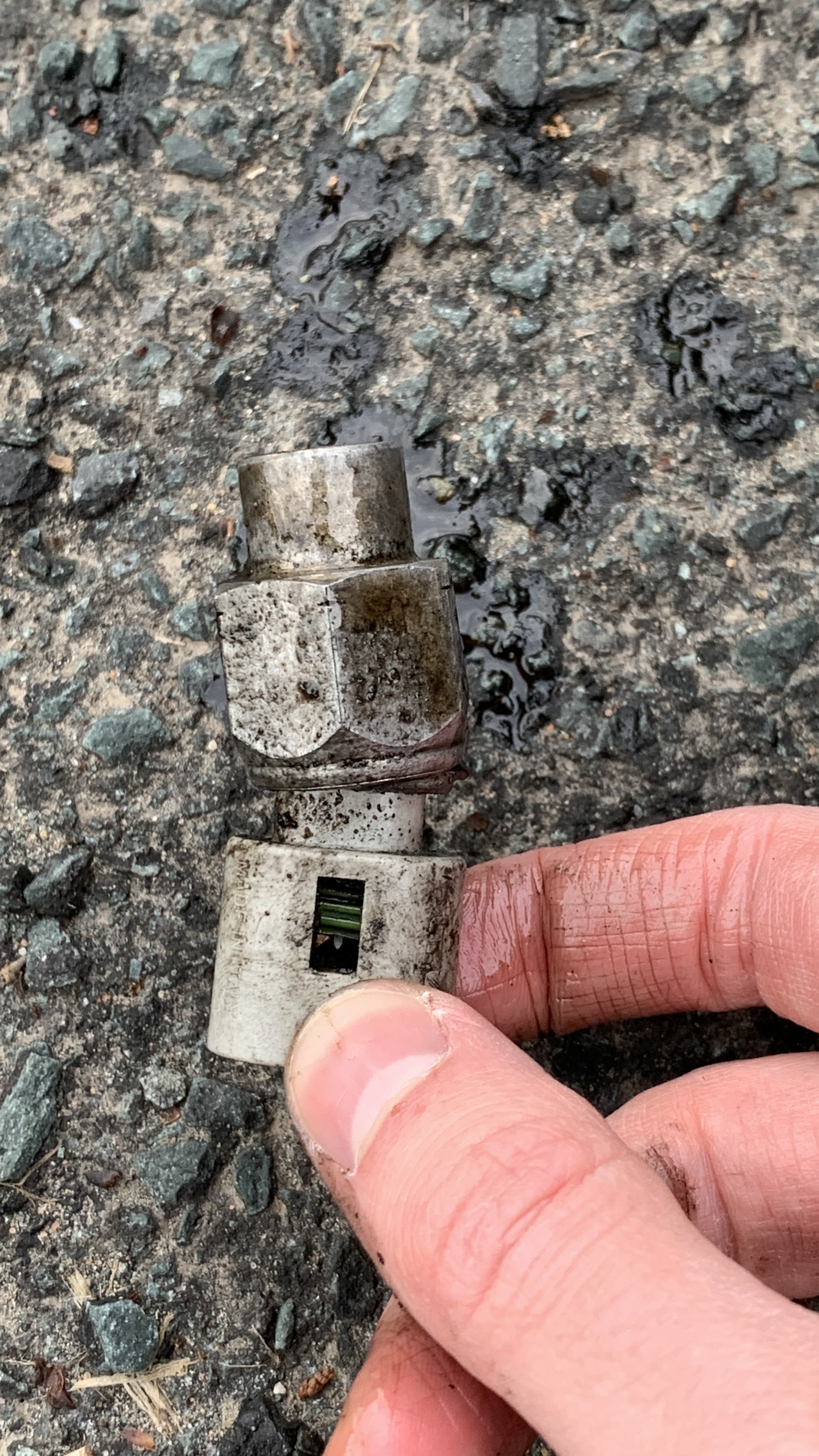

Check the sensor down at the front of the engine. Mine had split and was leaking from there:
Matt Cup
  Leon Cupra
As above, that failed in mine on my first 172 Cup.

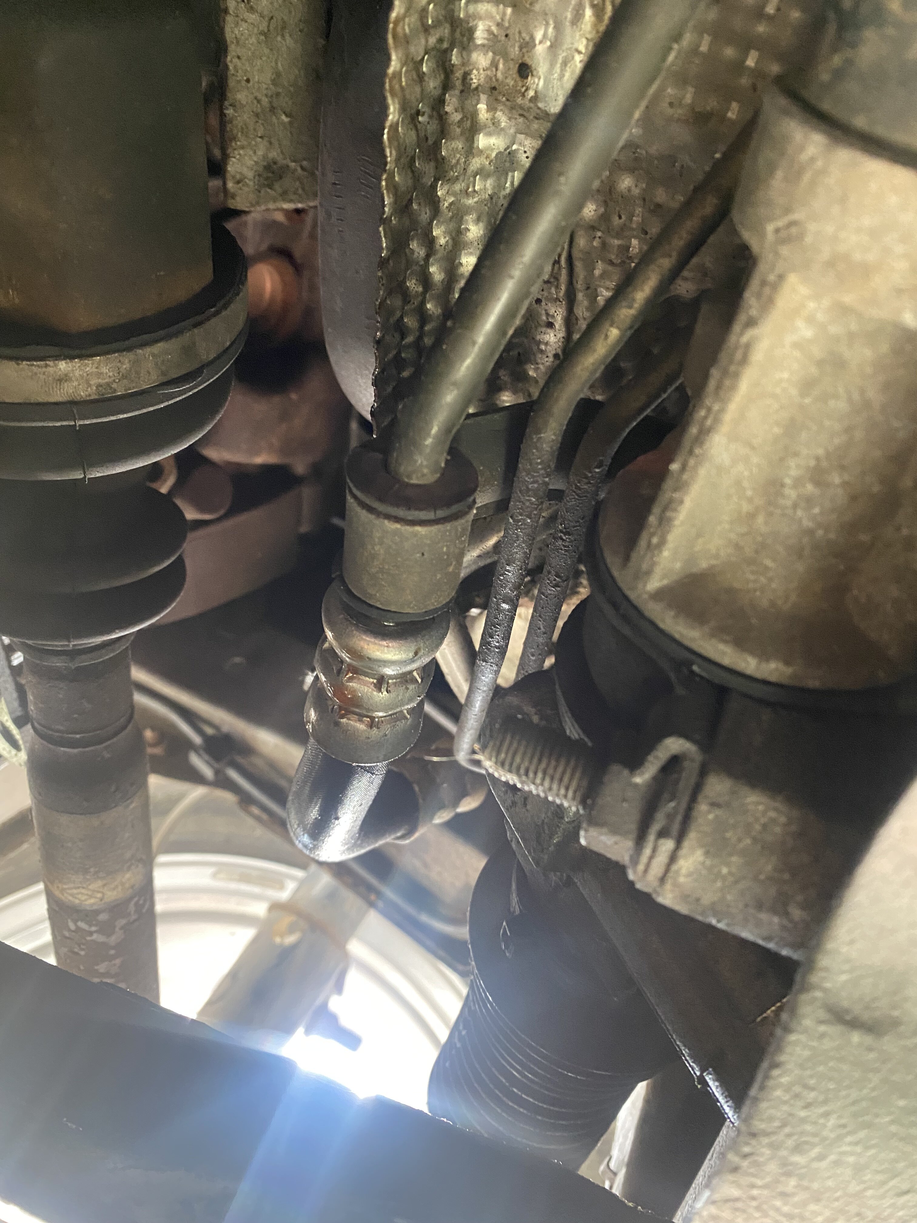

However my second failed on the low pressure line to the rack. I feared it was the high pressure at first as they are NLA but fortunately it wasn’t.
