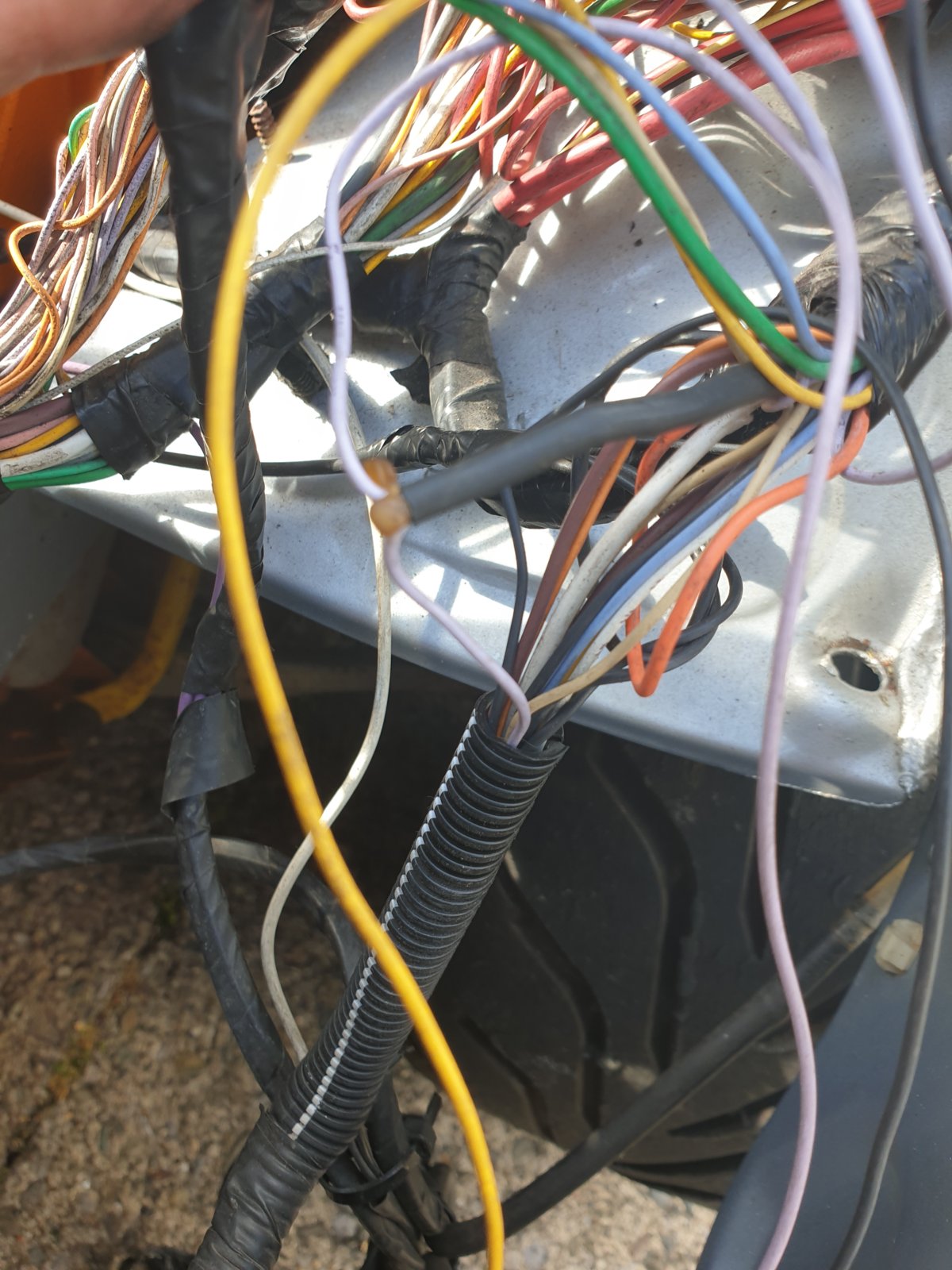

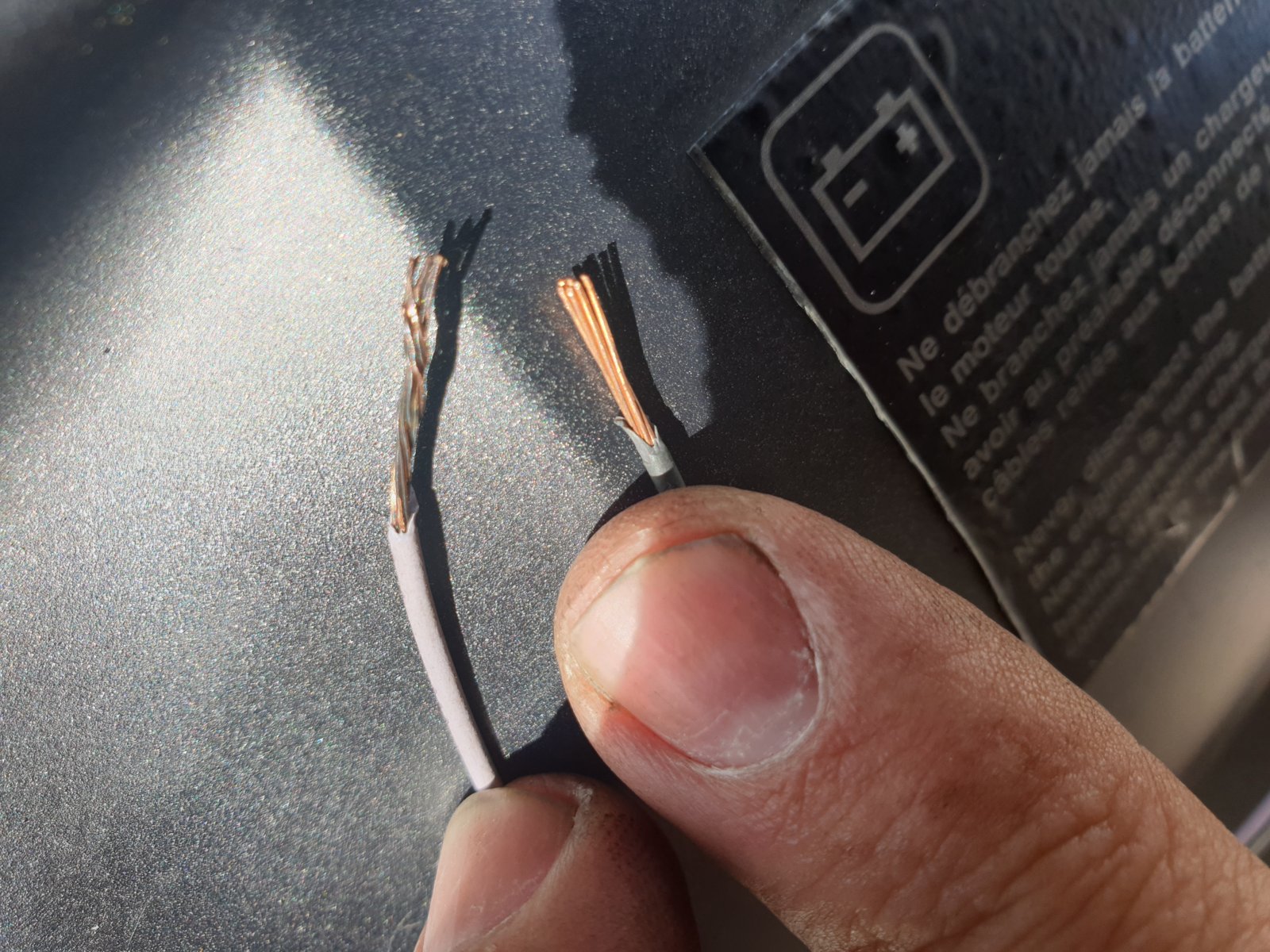

I did try soldering my side repeater holder and loom to the violet cables as the original copper looked black but still no joy

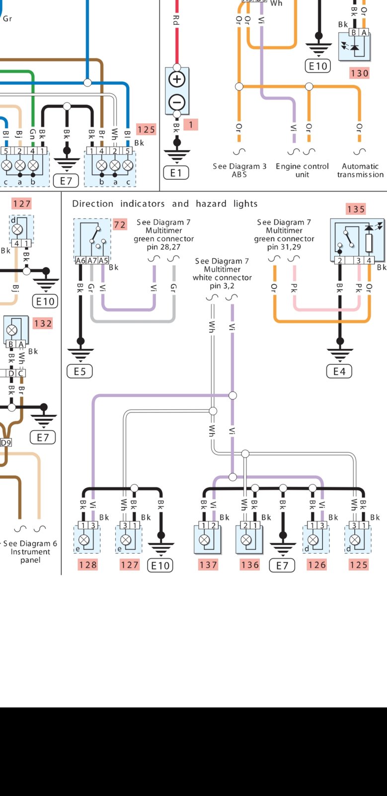

I will have to check them , just dont understand why the front headlight indicator is working

I'm not to clued up how it's all wired but have you checked ind positive with a multimeter and use the body as an earth?

Yeah everything else works just not the side repeater. No I will have to dig it out and check , I just tried soldering it onto another violet quickly to see, looks like something has been done in the past unless them violets are usually like that ha
