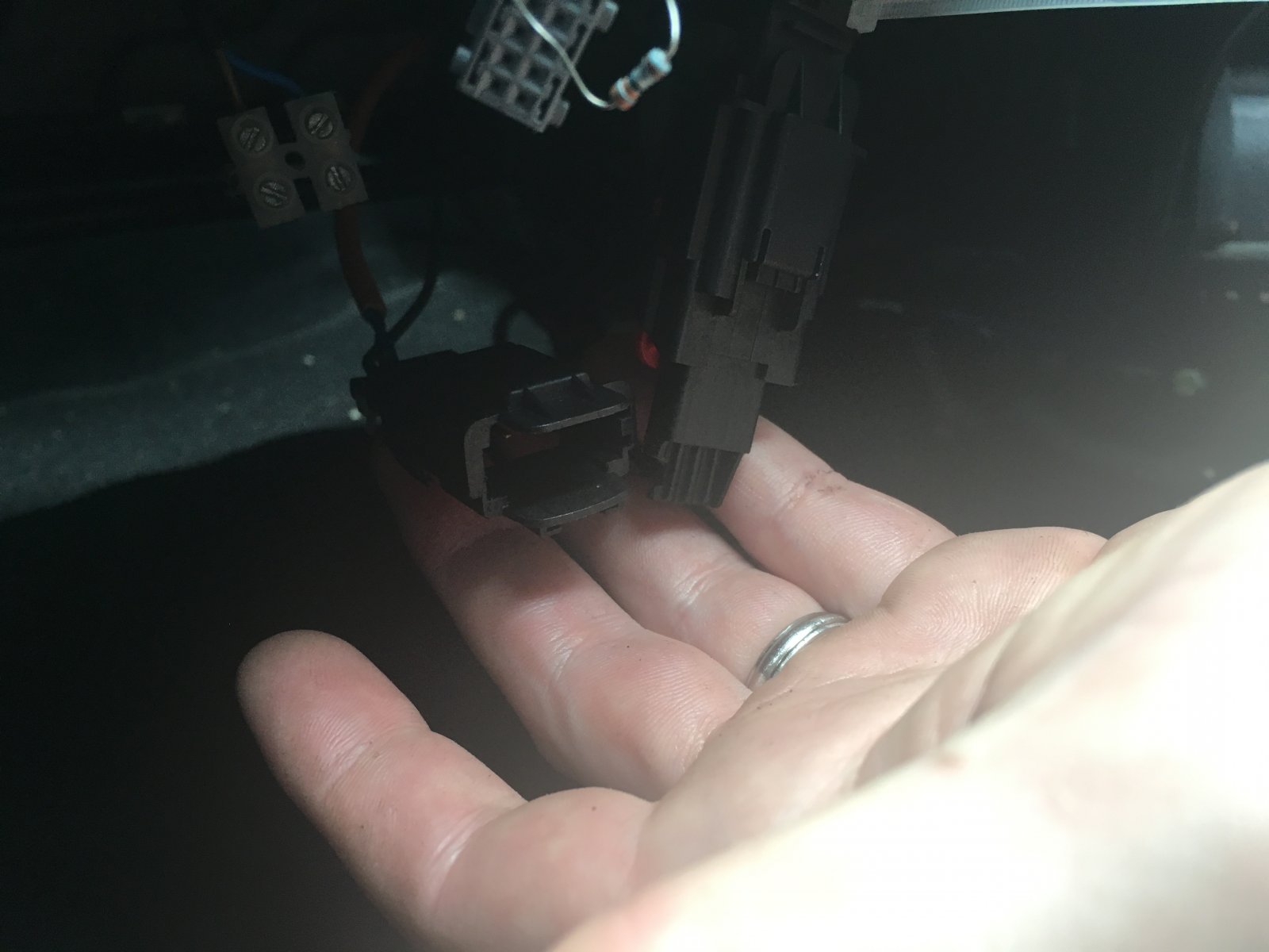

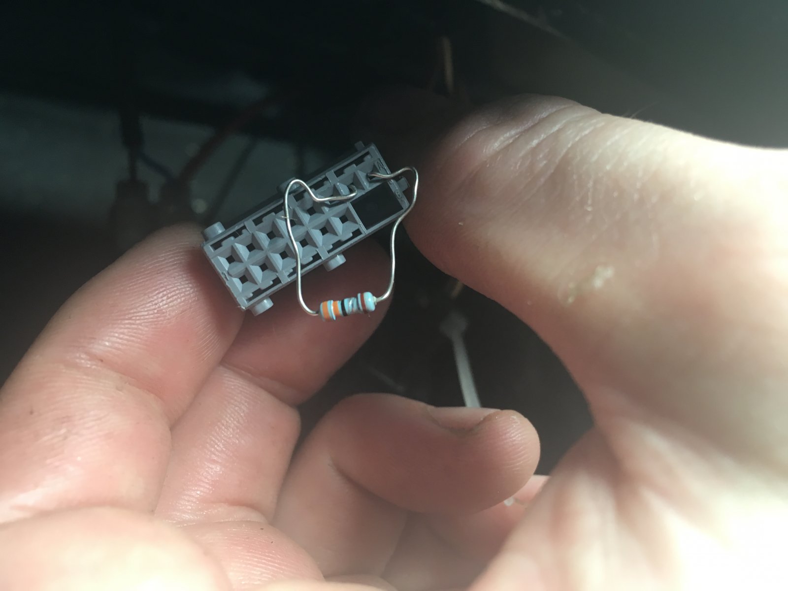

been struggling with this issue this week as it failed the MOT, ive looked on the forums and read posts but still not sorted , I put a 3.3 resister on and the light was still on
im also unsure what to do with this as the sockets don't seem to fit together very well! the car is a 172 cup but the prev owner had the 172 half leather installed

The other plugs coming from the seats are for the airbags in the half leather (cups didnt have seat airbags so ignore them)
Passenger side seat, you need to connect two wires together for the seat pretensioner. Also check the side airbag sensor wiring is ok and plugged in (little square box on the sill under the seat.)
Drivers side 6 wires. Two for seat position sensor, two for pretensioner like the passenger side, and two for the seat belt not fastened warning. Again check the side impact sensor wiring and plug.
Assuming the wiring hasnt been chopped to bits, make sure they are all connected up and ignore the other airbag plugs coming from the seat. Its the plugs you've put the resistor in your looking to wire properly
If its a cup the air bag ecu will not have seats coded in as the std ones dont have air bags. The fault lies else where
Pull the radishes* out and get it plugged in with clip and see what faults it brings up and take it from there.
