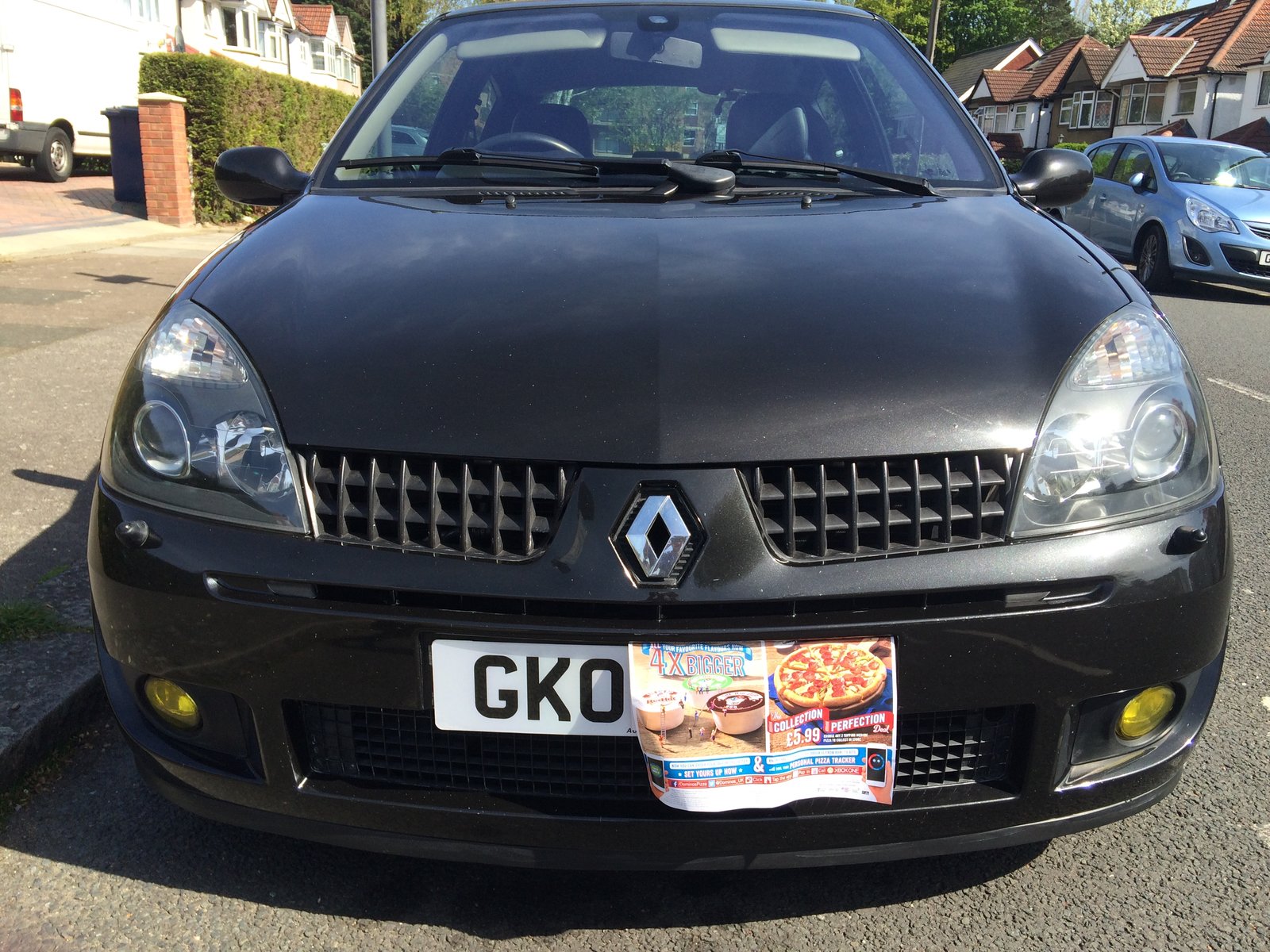

Hello all,
The passenger footwell is soaked after the last 24hrs of rain. I will be taking off the cowling/skuttle to clean any debri out of the waste pipe at some point very soon.
