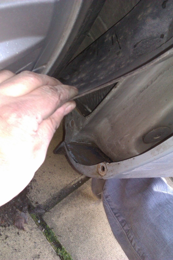

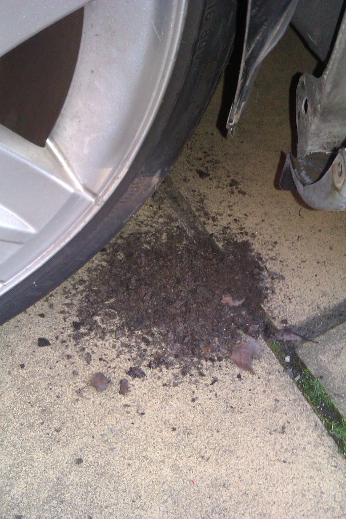

Anyway I found a guide on here saying to unclog the crap from under the front wheel arches; as this is like a gutter - where the rain water passes through - so i did this.
Got all the shite out. I then poured some water from the top of the window - to make sure that it passed through ok, and pured out onto the floor from the wheel arch (as the guide told me to do this)
So ive done that (on both sides), and that seems to be ok now.
