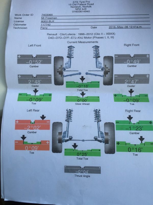

My 172 has been pulling to the left for quite a while. I took it to get its alignment checked and they made some changes to the front set up of the car.
However after getting it back and driving it the wheel has to be slightly off centre to the right in order to stay straight on the road.
They informed me that the l/h rear wheel has a camber issue and this could be leading to the car pulling left.
Question therefore is how can I sort this and what could have/could be causing this issue.
I've attached a copy of the alignment results
