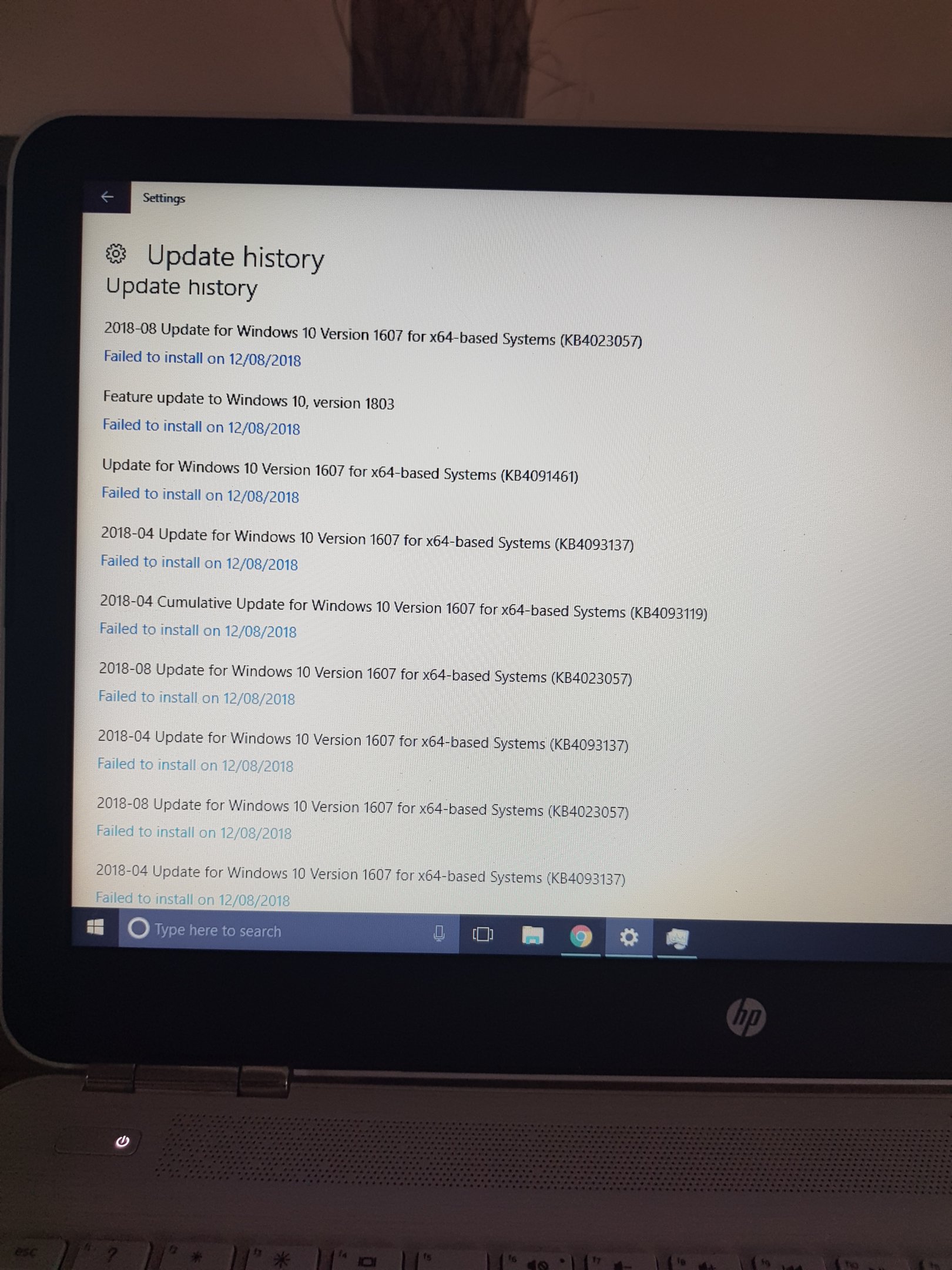

Just to add, I have downloaded all the window update files and every one of them has failed to install. Wtf is that all about? Fml lol

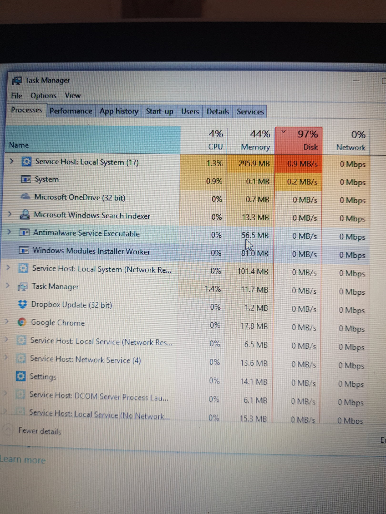

This is while it is downloading updates, nothing else is open.
You're going to have to see what's reading/writing and see what services are running.
Open your TaskManager and see what Processes are running above 05 CPU Levels.

How full is the disk? When updates fail to install you should get an error code you can google to tell you why.

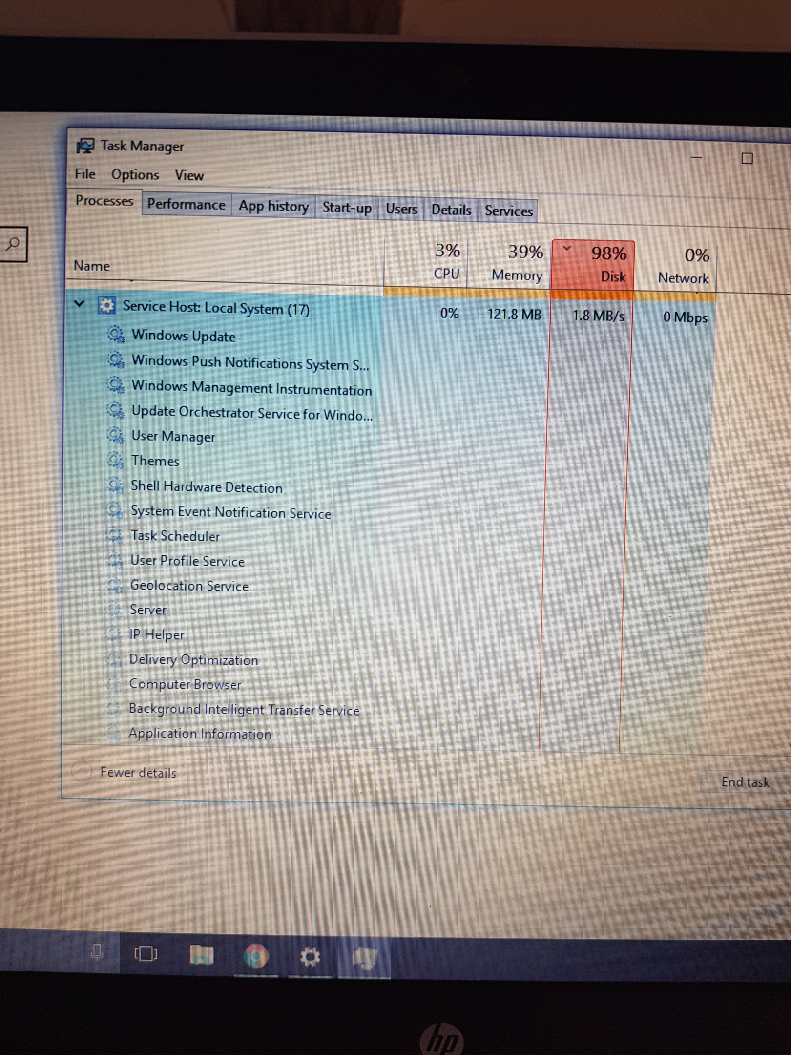

Below is a pic of I think what you were asking for?
There is literally just photos on here, about 650gb left on the hdd.
