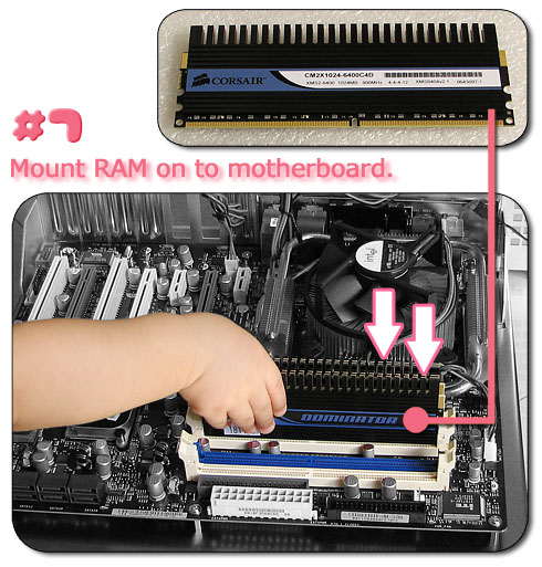

These are your RAM modules

Darren S
Like a baby's arm IIRC. WTF.
Babies building PCs?
Teaching them early - nowt wrong with that.
They need to learn Man-Spec-Machines anyway and not believe that the only progression from a Leapfrog device is twiddling their thumbs on a console.
