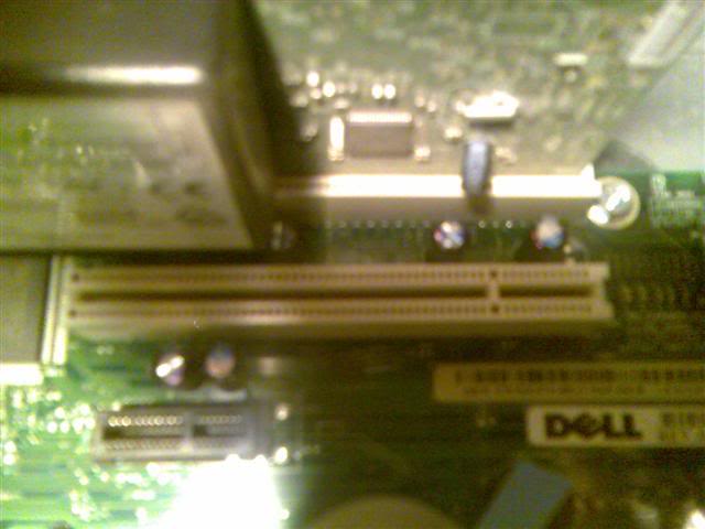

Im a right in saying this is a standard PCI slot rather than a PCI-Express..
(sorry about shite quality, phone camera)
Im after a decent graphics card, so i can play rainbow 6 lockdown, pci cards seem to be quite rare, where can i get one? thanks:)
Yer thats a PCI, you cant get any good cards on PCI iirc. Dells are a biatch to upgrade
Moral of the story.. Don't buy a budget Dell then realise you actually want to play games on it.
I just got some new Ram for my acer laptop its upto 704mb now runs the games ok, well seems to but my graph card is bit s**t so the graphics arnt as good as the box lol. Can you get new cards for laptops
Is that not a type of PCI-E slot to the left of the Dell sticker?
That's an AMR slot.
As for upgrading, no hope. Also, don't get a new motherboard for it - it'll go bang. Dell use proprietary power connectors and you'll cook it - I'm afraid you've just learnt the hard way that you buy cheap, you buy twice.
PCI Cards stop around the Radeon 9000 series (and the low spec ones at that!) and the GeForce 5000 series, again low spec only. I struggle to believe though that the machine doesn't have an AGP slot - I've got a SFF Dell GX260 which does!
