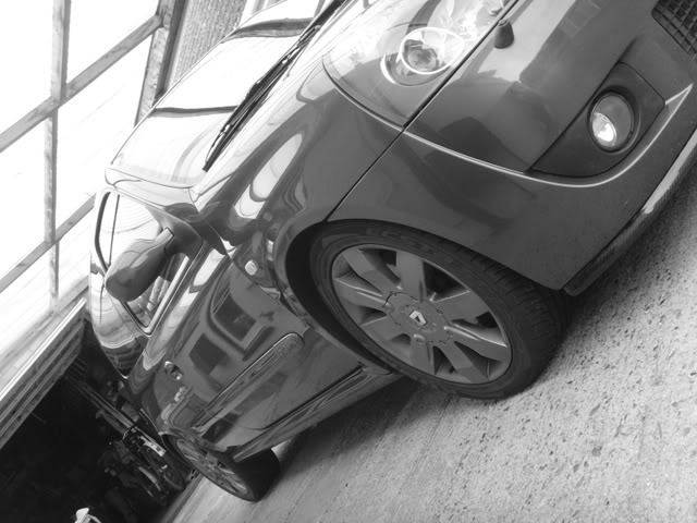

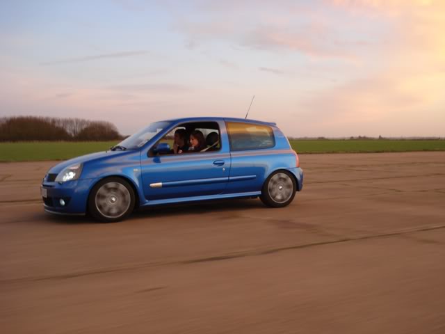

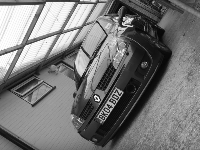

No the Best Pics but this is after I had it Paoperly Set Up
Before it was Set Up but similar height

I think Its Pretty Much on Par with Christopher and I'm suer he says his is -60mm Rear and -70mm Front but don't quote me on it, I'd suggest just trial and error, Wind it down then a 5 Minute Blast and then take a look and adjust if needed

That in my opinion and showin it to the lad that did my AST's said its slightly too low at the back. But if hes happy with it then thats fine
