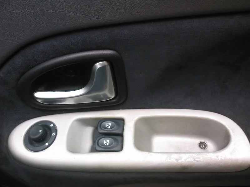

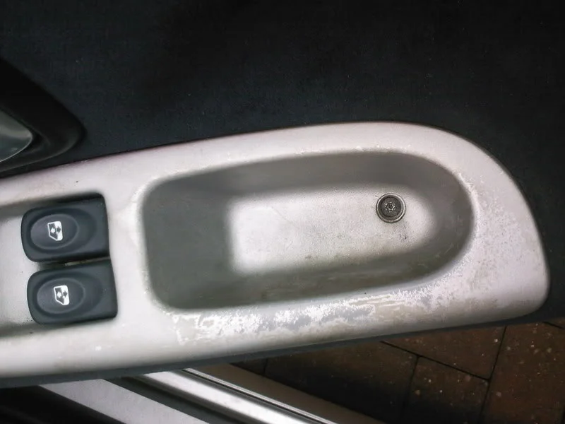

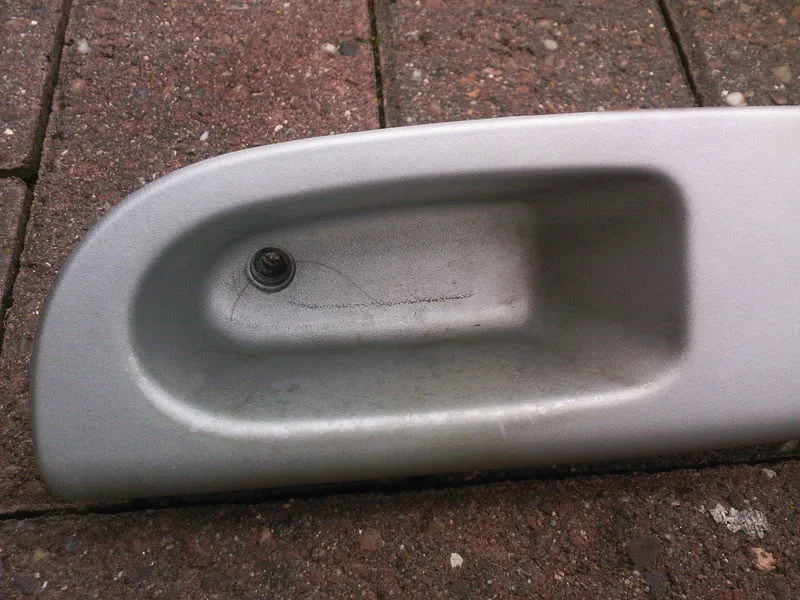

This is what i started with
As you can see, a set of very tarnished and for use of a better word nasty looking grab handles.

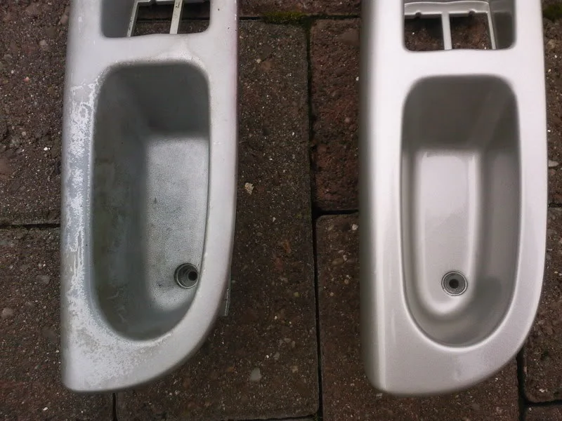

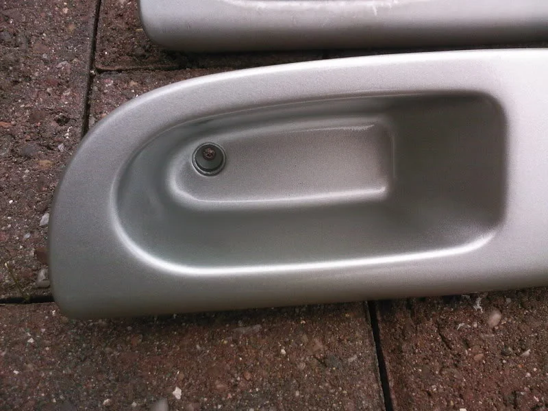

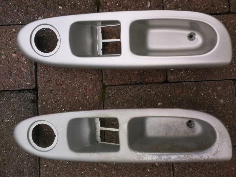

The final result.
Before and after type shot.

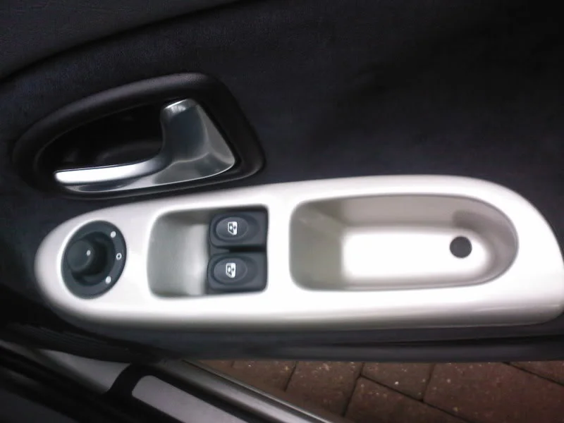

And all fitted back on to the car.

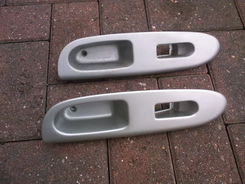

If anyone is interested i have a spare set that i am just in the process of doing, they are a nice addition to the ph 1 172 as the originals are terrible once they start to wear.
