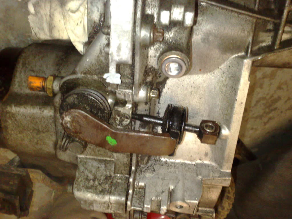

im putting a PH1 gearbox onto my PH2 172 but when i had a quick look at my box tonight i noticed the gear linkage on the bottom of the box is different to my previous box! before it was a pole on the bottom of the box which inserted into the linkage pole on the bottom of the lever. now the PH1 box on the bottom is different. its more of a hole then a pole lol. do i need to get the linkage rod from a PH1 or do i upgrade my PH2???
this is whats on the new box i have.;

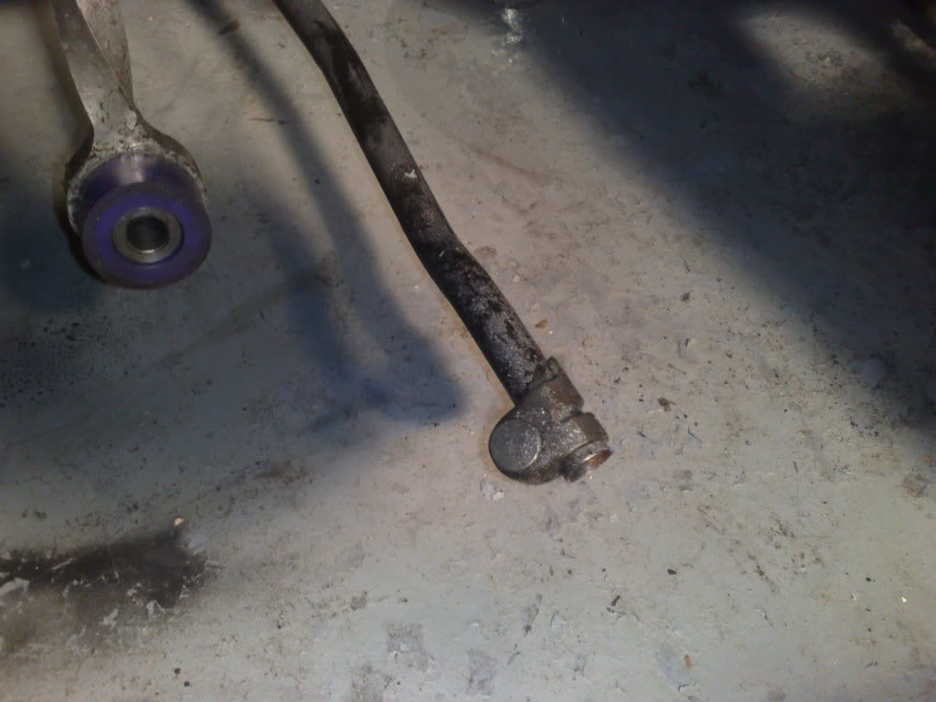

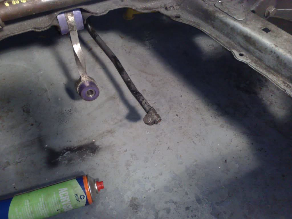

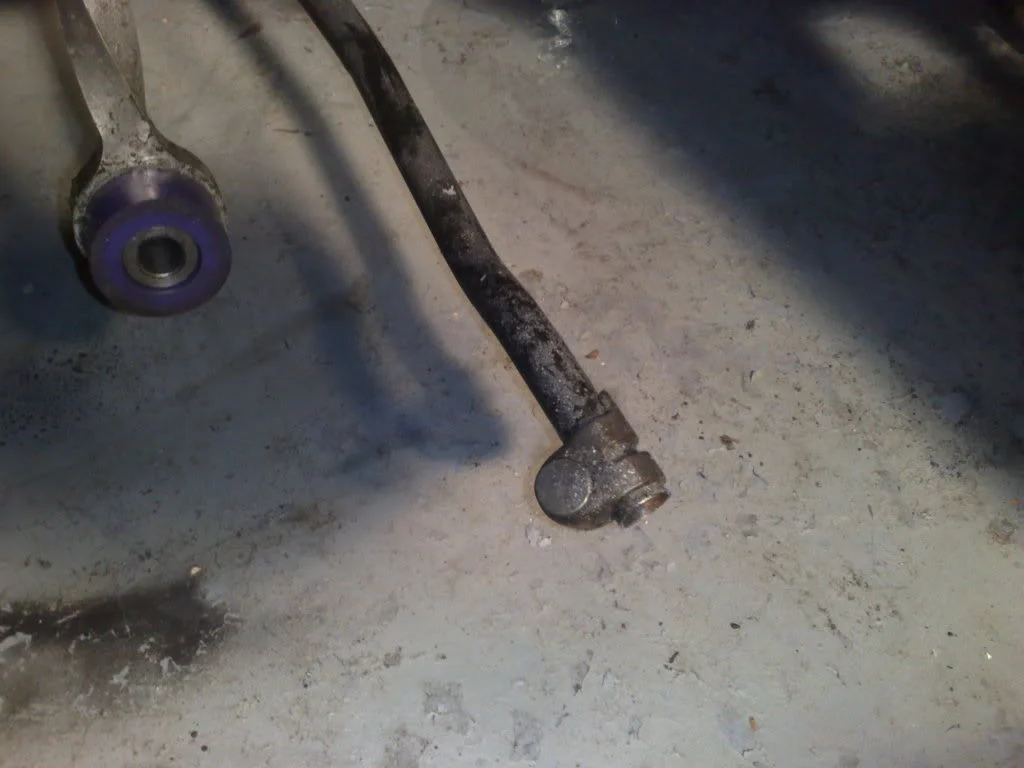

but on my car i have this selector rod;
on the bottom of the box, doesnt seem to be anything missing!! can anyone confirm this. many thanks mark
on the old box, was like a black pole that came of bottom of box!!

Your missing the link in between the two. Like an eyelet looking thing.
This is what your meant to unbolt so you dont have to piss around adjusting the linkage.
Its held on under the rubber boot on the bottom of the box with a 13mm bolt.

its just missing the rod joint wotsit with the gaitor, no biggie, when its come from the scrappy or wherever they just unbolted there
