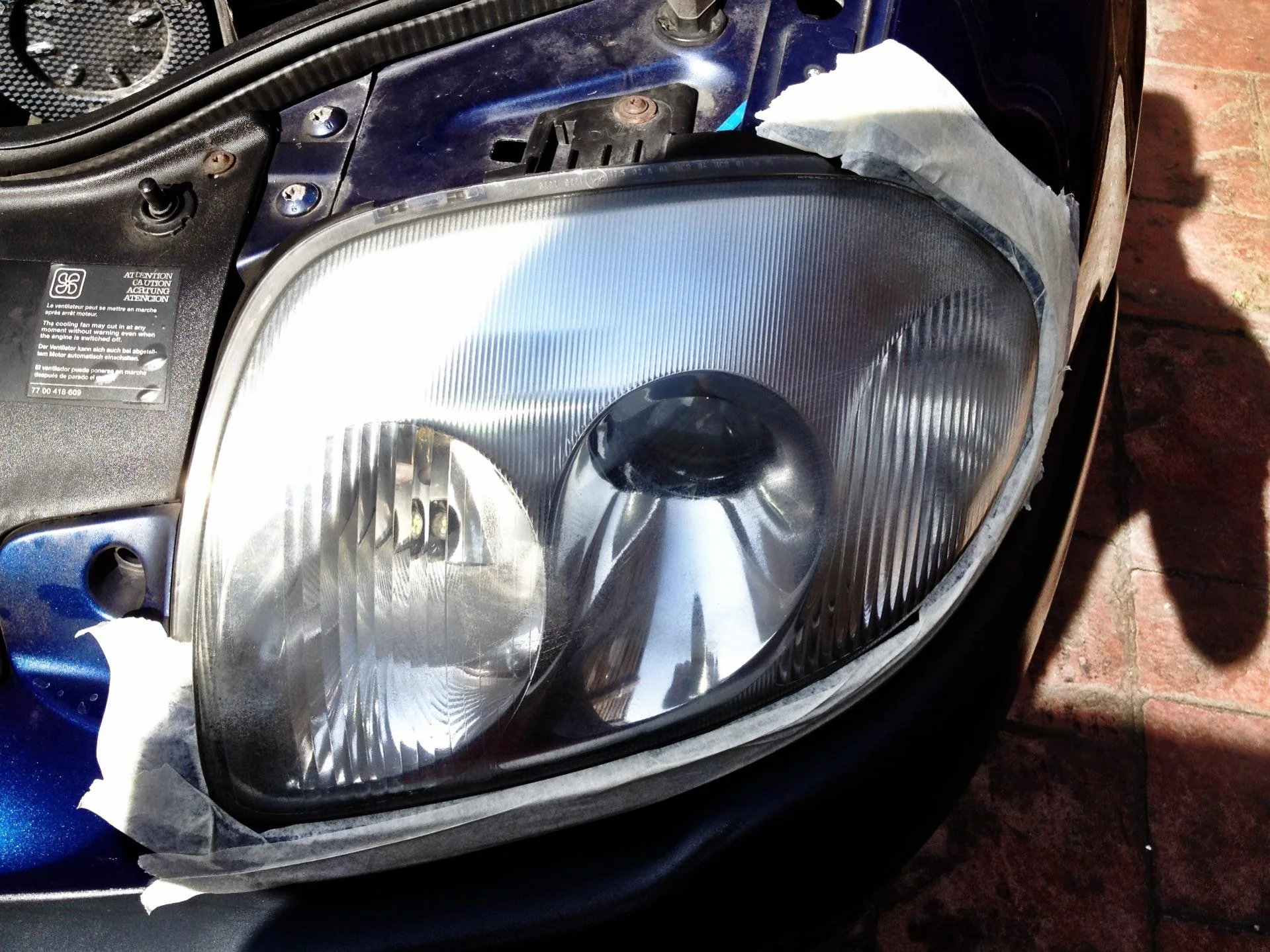

i must say my headlights wernt to bad but, were starting to go, plus had some bad scratches on them, i did it all by hand, no fancy machines. took me about 1 hour per headlight. :)
as you can see not to bad but some bad scratches

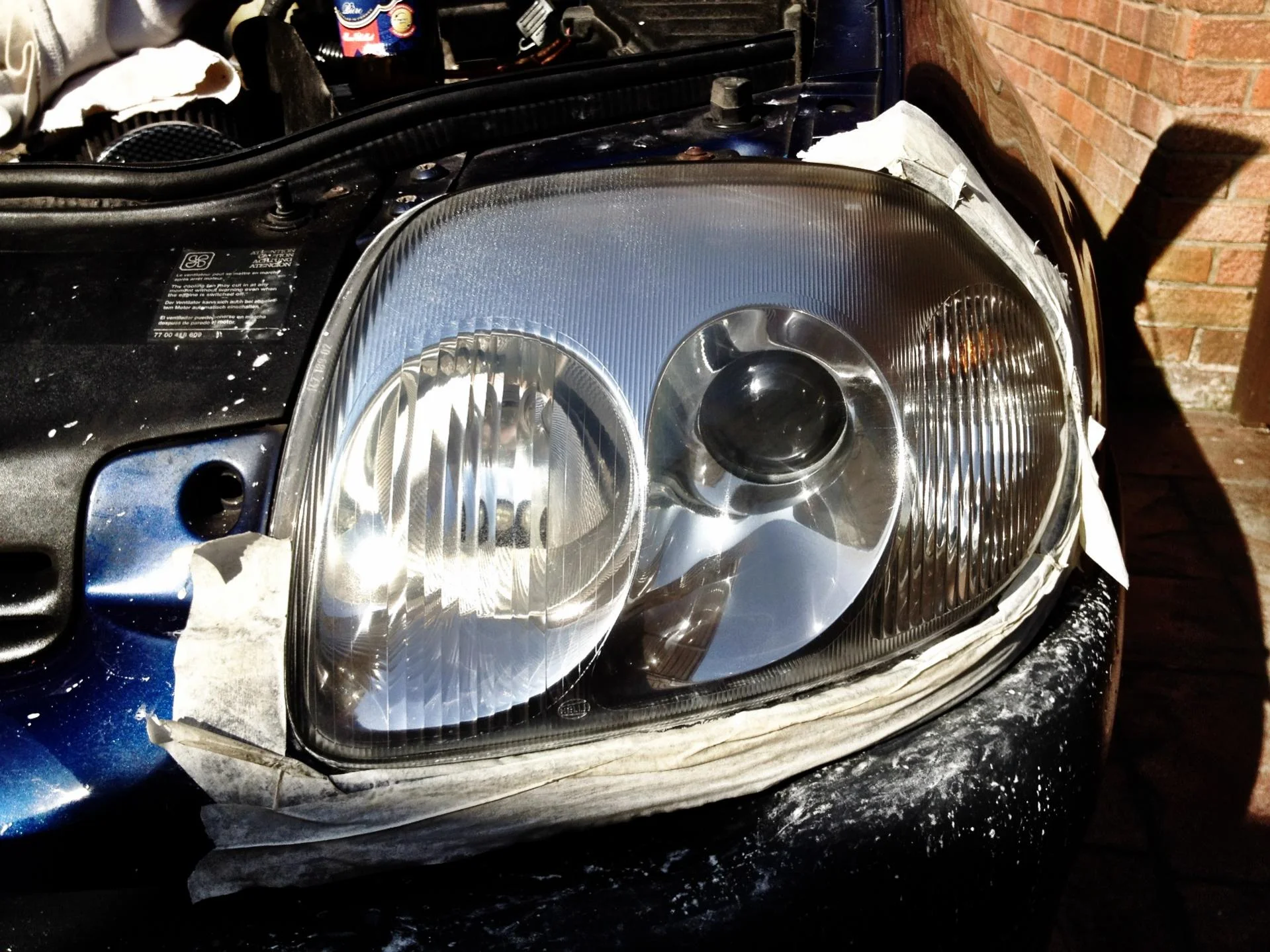

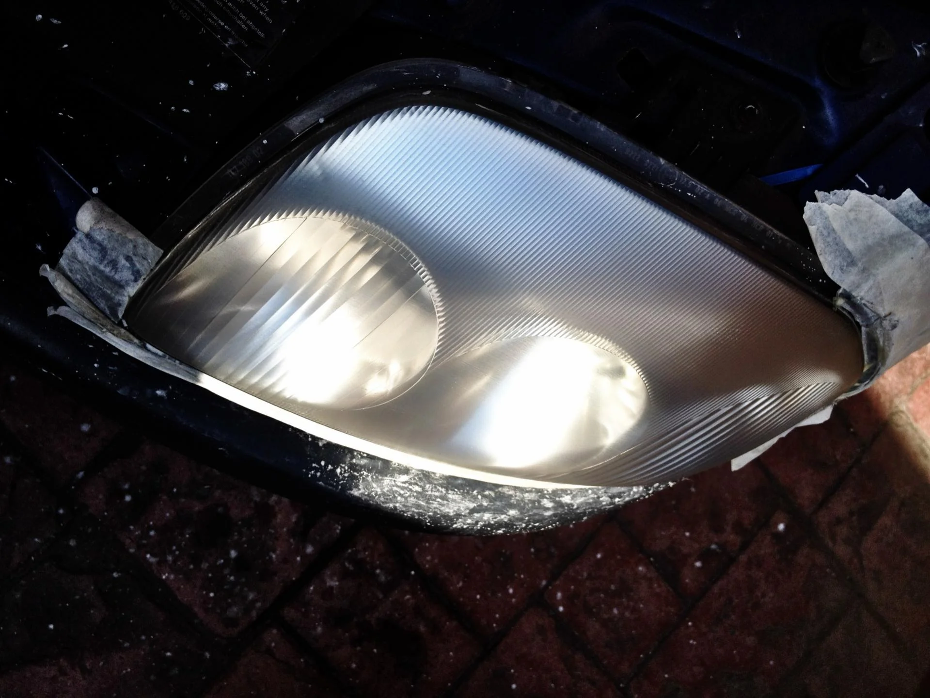

results after, 1500 wad and 2000 wad, then after the t-cut
Final results after the super resin wax :)
It was alot of hard work but well worth it! the one thing i would say tho is dont do it on a super hot day u'll sweat buckets lol!
There still not perfect but im happy with them :)
