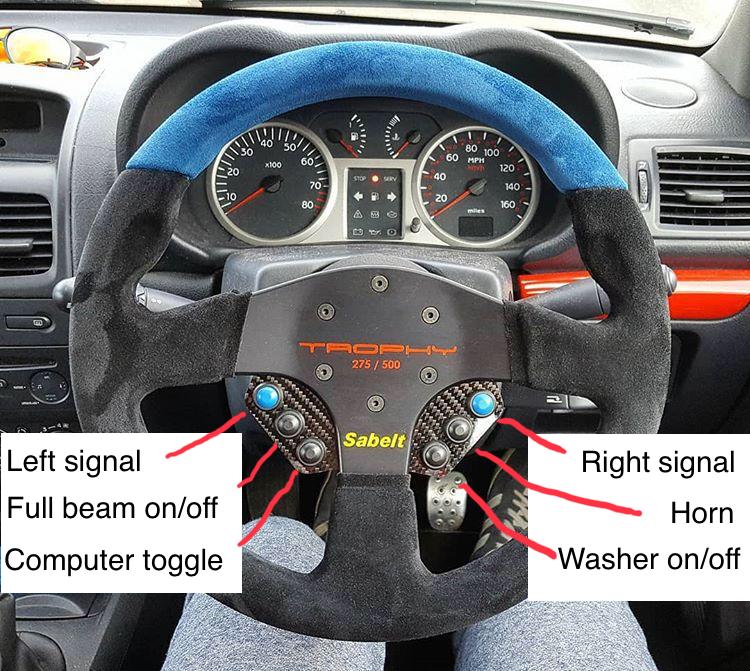

I was going to go down the PH1 route as the Sabelt wheel doesn’t have a horn button unless I add a button plate. Which if I do I’ll want to go mad and remove both stalks and have everything on 6 buttons...
Something like this below but know it will be a wiring nightmare also I’d want it to be quick release too
Just think the PH1 route would be much much easier

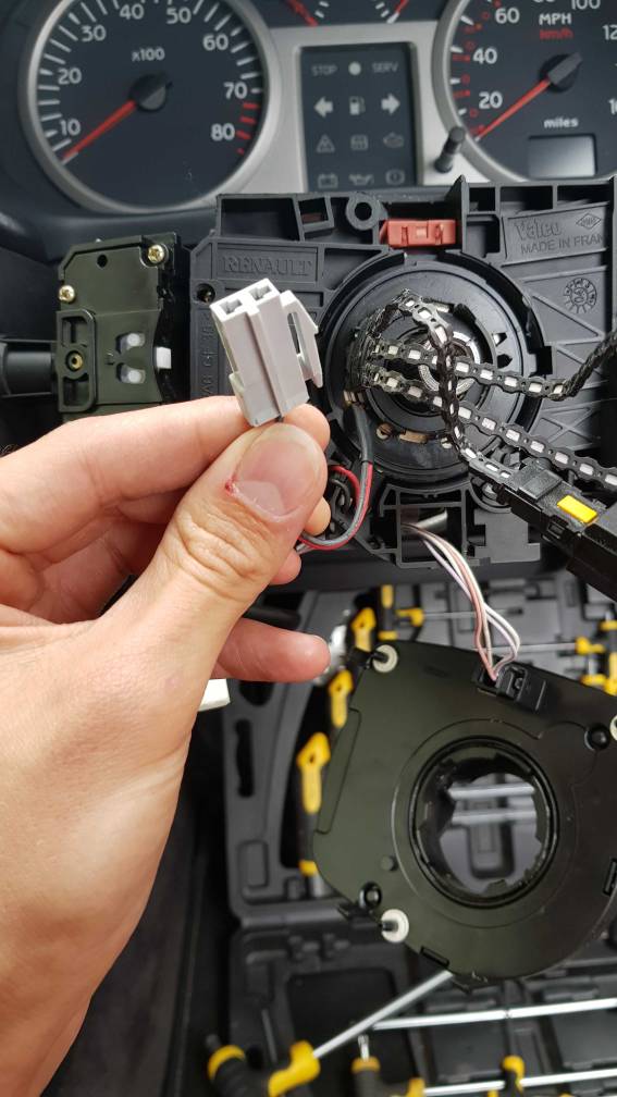

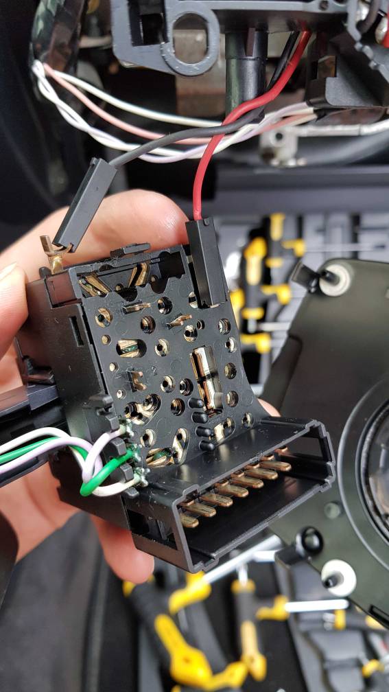

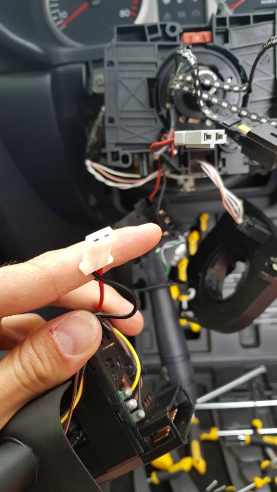

Just to bump this thread, I finally sourced a Ph1 indicator stalk with horn push button and fitted it on the weekend only to find out the horn still doesn't work (but all of the other functions on the stalk do). Any ideas where to look next?
There’s a single wire that connects to the back of the stalk at the bottom iirc. Just plugs straight onto a spade connector, this is easy to miss.
There's two wires on the back / underside of the stalk, one positive one negative, both spade connectors. I have plugged both of these in. As far as I can tell they are the wires which go to the two horn connectors in the wheel itself but need to get a multimeter on it to confirm.
