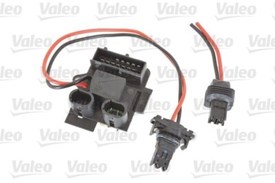

I reckon your resistor pack may have gone under the scuttle on drivers side not too bad to get to and cheaper than fan motor, can test the resistance of your old one first
515136 valeo part no. few on eBay goes in here
