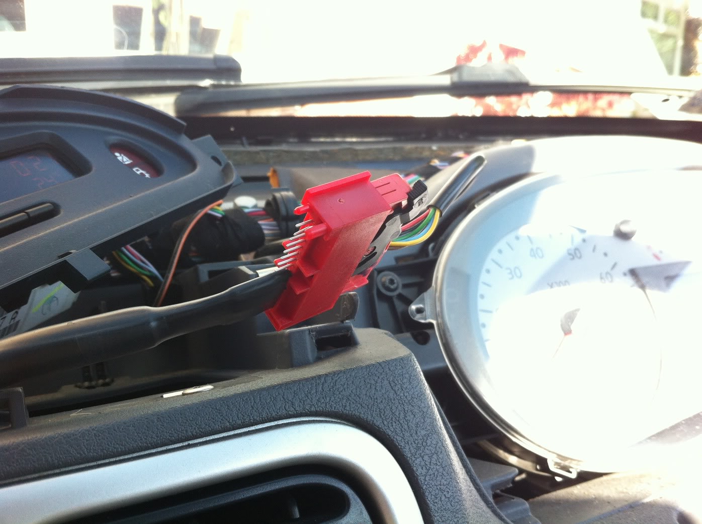

I've attached the Red connector to the other Red connector that was attached to the clock.

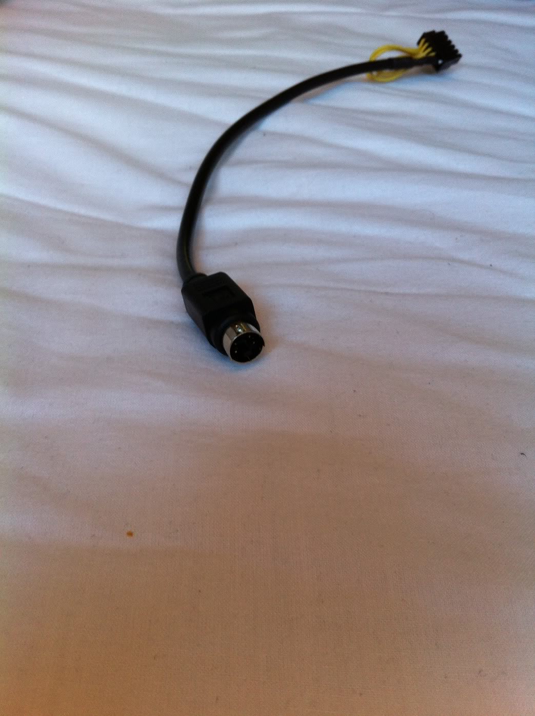

The Kenwood patch lead is actually two, I think it depends on the unit you have...but there's no info I can find. So I opted for this one as there's no PS2 port on my HU.
The other looks like this:

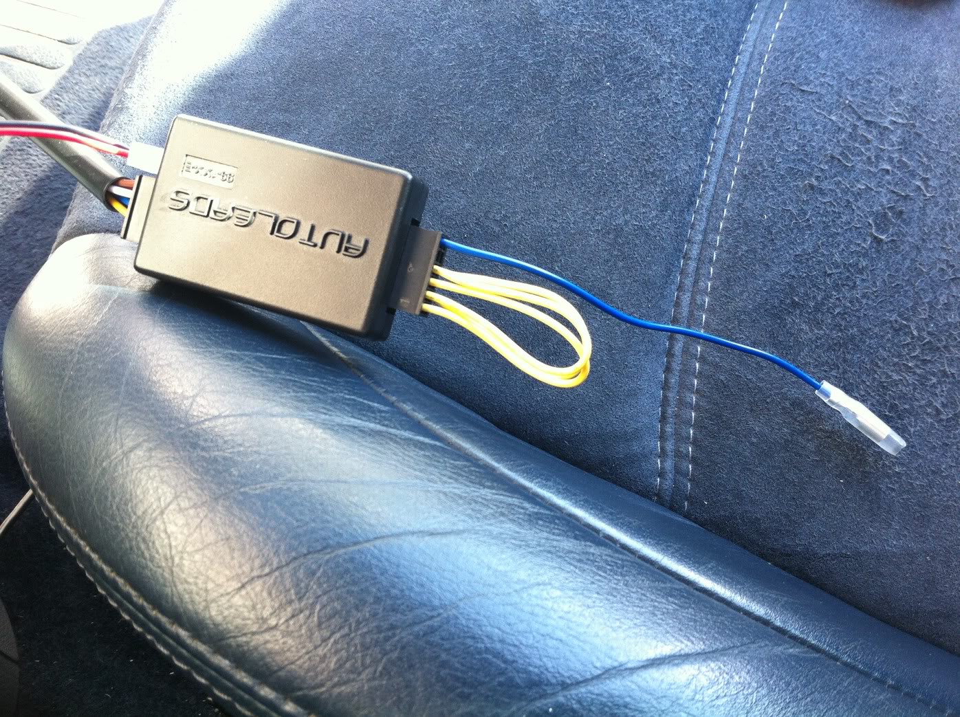

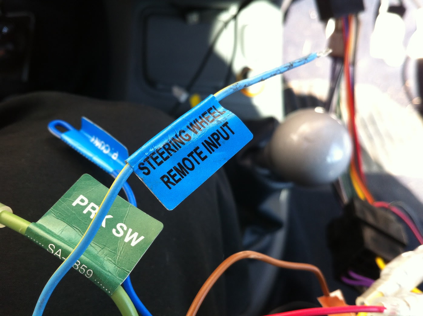

The blue lead above was then connected to the steering wheel remote lead from my HUs ISO block, it did have a male bullet connector crimped on but I removed it after it failed so I could insulate the cable again:

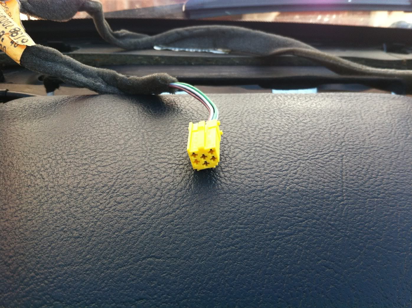

So WTF have I done wrong? :( The original stalk control connector looks like this and is now not connected to anything at this end (the other end of it seems to connect to the Grey connected to the clock and obviously the stalk). The stalk adaptor for my HU connected to this...and worked.

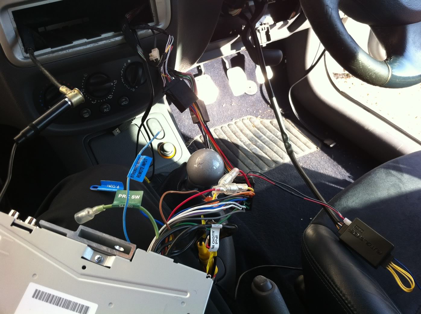

P.S. Here's a lot of cables...
Did you power it on, save a station, turn it off with the patch lead unplugged from the unit? You have to do that, then do it again with it plugged in, or something like that.
The instructions for that will have been in the patch lead box.

Yeah it took me an age to figure out what the instructions were telling me to do lol, plugged it all in afterwards (had to swap permanent and 12v switched cables round as it wouldn't retain memory). May rip it all out and start again tomorrow night...
*Edit - All pictures were taken after I'd tried everything I could think of.

Autoleads have to be done with stereo reset completely to factory if you have had it in for a few days prior-you have the correct unit etc
