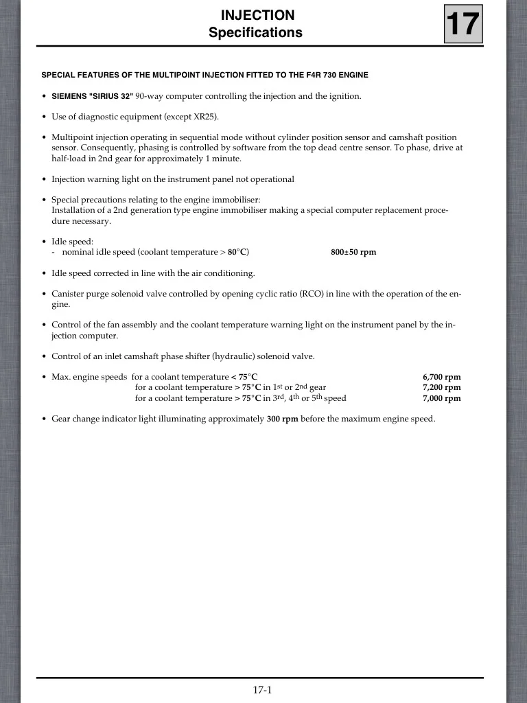

Well i think it is odd that the limit is below the usual cold limit something else must be up or someone has re-programmed the ECU maybe, tbh i have no idea

Ph1 water temp and rev limits
