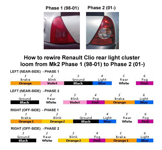

ph2 rear lights into ph1,
Car  172 phase 1
the link provided in the guide is no longer available would someone be able to point me in right direction with regards to changing the wiring around and how its done
Here you go mate
Its really easy. I managed it and it was the first time i'd done anything with electrics.
I cocked up first time around though, my rear fogs come on instead of rear lights, sorted it straight away though and all was good.
Ive just done this yesterday on my Ph1, i was just about to re wire it when i realised there are 3 plastic " pin " type things that i was able to just cut off and the bulb plate on my origional lights fitted on perfectly! it didnt click into place like it should but when you screw the lights back in its a perfect seal :)
^^ this is what ive done, didnt bother doing the rewiring,
might do it soon though, ive got the standard fog dashlight coming on
