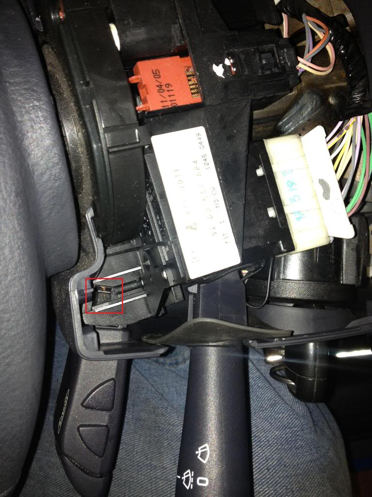

How do you remove it? They're are two torx screws at the back of it but they look as if they just hold it together? Or do they release it?
take top of the steering cowel off and ul see a clip, push that down and the stalk will pull out
If you cant see what i mean il go grab a pic for you
Alright gimmie 5 mins
Edit:
Bit in the red square, push that in with a screw driver or something and the stalk will pop out
Aye, i'll try it later, should it be plugged into the back of the cd player its self then aye? Anything else to check?
