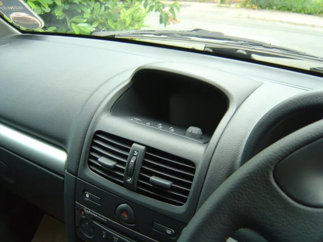

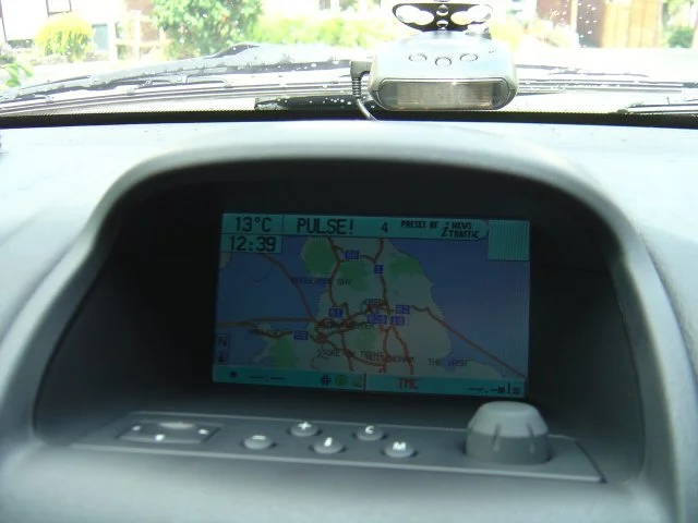

Can you lucky owners please post up a pic of your Renault Sat/Nav unit ?? :)
- it's the one that replaces the std Head-up display in the Clios..
I'm interested in getting one and linking to a good h/u :approve:
Cheers
Trev
Mike @ rentech fitted it to his 172, there are a few pics knocking about on here.
Failing that my dad has it in his 172, but he's at work now, so I can't get a pic, if no one get a pic i'll try & get a few for you.

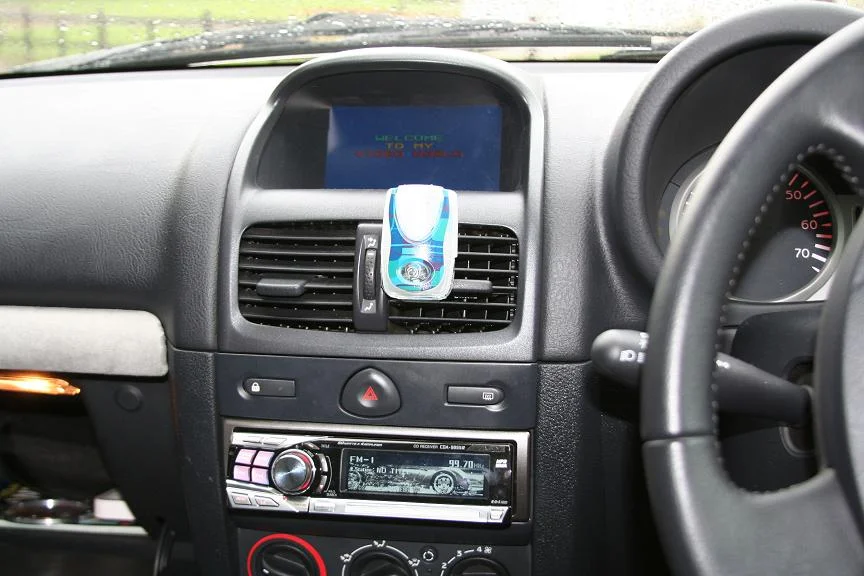

you do not need to buy the sat nav package from renault you can just buy a normal 5.8" screen be it alpine, pioneer or a not well known brand
i went for necvox - crackin wee screen
only tricky thing is that you need to remove the outer plastic which holds the screen together to fit the renault holder for the dash.
now how do u control the screen? 2 things
1. extend the buttons from the tv screen onto a separate, new PCB and mount the buttons infront of the screen like in Liam's first pic. (i wanted to do this but was going to be expensive)
2. extend the infrared light to the same place infront of the screen and just use the remote to operate!
take your gear to a specialist ICE shop like I did - I did not trust myself with ripping apart a brand new sreen!
Once the screen was fitted perfectly I got a necvox tv tuner and slim ps2 and connected them both up to the HU - now, using both AV's in the screen i can play/watch dvd's or watch tv! :D
Ill give anyone advice and the fast way to get this up and running - it is expensive but its factory and professional looking which I think you would all agree! :D

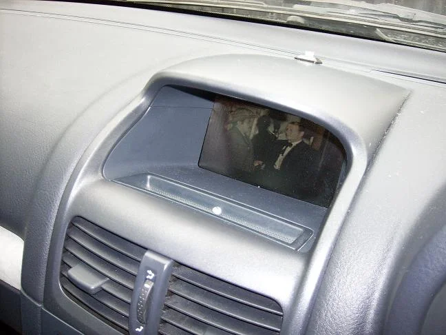

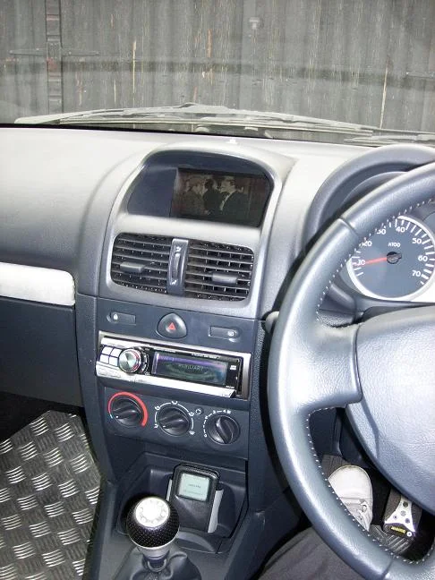

Anyway here are pics of my dash with the infra red LED and necvox screen - tv tuner is on! :D

That looks top-job Boydie! :)
By any chance can you still get your clock/temp on the screen?
I see this thread has created a lot of interest for people getting that done :star:
  2015 Audi S3 Stage 3
no you cant- it bothered me at first but now im not worried
