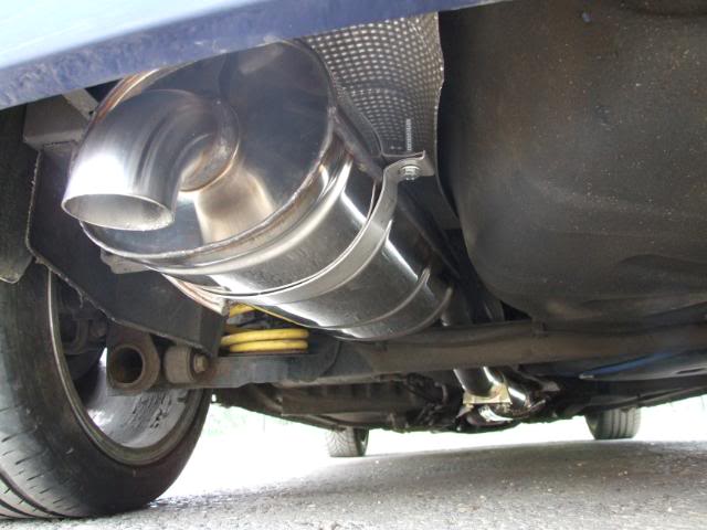

  172 Race Car
My old one, only pic i could find

it'll be hanging low due to the bends in the system pipes in/out of the silencer box and the height at which those pipes are welded to the box. if you look at the OE system, the pipes are welded to the bottom of the box and the silencer rises up, into the exhaust tunnel.
it's only a cosmetic concern unless your car is particularly low, imo
