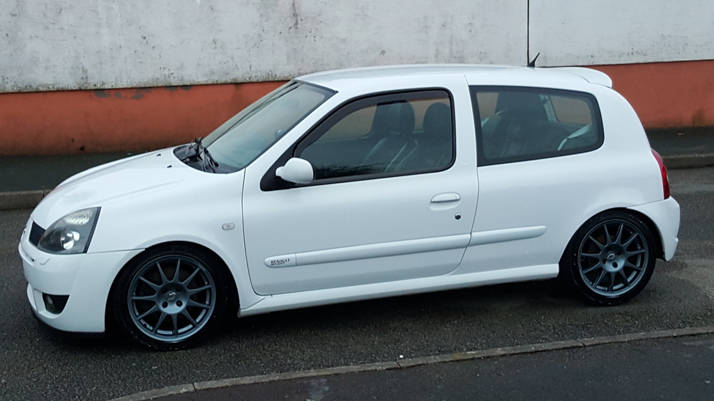

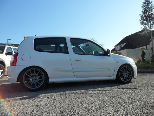

Here's mine when I had just springs and no adjusters on the rear - 195/45/16 tyres

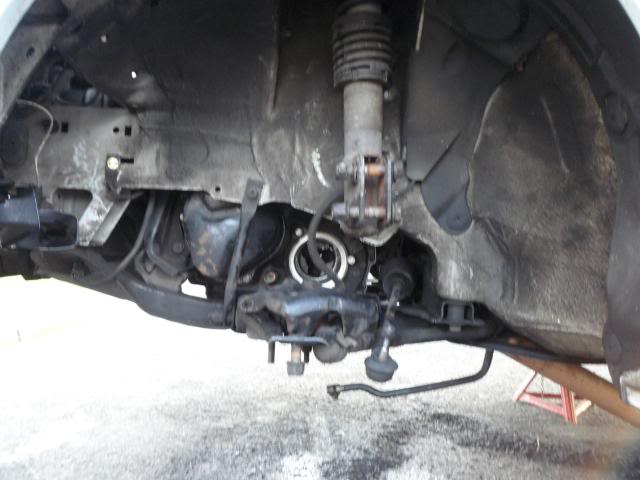

And the front... Excuse the poor picture, only one I can find

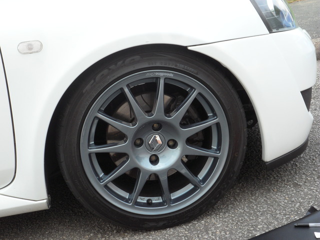

It still has half the threads left but you would never be able to use them

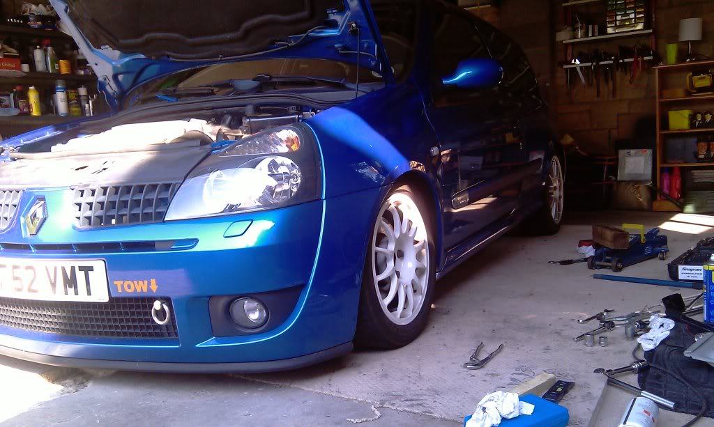

And this is how it sits currently, the same on the front, but rear adjusters back in at the lowest setting

Most (if not all) coilovers that fit a Clio can go so low on the front that the arch liner will sit on the tyre before you get to the bottom threads.
For the rears, if you want it low, just fit the spring without the adjuster.

It's worth noting that the height pictured was after I'd wound the unit down a fair old way as a starting point with loads of threads left, fitted it and then realised it was rediculous and then wound it up a fair way.
