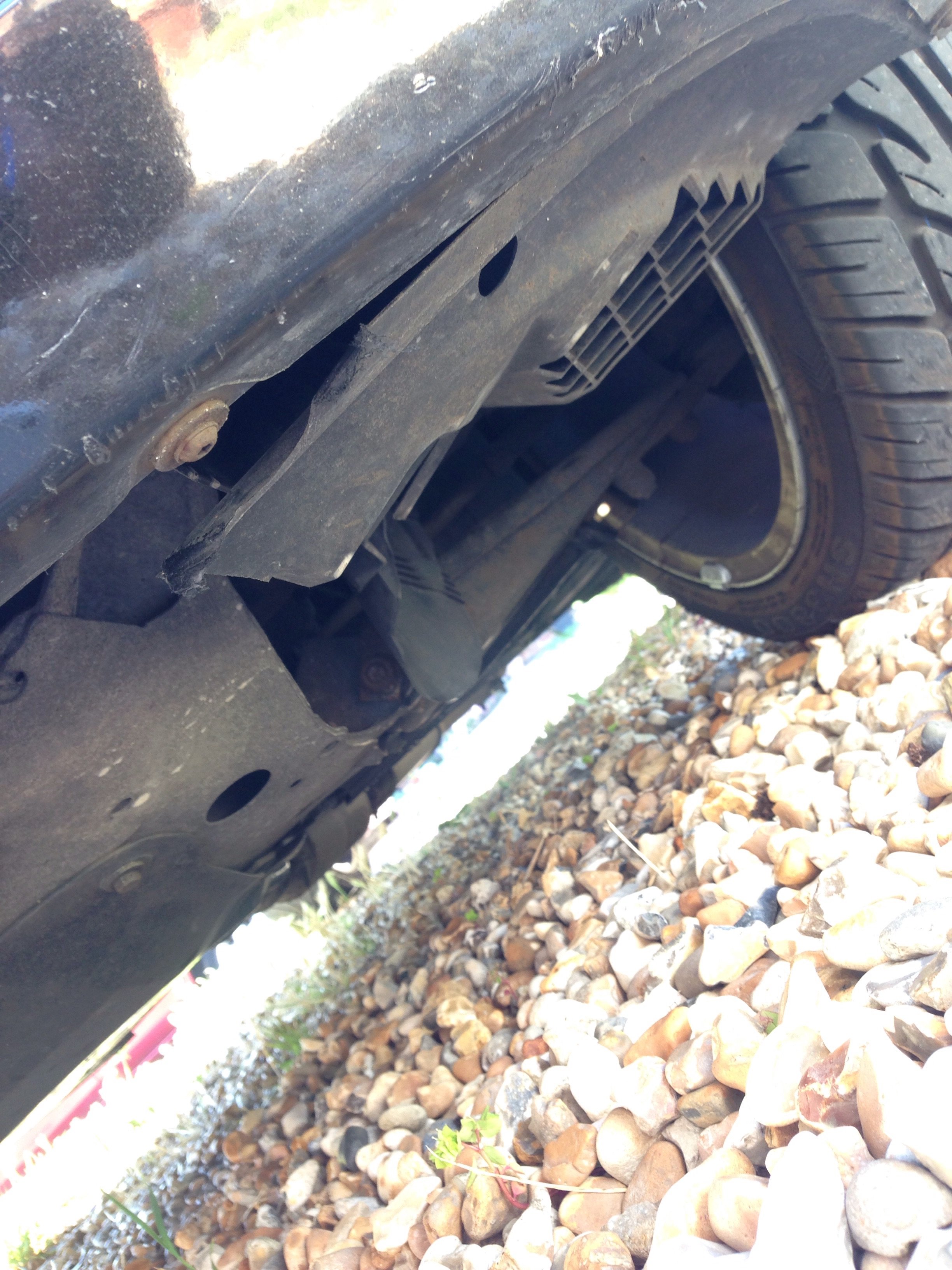

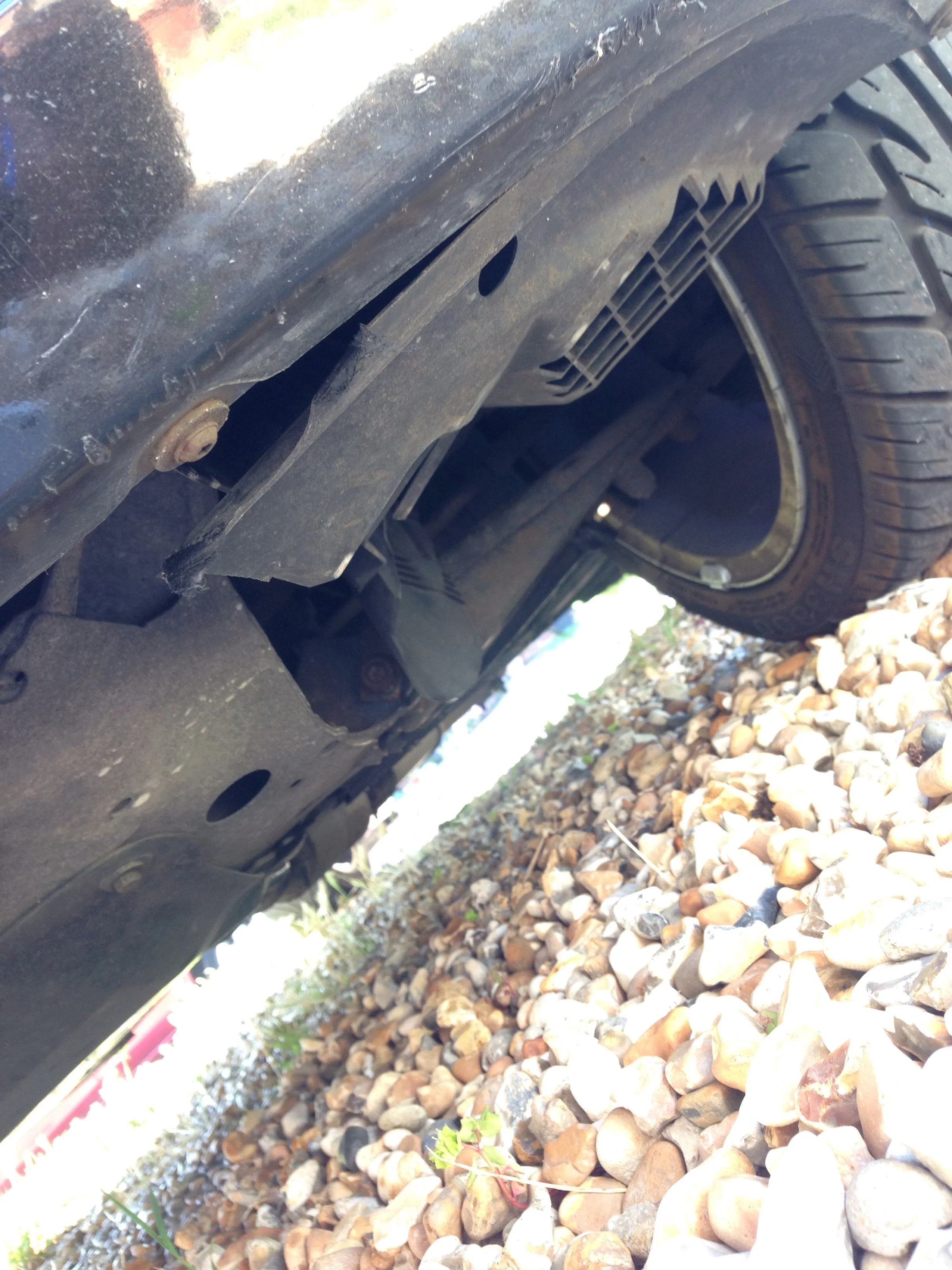

My underside engine plate (I think that's what it's called) is loose and dragging on the road while driving.
I'm not sure how these are supposed to fit in place, perhaps a bolt or two is missing.
Could anyone advise if this has happened to them and / or how to repair?
Thanks much!
Thats the lower arch liner, or splash guard I think its also known as, there is like a metal clip thats folded onto the plastic then a star screw goes through it.
Looks like the screw it in place, possibly the clip is still on the screw and has ripped off. have a feel on the lip.

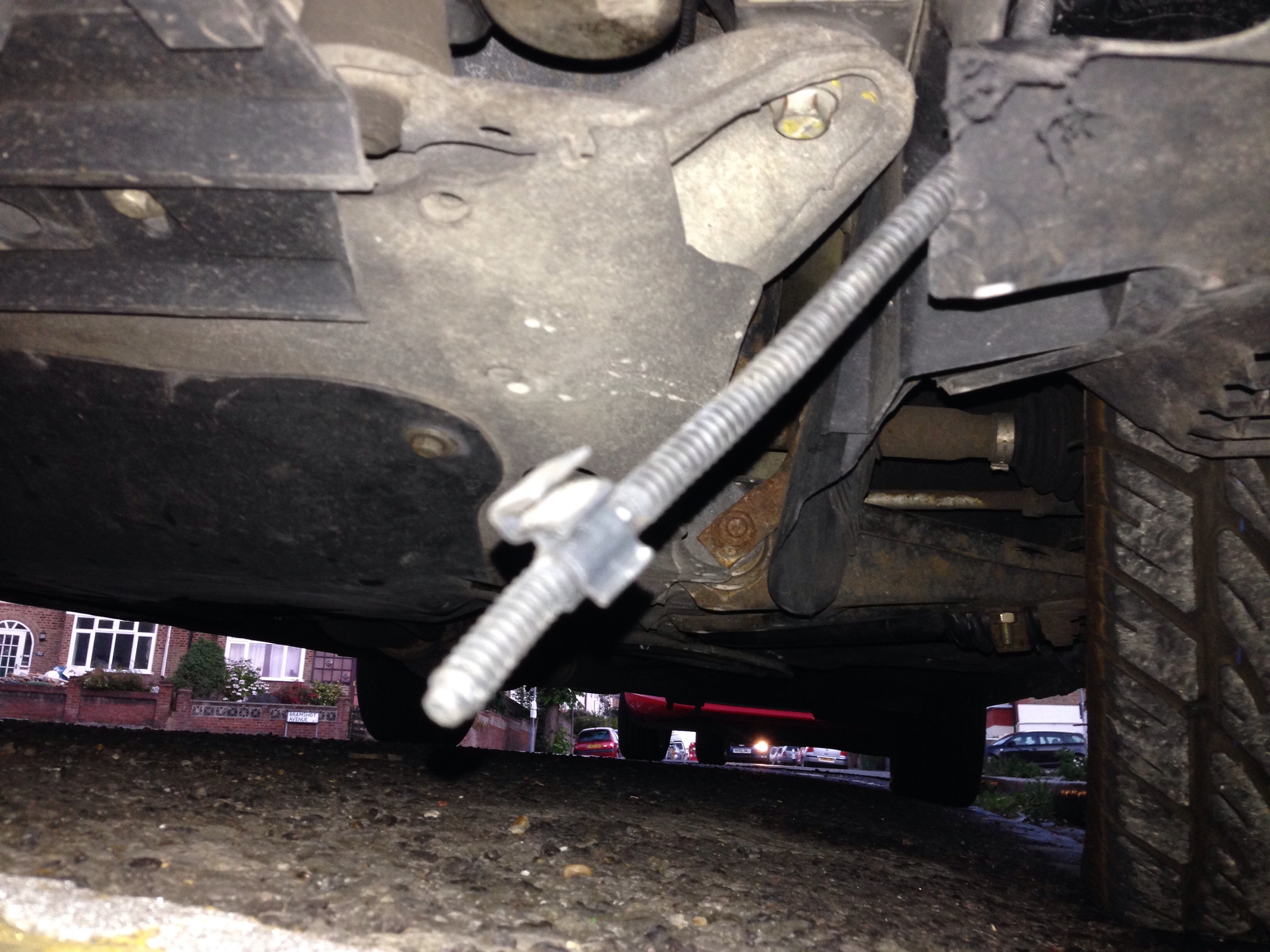

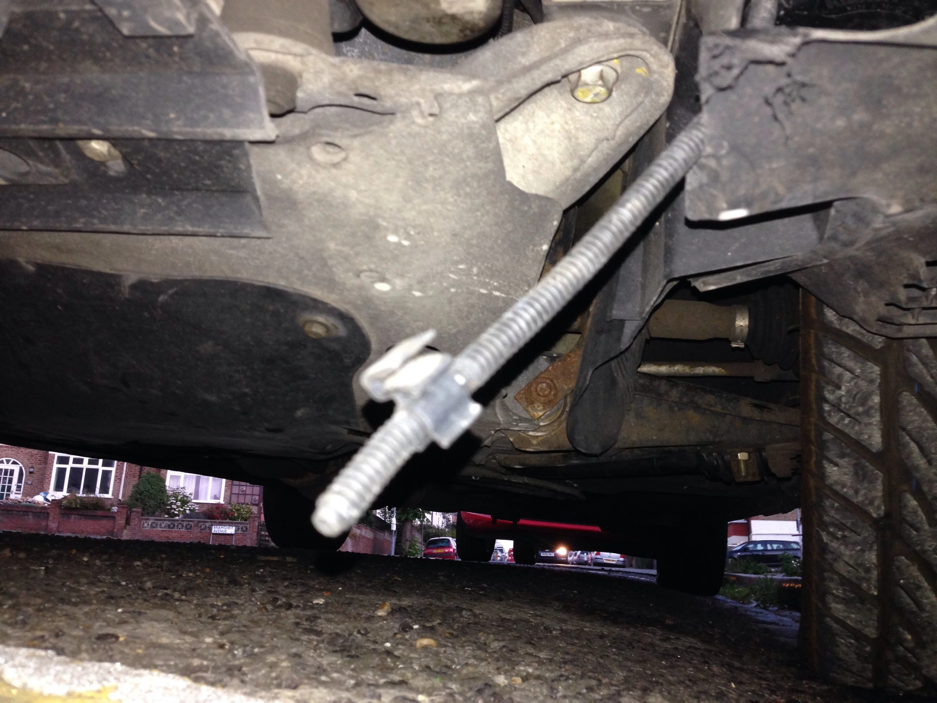

There's a black plastic cable-tie looking thing that's also hanging loose..
Not really sure what it is but based on your description I wonder if this is the tie/clip to hold it in place..
Photo attached
Thats the battery breather pipe, its just there incase the battery has to vent anything. just tuck it away up behind the arch liner, cable tie it if necessary.

Have removed the torn inner wheel arch, and I see some cables and parts behind the cover.
It was too torn/ broken to re-fit with new clips.
It obviously had a purpose; to protect these parts, but what do you guys think about leaving this off permanently? Is the cover protecting these parts from stones / dirt etc significantly?
Should I get a replacement part to fit here?
I'm not entirely sure what the cables and exposed parts are that sit behind this cover and therefore not sure of their impact should something happen..
Thanks for your insight!
I ripped one of mine after a little spin across a curb at Castle Combe. Haven't noticed it is missing really. Apart from the reduced weight of not having it........
It may also be attahced using a little square "c" shapepd thing on the bumper which a screw goes through to hold it to the bumper. Same as the wheel arch lining. Could possible go pick some up from a scrappy
@Amos91 thanks for the reply, all good now - just removed the whole thing, it was pretty badly cracked / torn so it would have been more work to try and secure the thing!
