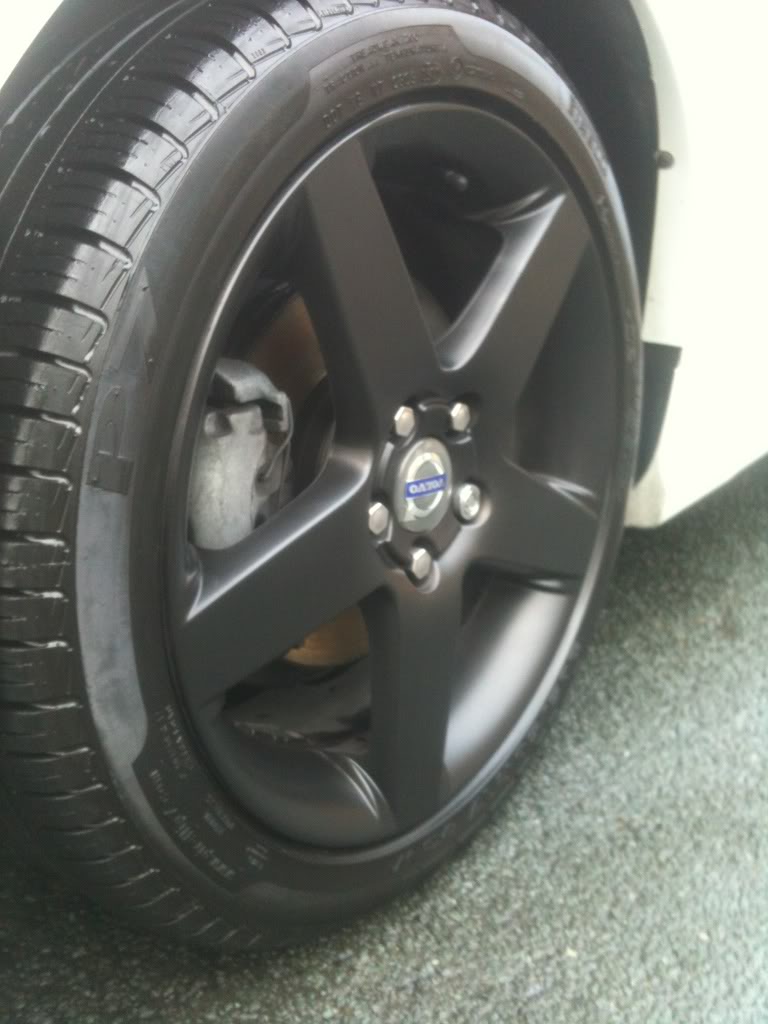

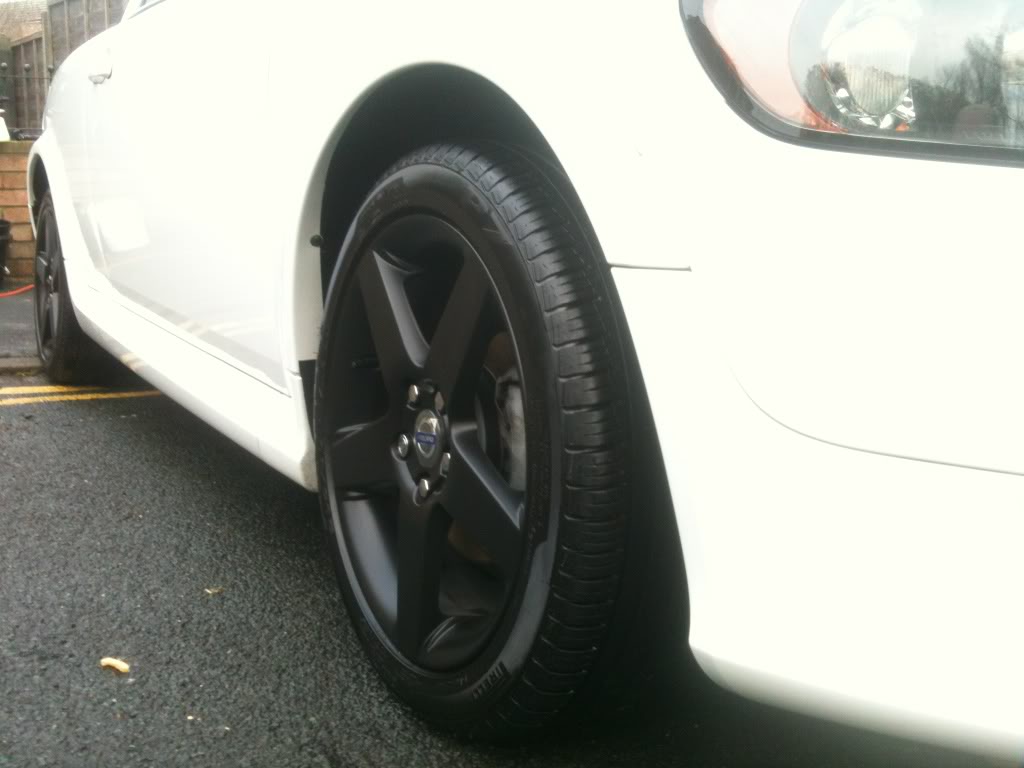

Tempted to do this to the Panzer's wheels for Silverstone Classics this year. Presume it's just like spray painting, i.e. I could make up some stencils and spray paint anything I wanted?

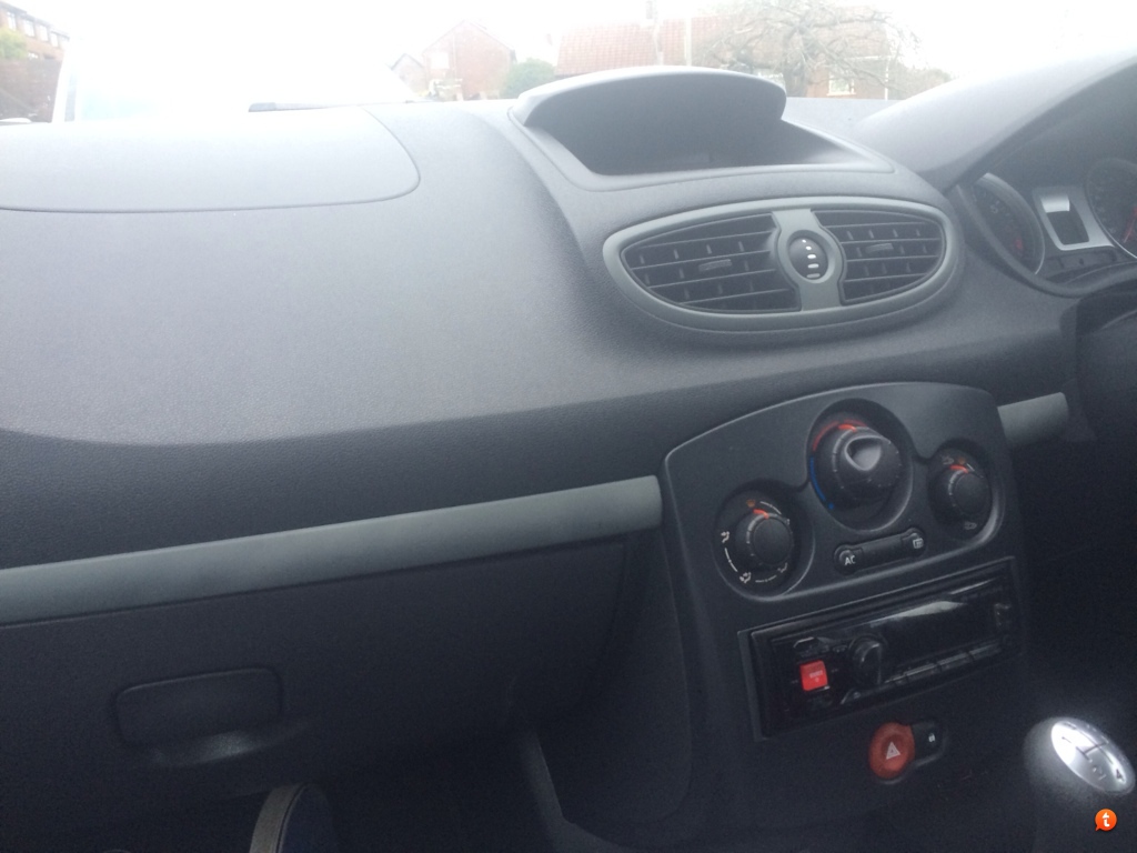

I used plasti dip for the first time on last week,done my interior with the gun metal plasti dip. Very easy to use and I will be buying more for my wheels.

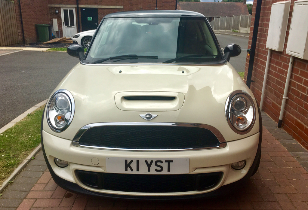

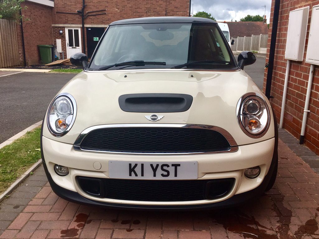

So I was doing some gardening on the weekend and came across a few unopened cans of plastidip knocking about in the shed which I'd forgotten about.
The missus has been toying with the idea of changing some parts on her MCS to gloss black so I thought I'd give this a go first as it's free and quick.
I only did the intake on the weekend as you'll see below but thinking about doing all the chrome parts to match and maybe the boot grab handle too. I don't want to go too far and end up with it looking like a chav waggon but I think it will tie in nicely with the black roof, wing mirrors and alloys that she already has.
What do you guys reckon?
Before and after:

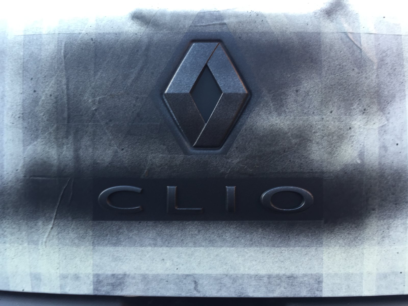

I've used it for badges and bits of exterior trim. Piece of p*ss to use, look really good and last very well. I did my lower front lip on the car in my profile pic (prime stone chip area and I think after 18 months and about 25k miles there was 2 maybe 3 little chips out of it. Then you can just pull it off and do it again.
Dom_capper
  2012 Renault Clio

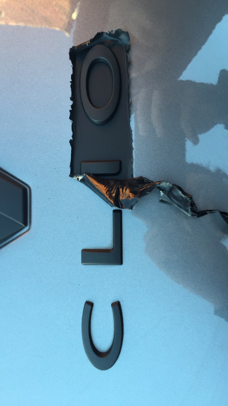

How are you getting it to peel off the body but not the lettering? do you have to cut around it when dry or something?
Tis the magic of plastidip, if you take your time and do 4-5 decent coats then it will just cut itself around and slightly sharp edges. i.e. badges. Just roughly mask, spray, peel it where you don't want it. It's great stuff for £13 a can.
