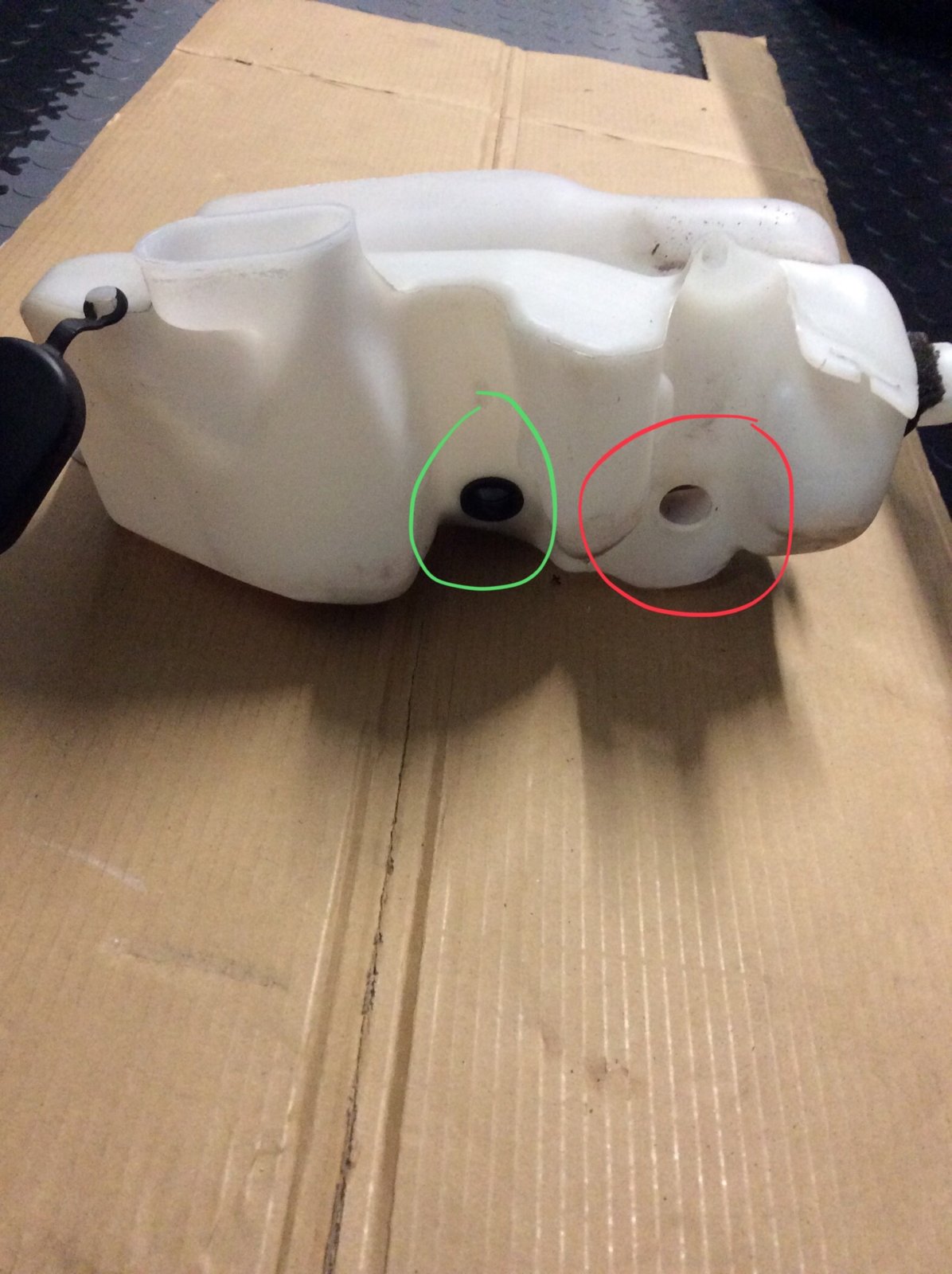

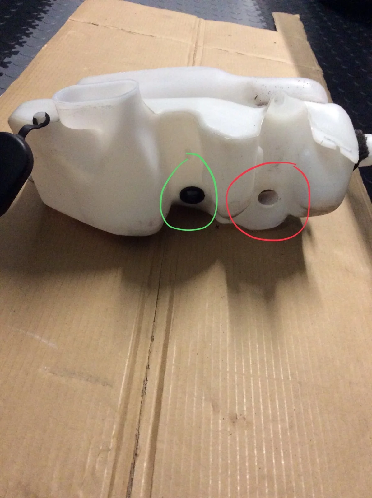

This is the water bottle pump that goes into green circle hole connection is dead
Red circle hole sprays front washer passenger side

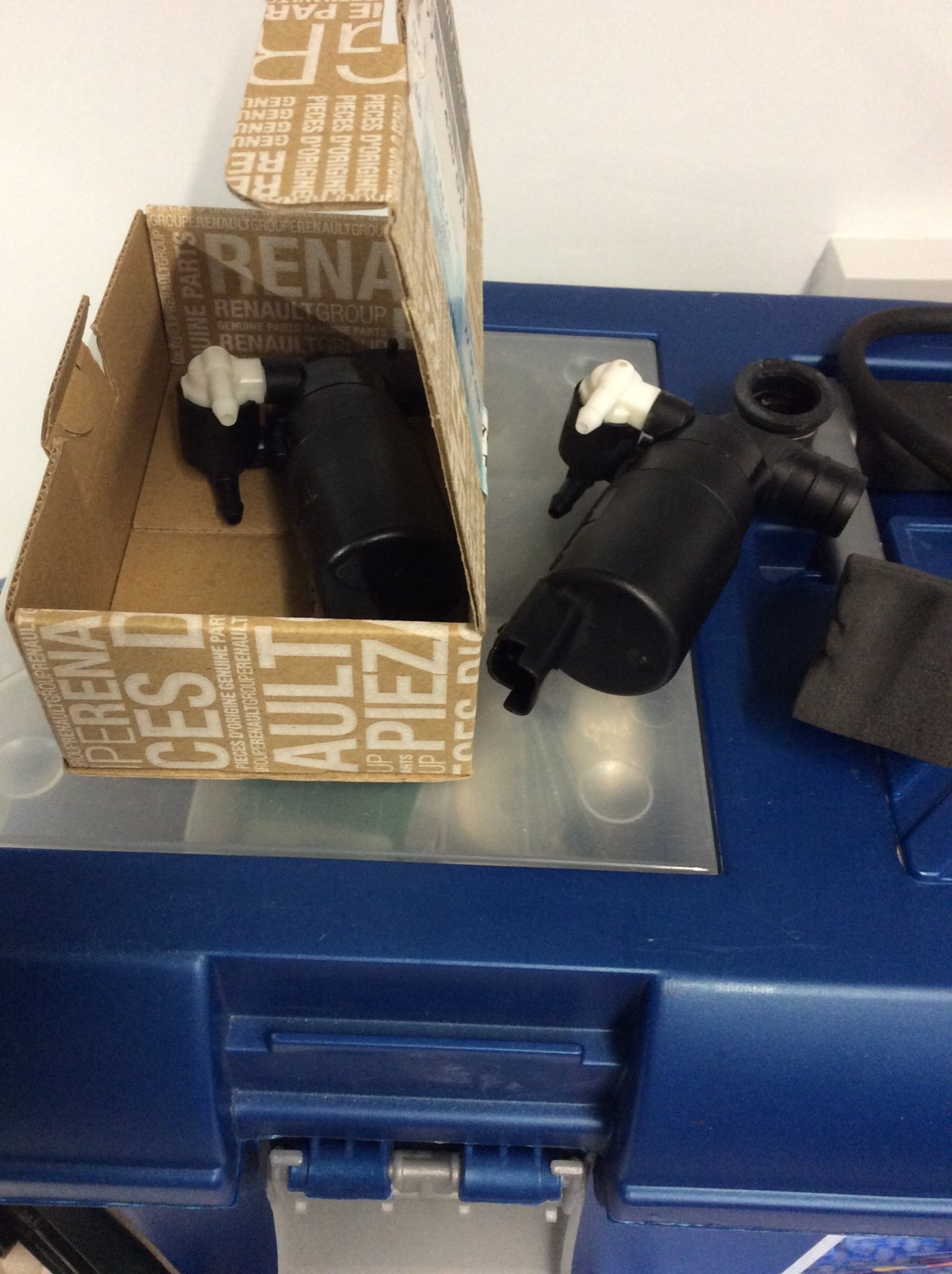

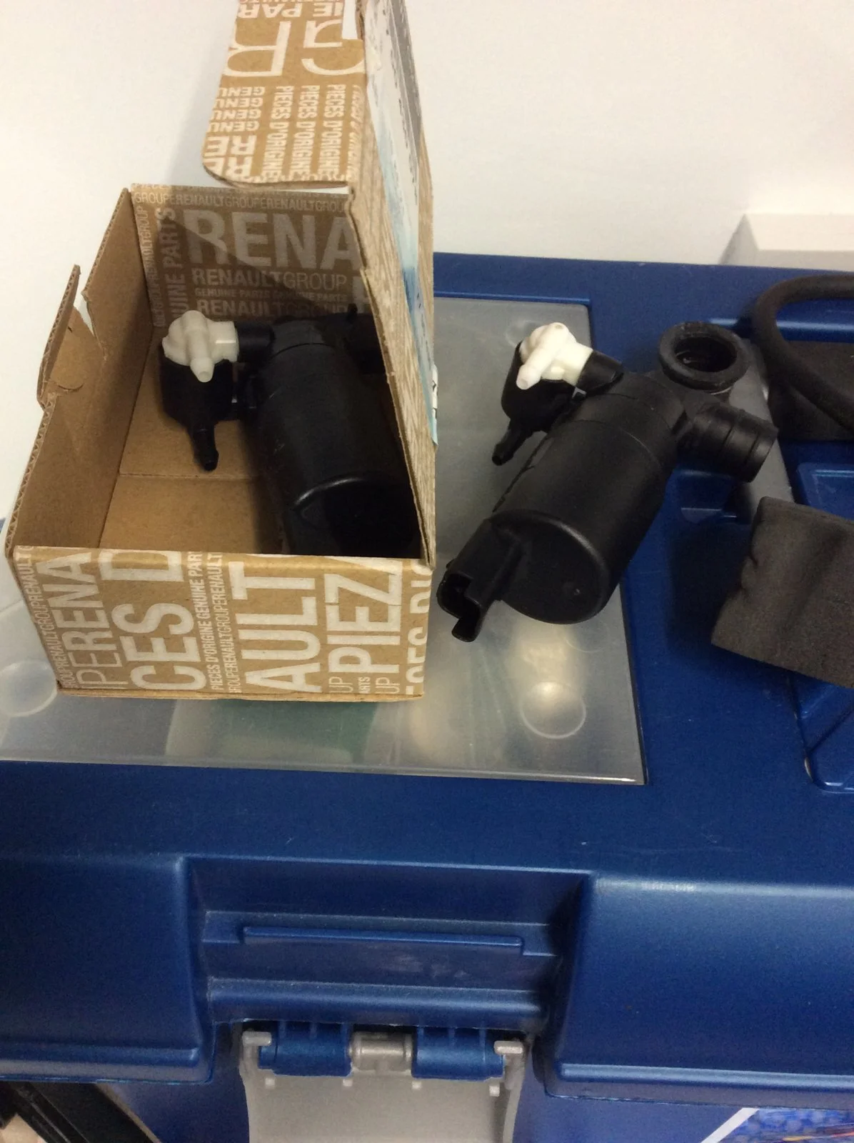

Both pumpers have two outlets but only the black sprays one is brand new
