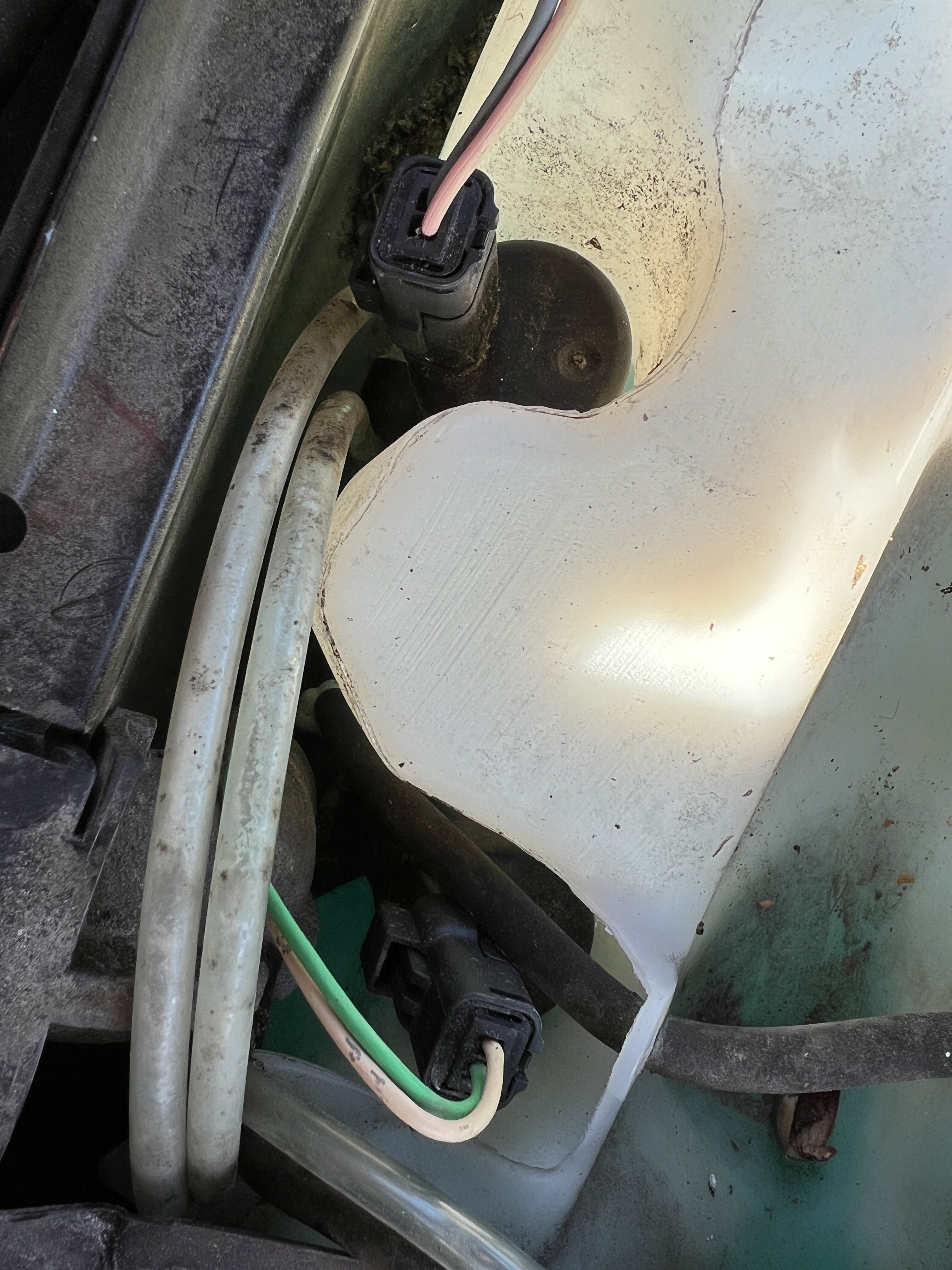

My washer pump (s) are running but no fluid so I figured I need to change both but right now I just need to pass the MOT for the front and rear windows one.
I just realised I have two pumps and also they seem to be side mounted into the fluid container and not the ones that you can just drag up. Lucky me, always get the trickier versions. How do I even dismount and mount these in without having to lift the entire fluid container out and which one is for the headlights only?
Such a pain in the ….
Have you tried disconnecting the hoses to check they're not blocked first?
Yeah I did check and went and blew and felt air coming through. But it seems like I have to remove the whole fluid container to switch the pumps on this car?
