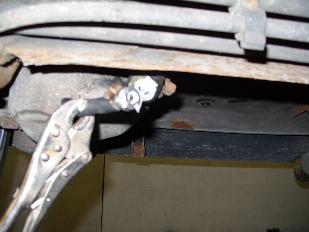

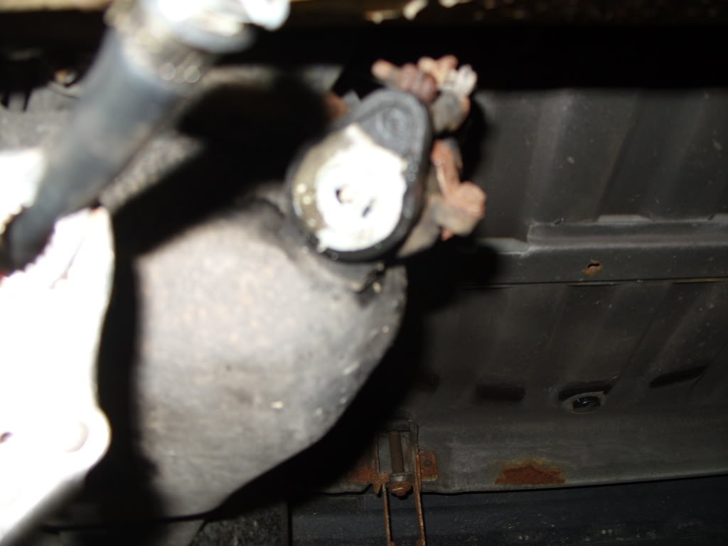

Right i've had a proper look at the tank and it would appear that a part has snapped. I believe it to be some sort of thing.... :)o)
Anyway, its a white plastic thing and its sheared off. Its situated just behind of the o/s/r wheel if you look at the car side on.
It looks like a pipe thats attatched to the tank.
The pipe itself is pissing out fuel (hence the mole grips clamping it) but the white plastic part is not leaking anything.
Heres a pic or 2....

Does the hose connect to anythings else in the vicinity ?
Could it be a plastic male male hose joiner thats broke with getting brittle over time ?

It 'seems' to come out of the tank and back into the tank, hence why I think the fuel only comes out of the pipe and not out of the white plastic socket.

limited to what i can see as the cars on the floor, and not 100% on what i'm looking at in your picture, but I dont appear to have any of the parts you have

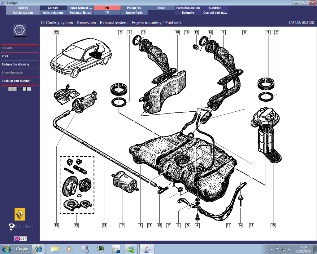

Right....
TOp of the pic in the middle, there is a smaller tank. On the bottom of that little pic of the smaller tank, there is something that bolts into the tank but I can't find out what it is or what its called! I need it! Mines snapped in half!

Jord has just messaged me saying he thinks its the return for the overflow?
DO I need this? (He's not online anymore so I can't ask him)

that diagram is crap. how did it snap just black it up and see what happens? it wont be anything to bad does it still run with that clamped up?
  A ANIMAL
"during the war" before garage pumps clicked off, the overflow tank would store any over filled petrol and feed main tank as fuel was burnt. Most old cars will have a pipe/tank for overflow. Although ii'm sure you're aware of this.
if you under it should connect to the smaller tank - (only had a 2L capacity or something) just block it off mate, wont cause any problems

This is a deffinate yeah?
I can block the rubber pipe off, but What do I do about the plastic bit thats stuck in the tank??
