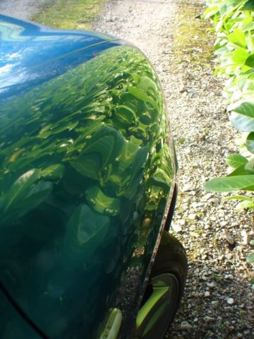

Damp microfibre applicator, spread thinly as possible, apply a panel, apply another, remove first, apply another, remove second etc. Wait 1 hr and go around again. No gassing issues from Nattys. I'll see if I can dig some old photos out from my blue 1.2.
