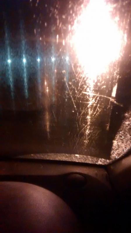

I don't know what the previous owners have done but my windscreen is full of tiny scratches
Is there anyway to remove these scratches at all?

My rear window has a lot of tiny scratches; i am guessing the previous owner used a brillo pad to clean it. I have tried using an aggressive cutting polish with a DAS 6 and there's little improvement.

cerium oxide m8 is what you need
Cerium oxided doesn't work . I've tried the fine paste and coarse paste . It made no difference whatsoever .
To the OP , if the scratches are that bad that they bother you try and blag a new windscreen .
hi i got a local mate in bodyshop by me do it with cerium powder and a certain buffing pad and it worked took a very long time though
I spent a couple of hours on a scratch using a polishing pad , and both the fine and coarse cerium oxide . That was on a scratch that wasn't deep , but more wide caused by the windscreen wiper . We use 10mm plate glass at work , and years ago we used to use Jewellers rouge ( Iron Oxide ) but that would literally take hours and in the end it was economical to spend so much time polishing so now we just break the glass up . The the OP wants to try , by all means try , but I think he'll find it makes little to no difference on those scratches .
Agree yes took hours and hours but cost nothing as it was a favour,but yes that looks bad scratches,id wait till it gets a crack and get a new screen
