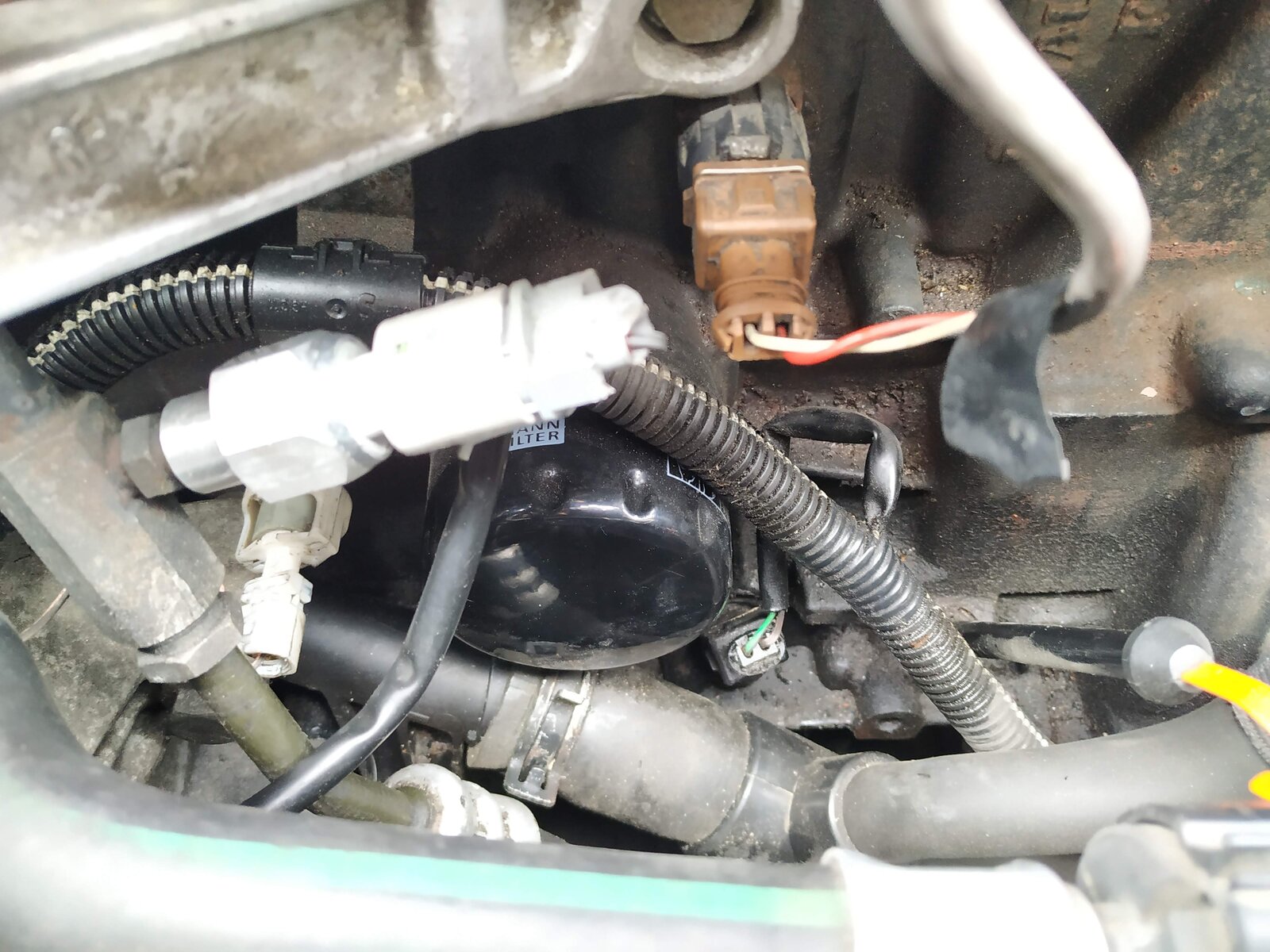

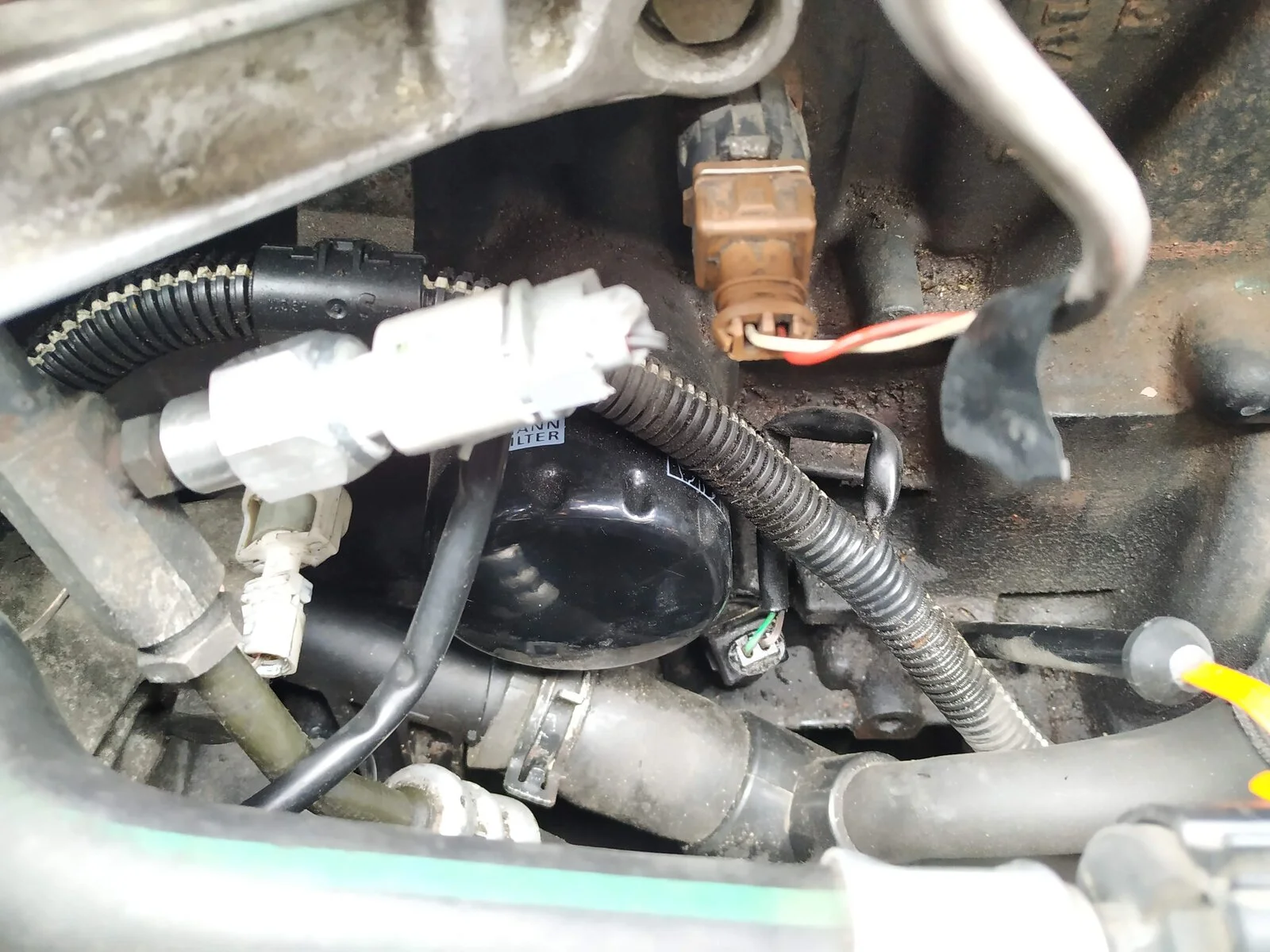

1. Disconnected two sensors on the front of the engine see photo ..... I assume the one top right (red/white leads) is the knock sensor with very awkward cable connector and the other left of oil filter with only one lead is ???? and I did not touch the one below the oil filter that I assume is an oil level sensor
results in no change to EML warning (misfire on cylinder 1) and engine always running well

Back on it again this weekend ...... so ...
